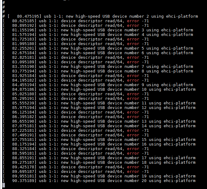

有一个u盘, s3c2416和电脑都可以读写, 但是用V3s不能读写
[   80.475195] usb 1-1: new high-speed USB device number 2 using ehci-platform
[   80.625185] usb 1-1: device descriptor read/64, error -71
[   80.895192] usb 1-1: device descriptor read/64, error -71
[   81.155196] usb 1-1: new high-speed USB device number 3 using ehci-platform
[   81.575194] usb 1-1: new high-speed USB device number 4 using ehci-platform
[   81.725183] usb 1-1: device descriptor read/64, error -71
[   81.995180] usb 1-1: device descriptor read/64, error -71
[   82.255201] usb 1-1: new high-speed USB device number 5 using ehci-platform
[   82.675184] usb 1-1: new high-speed USB device number 6 using ehci-platform
[   82.825181] usb 1-1: device descriptor read/64, error -71
[   83.095189] usb 1-1: device descriptor read/64, error -71
[   83.355190] usb 1-1: new high-speed USB device number 7 using ehci-platform
[   83.775194] usb 1-1: new high-speed USB device number 8 using ehci-platform
[   83.925184] usb 1-1: device descriptor read/64, error -71
[   84.195182] usb 1-1: device descriptor read/64, error -71
[   84.455194] usb 1-1: new high-speed USB device number 9 using ehci-platform
[   84.875186] usb 1-1: new high-speed USB device number 10 using ehci-platform
[   85.025180] usb 1-1: device descriptor read/64, error -71
[   85.295191] usb 1-1: device descriptor read/64, error -71
[   85.555239] usb 1-1: new high-speed USB device number 11 using ehci-platform
[   85.975194] usb 1-1: new high-speed USB device number 12 using ehci-platform
[   86.125184] usb 1-1: device descriptor read/64, error -71
[   86.395182] usb 1-1: device descriptor read/64, error -71
[   86.655190] usb 1-1: new high-speed USB device number 13 using ehci-platform
[   87.075181] usb 1-1: new high-speed USB device number 14 using ehci-platform
[   87.225181] usb 1-1: device descriptor read/64, error -71
[   87.495191] usb 1-1: device descriptor read/64, error -71
[   87.755181] usb 1-1: new high-speed USB device number 15 using ehci-platform
[   88.175194] usb 1-1: new high-speed USB device number 16 using ehci-platform
[   88.325184] usb 1-1: device descriptor read/64, error -71
[   88.595181] usb 1-1: device descriptor read/64, error -71
[   88.855191] usb 1-1: new high-speed USB device number 17 using ehci-platform
[   89.275187] usb 1-1: new high-speed USB device number 18 using ehci-platform
[   89.425178] usb 1-1: device descriptor read/64, error -71
[   89.695187] usb 1-1: device descriptor read/64, error -71
[   89.955181] usb 1-1: new high-speed USB device number 19 using ehci-platform
[   90.375189] usb 1-1: new high-speed USB device number 20 using ehci-platform
[   90.525182] usb 1-1: device descriptor read/64, error -71
[   90.795178] usb 1-1: device descriptor read/64, error -71
[   91.055193] usb 1-1: new high-speed USB device number 21 using ehci-platform
[   91.475188] usb 1-1: new high-speed USB device number 22 using ehci-platform
[   91.625182] usb 1-1: device descriptor read/64, error -71
[   91.895191] usb 1-1: device descriptor read/64, error -71
[   92.155179] usb 1-1: new high-speed USB device number 23 using ehci-platform
[   92.575191] usb 1-1: new high-speed USB device number 24 using ehci-platform
[   92.725186] usb 1-1: device descriptor read/64, error -71
[   92.995181] usb 1-1: device descriptor read/64, error -71
[   93.255190] usb 1-1: new high-speed USB device number 25 using ehci-platform
[   93.675185] usb 1-1: new high-speed USB device number 26 using ehci-platform
[   93.825181] usb 1-1: device descriptor read/64, error -71
[   94.095188] usb 1-1: device descriptor read/64, error -71
有一个u盘, s3c2416和电脑都可以读写, 但是用V3s出现这个提示,
格过了, 还是不行
供电应该没有问题,
另一个U盘正常。
有没有办法解决?
楼主 #2 2018-03-06 16:24:44
F1F2
注册时间: 2017-09-11
已发帖子: 99
积分: 99
Re: 有一个u盘, s3c2416和电脑都可以读写, 但是用V3s不能读写
按这个做法,然而并没有什么卵用。
http://blog.csdn.net/kenny_wju/article/details/9091395
楼主 #3 2018-03-06 16:40:37
F1F2
注册时间: 2017-09-11
已发帖子: 99
积分: 99
不过还是有点卵用, 我写N就好了。
echo N > /sys/module/usbcore/parameters/use_both_schemes
echo Y > /sys/module/usbcore/parameters/old_scheme_first
这样之后, 我手里的两个U盘都可以读写了,但是会不会引起别的问题还不知道。

#4 2018-03-06 19:38:43
所在地: 芒果派
已发帖子: 779
积分: 730
像是硬件设计阻抗没匹配好
#5 2018-03-06 19:46:29
所在地: 微信 whycan_cn
已发帖子: 9,252
积分: 9197
mango 说:
像是硬件设计阻抗没匹配好
有这种可能,但是更像软件协议问题,因为设置了usbcore之后楼主的u盘就正常了。

#8 2018-06-13 17:31:35
所在地: 微信 whycan_cn
已发帖子: 9,252
积分: 9197
今天客户带了几个U盘过来,都是挂载不上的,看log是这样的:
[   30.067937] usb 1-1: new high-speed USB device number 2 using ehci-platform
[   30.507913] usb 1-1: device not accepting address 2, error -71
[   30.647920] usb 1-1: new high-speed USB device number 3 using ehci-platform
[   31.087912] usb 1-1: device not accepting address 3, error -71
[   31.088023] usb usb1-port1: unable to enumerate USB device
[   31.557946] usb 2-1: new full-speed USB device number 2 using ohci-platform
[   31.613097] usb 2-1: not running at top speed; connect to a high speed hub
[   31.628262] usb-storage 2-1:1.0: USB Mass Storage device detected
改了一下参数之后终于可以了.
echo 5000000 > /sys/module/usbcore/parameters/initial_descriptor_timeout
参考网址: https://www.spinics.net/lists/linux-usb/msg107411.html
