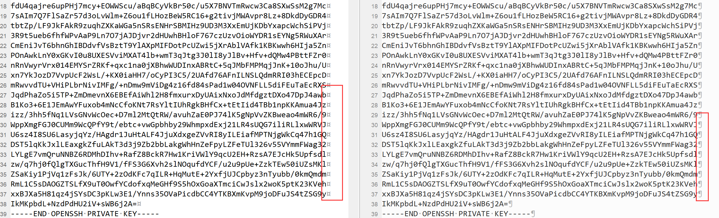

ssh 登录服务器,明明密钥是正确的,确提示 invalid format,终于找到问题了
#ssh 139.224.2xx.xx -p 8822 -l root
Load key "/c/Users/xxx/.ssh/id_rsa.xxx.tunnel.key": invalid format
root@139.224.2xx.xx: Permission denied (publickey,keyboard-interactive).
原来是换行符不同~!
