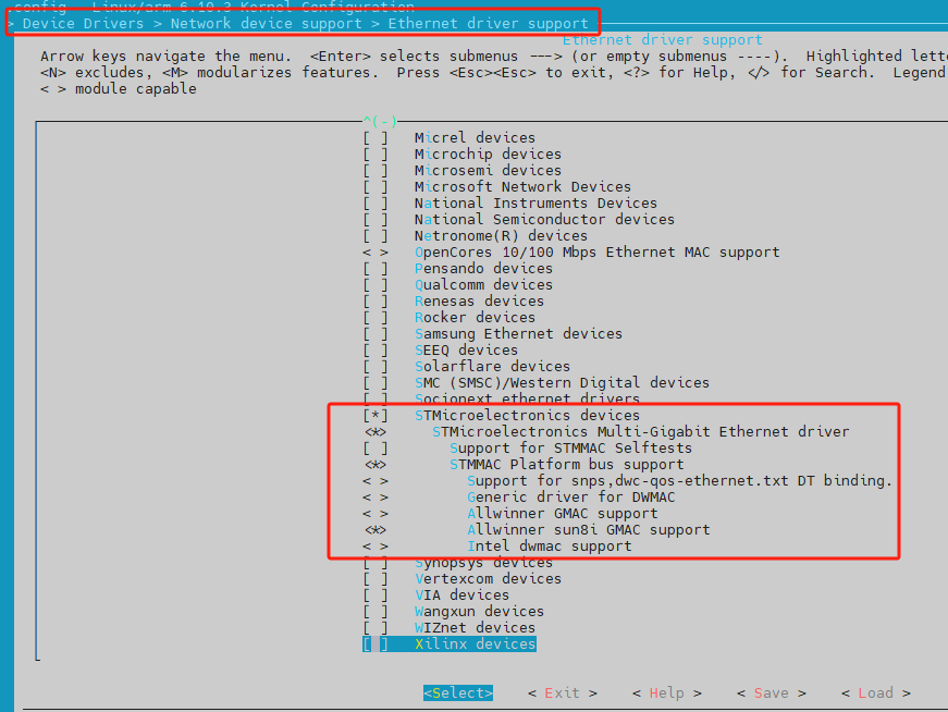

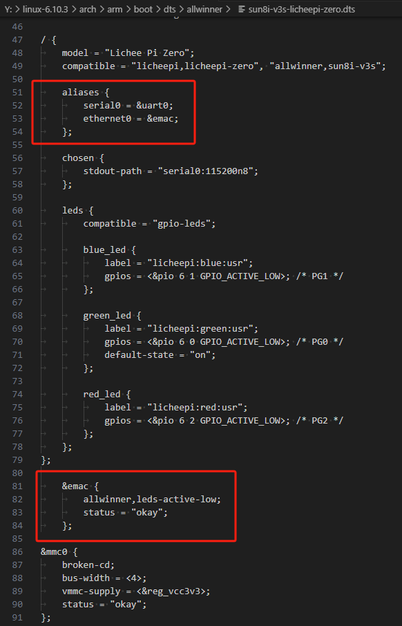

分享: V3S主线Linux 6.10.3有线网口调试记录
截止发帖前,https://www.kernel.org/ Linux最新主线内核为:6.10.3。

[    0.432289] dwmac-sun8i 1c30000.ethernet: IRQ eth_wake_irq not found
[    0.432328] dwmac-sun8i 1c30000.ethernet: IRQ eth_lpi not found
[    0.432340] dwmac-sun8i 1c30000.ethernet: IRQ sfty not found
[    0.432444] dwmac-sun8i 1c30000.ethernet: No regulator found
[    0.432568] dwmac-sun8i 1c30000.ethernet: PTP uses main clock
[    0.433221] dwmac-sun8i 1c30000.ethernet: No HW DMA feature register supported
[    0.433255] dwmac-sun8i 1c30000.ethernet: RX Checksum Offload Engine supported
[    0.433264] dwmac-sun8i 1c30000.ethernet: COE Type 2
[    0.433276] dwmac-sun8i 1c30000.ethernet: TX Checksum insertion supported
[    0.433285] dwmac-sun8i 1c30000.ethernet: Normal descriptors
[    0.433293] dwmac-sun8i 1c30000.ethernet: Chain mode enabled
[    0.435657] dwmac-sun8i 1c30000.ethernet: Found internal PHY node
[    0.436406] dwmac-sun8i 1c30000.ethernet: Switch mux to internal PHY
[    0.436441] dwmac-sun8i 1c30000.ethernet: Powering internal PHY

关于Linux 内核配置:
有线网卡驱动代码已经合入主线了,并不需要对代码进行修改,只需要配置内核即可。
1. Linux 6.10.3中没有“licheepi_zero_defconfig”,需要先从 Linux 5.2.x 中拷贝过来。
2. make ARCH=arm CROSS_COMPILE=arm-linux-gnueabihf- licheepi_zero_defconfig
3. make ARCH=arm CROSS_COMPILE=arm-linux-gnueabihf- menuconfig 做如下修改:

关于Linux 设备树配置:
Linux 6.10.3中存在“sun8i-v3s-licheepi-zero.dts”设备树文件,只需要开启 “emac” 即可。
FluxBB bbcode
编译 & 烧录, 然后就可以愉快的上网了。
