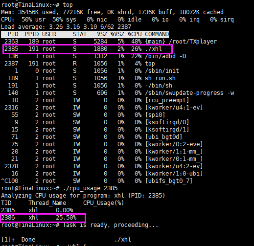

基于全志T113-s3硬件平台,使用condition_variable 条件变量时候调用wait阻塞等待变量释放,但是再等待通知期间,cpu并不会释放,而是一直保持占用状态。难以理解。
以下是测试代码:

以下是执行完代码处理后得结果,主线程休眠装台0占用,worker线程占用cpu再25%:

同样得代码再服务器上跑没啥问题,两个线程得占用都是0,奇奇怪怪得。
t113@t113-docker-1:~/t113/cpu_usage/build$ ./waitT &
[2] 9925
t113@t113-docker-1:~/t113/cpu_usage/build$ ./cpu_usage 9925
Analyzing CPU usage for program: waitT (PID: 9925)
TID	Thread_Name	CPU_Usage(%)
9925	waitT	0.00%
9926	waitT	0.00%
t113@t113-docker-1:~/t113/cpu_usage/build$ Task is ready, proceeding...

更换了交叉编译器,重新编译程序,CPU占用问题依旧没得到解决,目前推测应该是tina linux问题

目前测试,证实确实是tina linux的问题导致的,更换镜像重新烧录后,执行wait线程挂起,cpu消耗为0,测试正常,目前已经修改了SDK重新编译系统(PS:来路不明的野SDK最好不要用,否则掉到坑里很难爬出来)
root@TinaLinux:~# ./xhl &
root@TinaLinux:~# top
Mem: 18828K used, 93844K free, 0K shrd, 1248K buff, 2716K cached
CPU:   0% usr   4% sys   0% nic  95% idle   0% io   0% irq   0% sirq
Load average: 0.00 0.00 0.00 1/55 225
  PID  PPID USER     STAT   VSZ %VSZ %CPU COMMAND
  223   150 root     S     1880   2%   0% ./xhl
  143     1 root     S     1312   1%   0% /bin/adbd -D
    1     0 root     S     1056   1%   0% /sbin/init
  150     1 root     S     1056   1%   0% -/bin/sh
  225   150 root     R     1056   1%   0% top
  141     1 root     S      696   1%   0% /sbin/swupdate-progress -w
   55     2 root     SW       0   0%   0% [spi0]
   10     2 root     IW       0   0%   0% [rcu_preempt]
   21     2 root     IW       0   0%   0% [kworker/1:1-ubi]
   53     2 root     IW       0   0%   0% [kworker/u4:1-ev]
    7     2 root     IW       0   0%   0% [kworker/u4:0-ev]
    5     2 root     IW       0   0%   0% [kworker/0:0-mm_]
   15     2 root     SW       0   0%   0% [ksoftirqd/1]
   73     2 root     IW       0   0%   0% [kworker/1:2-ubi]
   20     2 root     IW       0   0%   0% [kworker/0:1-ubi]
    9     2 root     SW       0   0%   0% [ksoftirqd/0]
  103     2 root     SW       0   0%   0% [ubifs_bgt0_7]
   16     2 root     IW       0   0%   0% [kworker/1:0-mm_]
   19     2 root     SW       0   0%   0% [rcu_tasks_kthre]
^C 17     2 root     IW<      0   0%   0% [kworker/1:0H-kb]
root@TinaLinux:~# ./cpu_usage 223
Analyzing CPU usage for program: xhl (PID: 223)
223	xhl	0.00%
224	xhl	0.00%
root@TinaLinux:~# Task is ready, proceeding...

既然怀疑编译器。那它啥版本?哪来的?换过编译器没有?

海石生风 说:
代码验证没有问题,接下来当然就是排查编译器和系统问题咯,就是换过编译器了,才有下面的系统问题排查
