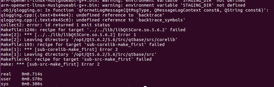

就是在编译的时候报错:
arm-openwrt-linux-muslgnueabi-g++.bin: warning: environment variable 'STAGING_DIR' not defined
.obj/qlogging.o: In function `qFormatLogMessage(QtMsgType, QMessageLogContext const&, QString const&)':
qlogging.cpp:(.text+0x434c): undefined reference to `backtrace'
qlogging.cpp:(.text+0x440c): undefined reference to `backtrace_symbols'
Makefile:1245: recipe for target '../../lib/libQt5Core.so.5.12.9' failed
make[3]: *** [../../lib/libQt5Core.so.5.12.9] Error 1
make[3]: Leaving directory '/home/liefyuan/qt-src/qt-everywhere-src-5.12.9/qtbase/src/corelib'
Makefile:226: recipe for target 'sub-corelib-make_first' failed
make[2]: *** [sub-corelib-make_first] Error 2
make[2]: Leaving directory '/home/liefyuan/qt-src/qt-everywhere-src-5.12.9/qtbase/src'
Makefile:50: recipe for target 'sub-src-make_first' failed
make[1]: *** [sub-src-make_first] Error 2
make[1]: Leaving directory '/home/liefyuan/qt-src/qt-everywhere-src-5.12.9/qtbase'
Makefile:58: recipe for target 'module-qtbase-make_first' failed
make: *** [module-qtbase-make_first] Error 2

#4 2024-01-08 21:28:52
changge
注册时间: 2024-01-08
Re: T113-s3使用Tina SDK编译Qt5.12.9失败

#6 2024-11-21 09:07:13
已发帖子: 1,378
积分: 1343.5
过了快一年了,又编译了一遍qt,基于t113s3的tina2.1sdk。又遇到这些问题。感谢楼主的分享。
autoconfigure.sh脚本里一开始的export STAGING_DIR命令,执行脚本后,貌似没起作用,编译会有警告STAGING_DIR是空的,然后编译会报错,qlogging.cpp:  `backtrace'啥的。在执行脚本前,在命令行里手动执行下export STAGING_DIR=XXX,就不会报这些错误。
在ubuntu22.04下编译qt5.12,还会有些报错,和std:min  std:max相关的,找到报错的文件,加上#include<limits>即可解决。
在ubuntu22.04下编译qt5.15,也有报错,好像是std:某个模板参数不能为空,没找到解决办法,不过看编译过程的提示需要GCC版本大于7,sdk自带的是6.x版本。于是放弃qt5.15转而下载qt5.12。tina5.x的gcc版本有10和11,也许不会报这些错误。
