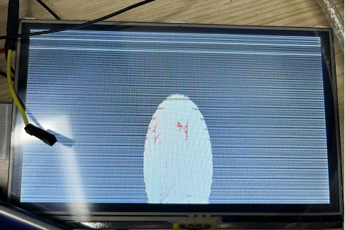

芒果派MangoPi MQ-Dual(T113-S3) 5寸屏幕480*272 错误
芒果派MangoPi MQ-Dual 购买时,无货: 单拍5寸电容屏,800*480,GT911电容触摸  购买:单拍5寸电阻屏旧,480*272分辨率,电阻触摸,外观旧
480*272分辨率 驱动异常问题。
1、屏幕没资料,尝试修改无效。
     480*272分辨率 大部分都是4.3寸, 这个是5寸,疑问?
2、使用buildroot
git clone https://github.com/yuzukihd/Buildroot-YuzukiSBC      # 主站
git clone https://gitee.com/GloomyGhost/Buildroot-YuzukiSBC    # 镜像站
显示异常:uboot
=> disp
screen 0:
de_rate 300000000 hz, ref_fps:45
mgr0: 480x272 fmt[rgb] cs[0x204] range[full] eotf[0x4] bits[8bits] err[1] force_sync[0] unblank direct_show[false] iommu[0]
        lcd output      backlight(100)  fps:87.4         480x 272
        err:0   skip:0  irq:390 vsync:0 vsync_skip:0
   BUF    enable ch[1] lyr[0] z[0] prem[N] a[globl 255] fmt[  0] fb[ 480, 272;   0,   0;   0,   0] crop[   0,   0, 480, 272] frame[   0,   0, 480, 272] addr[448ed000,       0,       0] flags[0x       0] trd[0,0]
3、尝试其它SDK  无法解决。
https://github.com/mangopi-sbc/buildroot-d1x-t113
https://mangopi.cc/d1
https://mangopi.cc/t113dev
原始SDK
链接:https://pan.baidu.com/s/1R3P5lpVzajA8w56fIRnTKA?pwd=1111  使用原始SDK pack 的img 烧录到SD无法使用。
显示异常如图:

显示屏制造商 说:
现在解决了吗?
无解。 更换5寸其它屏幕。 可以了。

// 480x272 RGB LCD
&lcd0 {
    lcd_used            = <1>;
    lcd_driver_name     = "default_lcd";
    lcd_backlight       = <50>;
    lcd_if              = <0>;
    lcd_x               = <480>;
    lcd_y               = <272>;
    lcd_width           = <95>;
    lcd_height          = <54>;
    lcd_dclk_freq       = <9>;
    lcd_pwm_used        = <0>;
    lcd_pwm_ch          = <7>;
    lcd_pwm_freq        = <50000>;
    lcd_pwm_pol         = <1>;
    lcd_hbp             = <43>;
    lcd_ht              = <525>;
    lcd_hspw            = <41>;
    lcd_vbp             = <12>;
    lcd_vt              = <286>;
    lcd_vspw            = <10>;
    lcd_lvds_if         = <0>;
    lcd_lvds_colordepth = <1>;
    lcd_lvds_mode       = <0>;
    lcd_frm             = <0>;
    lcd_io_phase        = <0x0000>;
    lcd_gamma_en        = <0>;
    lcd_bright_curve_en = <0>;
    lcd_cmap_en         = <0>;
    deu_mode            = <0>;
    lcdgamma4iep        = <22>;
    smart_color         = <90>;
    pinctrl-0 = <&rgb18_pins_a>;
    pinctrl-1 = <&rgb18_pins_b>;
