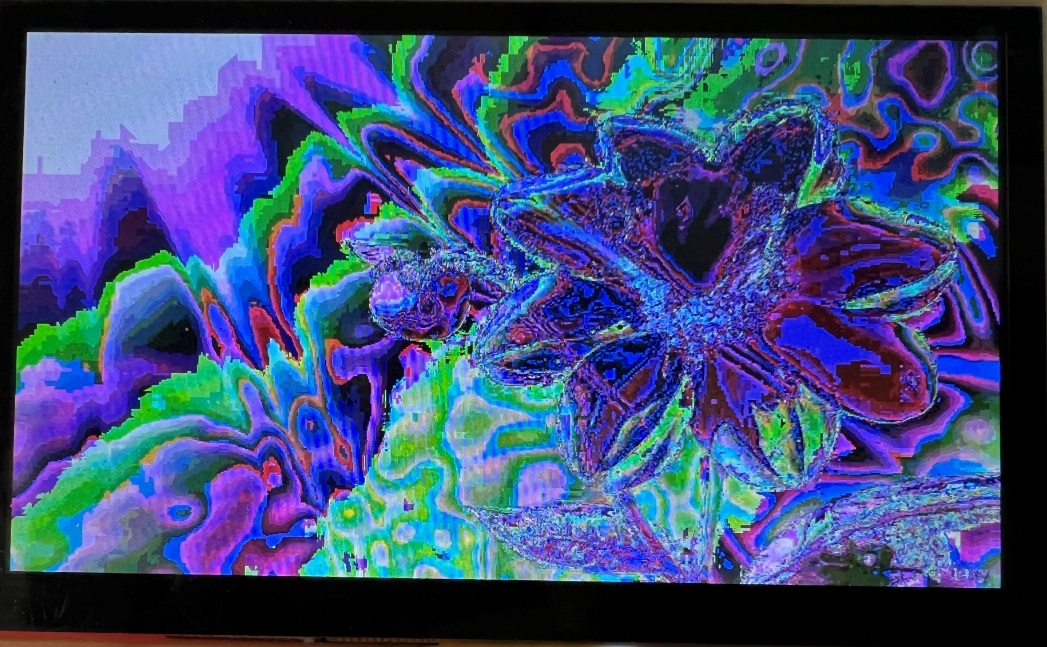

Re: Baremetal hardware JPEG-decoder example (F1C100S)
Small modification of the previous demo.
Converting tile-based data is done by the mb32dec function. Color conversion - hardware by debe-module.
Decoding time 3-4ms. MB32 transformation 8-9mS. As a result: fps = 1 / (0.004 + 0.009) = 76
Sources: mjpgdec_60fps.7z
60fps video playback example:
最近编辑记录 Ozelot (2022-08-20 04:37:01)

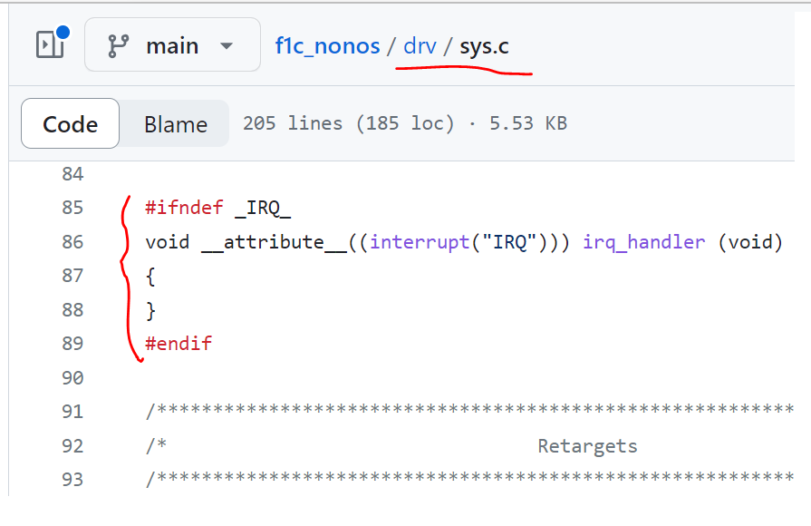

@Ozelot
hi, dear friend, i downloaded baremetal project from your repository.
I set timer0 interrupt enable, but it didn't work.
how to add irq_handler( such as timer, uart, gpio ...) to f1c_nonos-main\src\lvgl\main.c?
void timer_irq_handler(void) {
lv_tick_inc(1);
tim_clear_irq(TIM0);
timer_count ++;
if(timer_count == 1000)//1S
timer_count = 0;
uart_sendbyte(UART1, 0x55);//send 1byte every 1s
void timer_init(void) {
// Configure timer to generate update event every 1ms
tim_init(TIM0, TIM_MODE_CONT, TIM_SRC_HOSC, TIM_PSC_1);
tim_set_period(TIM0, 24000000UL / 1000UL);//1ms
tim_int_enable(TIM0);
// IRQ configuration
intc_set_irq_handler(IRQ_TIMER0, timer_irq_handler);
intc_enable_irq(IRQ_TIMER0);
tim_start(TIM0);
thank you.

@sh200436
See an example of an interrupt handler: https://github.com/minilogic/f1c_nonos/tree/main/src/irq
#45 2023-07-08 10:24:37
sh200436
注册时间: 2023-02-23
已发帖子: 33
Ozelot wrote:
@sh200436
Wonderful!
I found 'IRQ' in /drv/sys.c, but i didn’t know how to deal with it, so new irq example is very wonderful.
Thank you so much!

Ozelot wrote:
Simple example of hardware decoding JPEG image.
Resolution 800x480. Decoding time 3-4ms.
Sources: jpgdec.7z
/files/members/4572/girl.jpg
/files/members/4572/flower.jpg
大佬你好,我移植了你的代码,测试了花,结果如下图,请问可能是什么原因?
花原图如下:
#54 2024-04-12 16:41:42
xiaorui
注册时间: 2022-06-11
积分: 107
看起来是RGB反了,或是大小端反了。
搞个RGB纯色图片来测试下看看。
#55 2024-04-12 18:00:48
dykxjh
注册时间: 2020-03-25
已发帖子: 194
积分: 154
xiaorui wrote:
看起来是RGB反了,或是大小端反了。
搞个RGB纯色图片来测试下看看。
确实是大小端反了
