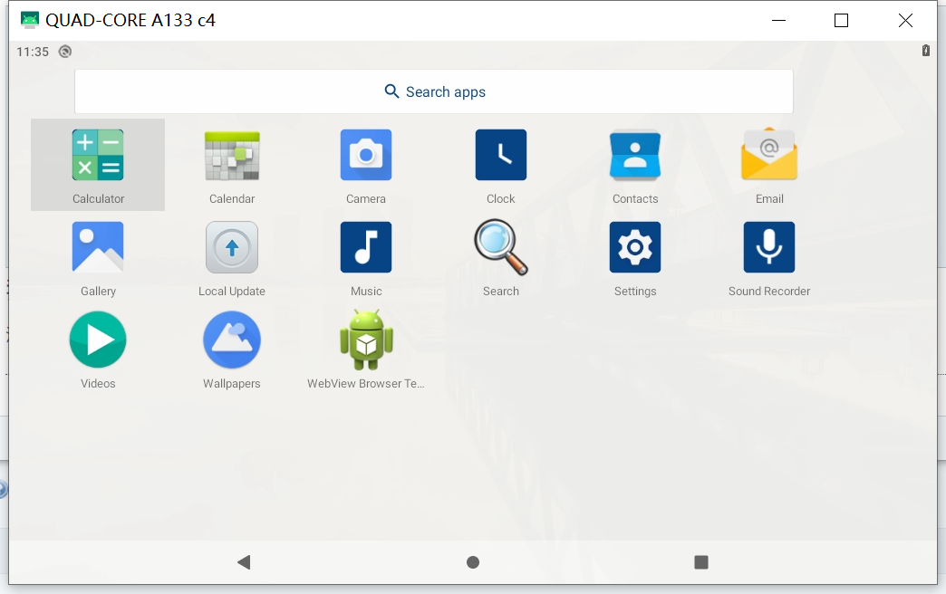

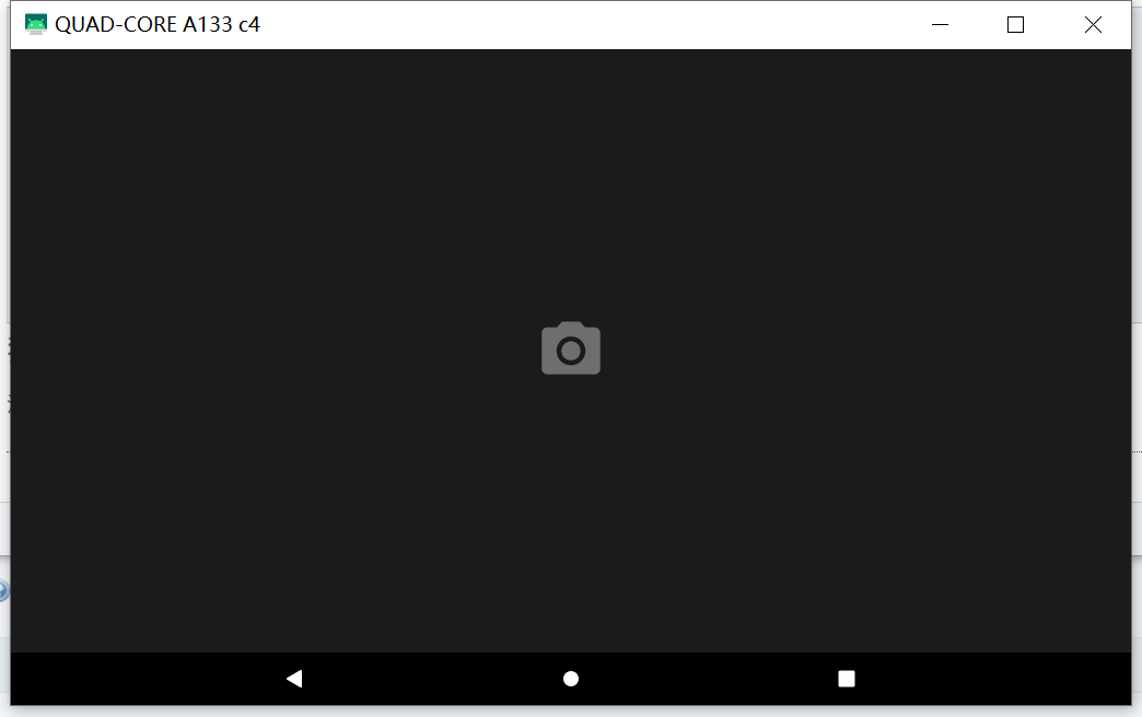

GC05A2 mipi摄像头 预览是黑屏是什么情况
日志:

// adb 测试:
ceres-c3:/ # i2cdetect -y 2
0  1  2  3  4  5  6  7  8  9  a  b  c  d  e  f
00:          -- -- -- -- -- -- -- -- -- 0c -- -- --
10: -- -- -- -- -- -- -- -- -- -- -- -- -- -- -- --
20: -- -- -- -- -- -- -- -- -- -- -- -- -- -- -- --
30: -- -- -- -- -- -- -- UU -- -- -- -- -- -- -- --
40: -- -- -- -- -- -- -- -- -- -- -- -- -- -- -- --
50: -- -- -- -- -- -- -- -- -- -- -- -- -- -- -- --
60: -- -- -- -- -- -- -- -- -- -- -- -- -- -- -- --
70: -- -- -- -- -- -- -- --
ceres-c3:/ # cat /sys/class/regulator/regulator.14/state
enabled
ceres-c3:/ # cat /sys/class/regulator/regulator.14/microvolts
1800000
ceres-c3:/ # cat /sys/class/regulator/regulator.15/state
enabled
ceres-c3:/ # cat /sys/class/regulator/regulator.15/microvolts
2800000
ceres-c3:/ # cat /sys/class/regulator/regulator.18/state
enabled
ceres-c3:/ # cat /sys/class/regulator/regulator.18/microvolts
1500000
ceres-c3:/ # ls /dev/video*
/dev/video0 /dev/video1 /dev/video2 /dev/video3
ceres-c3:/ # dmesg | grep -i v4l2
[    8.390476] [gc05a2_mipi]gc05a2 detect V4L2_IDENT_SENSOR = 0x5a2 (expected 0x5a2)
[   12.287083] [gc05a2_mipi]gc05a2 detect V4L2_IDENT_SENSOR = 0x5a2 (expected 0x5a2)
[   78.212654] [gc05a2_mipi]gc05a2 detect V4L2_IDENT_SENSOR = 0x5a2 (expected 0x5a2)
[   78.494089] [gc05a2_mipi]gc05a2 detect V4L2_IDENT_SENSOR = 0x5a2 (expected 0x5a2)
ceres-c3:/ # dmesg | grep -i csi
[   78.443291] [VIN]csic_dma0 stream on, 1296*972 hoff: 0 voff: 0
[   78.537193] [VIN]csic_dma1 stream on, 640*480 hoff: 0 voff: 0
// 设备树配置如下:(后置摄像头)
