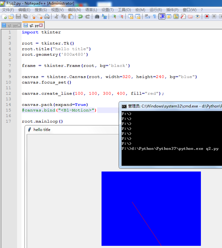

import tkinter
root = tkinter.Tk()
root.title("hello title")
root.geometry('800x480')
frame = tkinter.Frame(root, bg='black')
canvas = tkinter.Canvas(root, width=320, height=240, bg="blue")
canvas.focus_set()
canvas.create_line(100, 100, 300, 400, fill="red");
canvas.pack(expand=True)
#canvas.bind("<B1-Motion>")
root.mainloop()

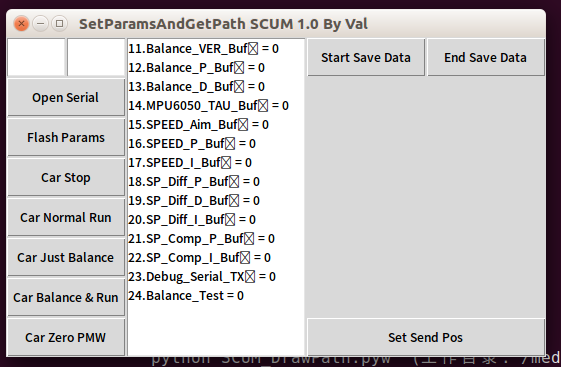

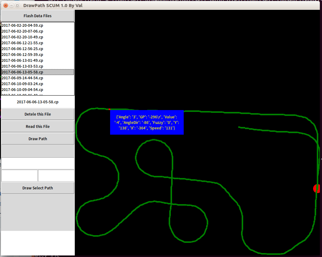

当年参加飞思卡尔做的摄像头平衡组 用pytkiner写的上位机 利用编码器+IMU融合获取车的轨迹进行调试

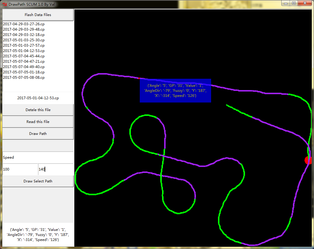

试了一下 还能打开 看到轨迹有点漂移
有漂移是正常,因为没有用电子罗盘修正航偏角,但是图上这么大的漂移其实是我的IMU融合搞得不好,我的师弟把我的融合改成四元素之后,漂移用这个上位机是看不出来的

Jin劲 说:
https://whycan.cn/files/members/719/2019-02-12-17-04-17.png
https://whycan.cn/files/members/719/2019-02-12-17-05-37.png
试了一下 还能打开 看到轨迹有点漂移
好厉害,
这是 GUI是 tkinter 组建做的?

就是python内置的tkinter

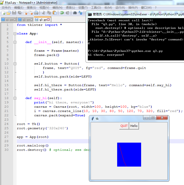

from tkinter import *
class App:
	def __init__(self, master):
		frame = Frame(master)
		frame.pack()
		self.button = Button(
			frame, text="QUIT", fg="red", command=frame.quit
		self.button.pack(side=LEFT)
		self.hi_there = Button(frame, text="Hello", command=self.say_hi)
		self.hi_there.pack(side=LEFT)
	def say_hi(self):
		print("hi there, everyone!")
		canvas = Canvas(root, width=100, height=100, bg="blue")
		i = canvas.create_line(10, 10, 30, 80, 50, 120, 70, 320, fill="red");
root = Tk()
root.geometry('320x240')
app = App(root)
root.mainloop()
root.destroy() # optional; see description below
按下按钮,触发绘图.
http://effbot.org/tkinterbook/tkinter-hello-again.htm
