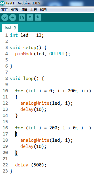

改为呼吸灯:
int led = 13;
void setup() {
  pinMode(led, OUTPUT);
void loop() {
  for (int i = 0; i < 200; i++){
    analogWrite(led, i);
    delay(10);
  for (int i = 200; i > 0; i--){
    delay(10);
  delay (500);
效果还挺不错。
