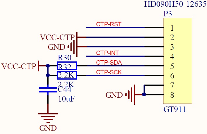

请教一下关于lichee nano在官网上电容屏的适配
底板  电容屏也是官网的  gt911
大概步骤就是在dtsi中(soc,pio节点)加节点   然后在dts中引用  http://nano.lichee.pro/build_sys/devicetree.html#id5

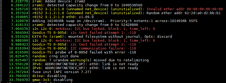

内核中已经勾选Gooddix I2C touchscreen ,启动log会报如下信息:
[    0.663532] i2c /dev entries driver
[    2.881100] i2c i2c-0: mv64xxx: I2C bus locked, block: 1, time_left: 0
[    2.887655] Goodix-TS 0-0014: i2c test failed attempt 1: -110
[    5.041092] i2c i2c-0: mv64xxx: I2C bus locked, block: 1, time_left: 0
[    5.047634] Goodix-TS 0-0014: i2c test failed attempt 2: -110
[    5.091084] Goodix-TS 0-0014: I2C communication failure: -110
[    5.096951] Goodix-TS: probe of 0-0014 failed with error -110
i2cdetect -l 命令输出如下:
i2c-0   i2c             mv64xxx_i2c adapter                     I2C adapter
i2cdetect -r -y 0 输出如下:
# i2cdetect -r -y 0
     0  1  2  3  4  5  6  7  8  9  a  b  c  d  e  f
00:          [ 1116.081094] i2c i2c-0: mv64xxx: I2C bus locked, block: 1, time_left: 0
-- [ 1118.161097] i2c i2c-0: mv64xxx: I2C bus locked, block: 1, time_left: 0
i2cset 也是会报I2C bus locked。

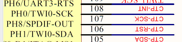

看原理图底板应该是有上拉的
不知道有没有人遇到过同样的情况,是我dts改错了吗?
照这个情况是不是cpu根本就没发出i2c信号?
还是如果根本就没接上也会有这种情况?

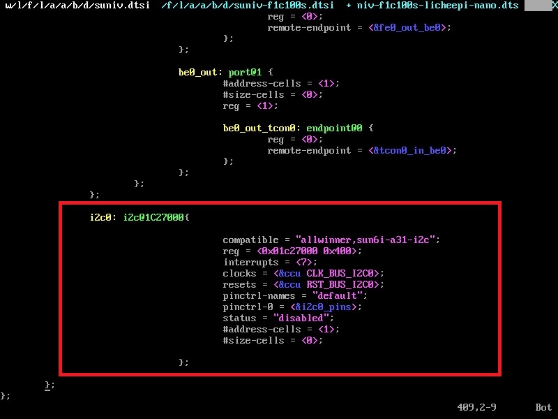

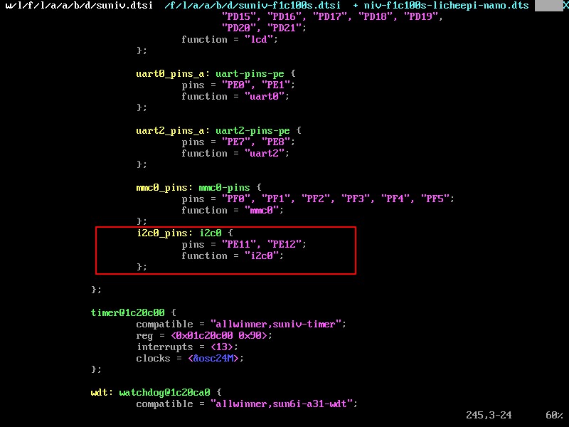

以下为 suniv.dtsi
#include <dt-bindings/clock/suniv-ccu.h>
#include <dt-bindings/reset/suniv-ccu.h>
	#address-cells = <1>;
	#size-cells = <1>;
	interrupt-parent = <&intc>;
	clocks {
		#size-cells = <1>;
		ranges;
		osc24M: clk-24M {
			#clock-cells = <0>;
			compatible = "fixed-clock";
			clock-frequency = <24000000>;
		osc32k: clk-32k {
			#clock-cells = <0>;
			clock-frequency = <32768>;
		fake100M: clk-100M {
			#clock-cells = <0>;
			clock-frequency = <100000000>;
			clock-output-names = "fake-100M";
	cpus {
		#address-cells = <0>;
		#size-cells = <0>;
		cpu {
			device_type = "cpu";
	de: display-engine {
		compatible = "allwinner,suniv-display-engine";
		allwinner,pipelines = <&fe0>;
		status = "disabled";
	soc {
		compatible = "simple-bus";
		#size-cells = <1>;
		ranges;
		sram-controller@1c00000 {
			compatible = "allwinner,sun4i-a10-sram-controller";
			reg = <0x01c00000 0x30>;
			#size-cells = <1>;
			ranges;
			sram_d: sram@10000 {
				compatible = "mmio-sram";
				reg = <0x00010000 0x1000>;
				#size-cells = <1>;
				otg_sram: sram-section@0 {
					compatible = "allwinner,sun4i-a10-sram-d";
					reg = <0x0000 0x1000>;
		spi0: spi@1c05000 {
			compatible = "allwinner,suniv-spi",
				     "allwinner,sun8i-h3-spi";
			reg = <0x01c05000 0x1000>;
			interrupts = <10>;
			clock-names = "ahb", "mod";
			resets = <&ccu RST_BUS_SPI0>;
			#size-cells = <0>;
		spi1: spi@1c06000 {
			reg = <0x01c06000 0x1000>;
			interrupts = <11>;
			clocks = <&ccu CLK_BUS_SPI1>, <&ccu CLK_BUS_SPI1>;
			resets = <&ccu RST_BUS_SPI1>;
			#size-cells = <0>;
		tcon0: lcd-controller@1c0c000 {
			compatible = "allwinner,suniv-tcon";
			reg = <0x01c0c000 0x1000>;
			interrupts = <29>;
			clocks = <&ccu CLK_BUS_LCD>,
				 <&ccu CLK_TCON>,
				 <&osc24M>;	/* Still unknown */
				      "tcon-ch0",
				      "tcon-ch1";
			clock-output-names = "tcon-pixel-clock";
			resets = <&ccu RST_BUS_LCD>;
			reset-names = "lcd";
			ports {
				#size-cells = <0>;
				tcon0_in: port@0 {
					#size-cells = <0>;
					reg = <0>;
					tcon0_in_be0: endpoint@0 {
						reg = <0>;
						remote-endpoint = <&be0_out_tcon0>;
				tcon0_out: port@1 {
					#size-cells = <0>;
					reg = <1>;
		mmc0: mmc@1c0f000 {
			compatible = "allwinner,suniv-mmc",
				     "allwinner,sun7i-a20-mmc";
			reg = <0x01c0f000 0x1000>;
			clocks = <&ccu CLK_BUS_MMC0>,
				 <&ccu CLK_MMC0>,
				 <&ccu CLK_MMC0_OUTPUT>,
				 <&ccu CLK_MMC0_SAMPLE>;
				      "mmc",
				      "output",
				      "sample";
			resets = <&ccu RST_BUS_MMC0>;
			reset-names = "ahb";
			interrupts = <23>;
			pinctrl-names = "default";
			pinctrl-0 = <&mmc0_pins>;
			#size-cells = <0>;
		mmc1: mmc@1c10000 {
			reg = <0x01c10000 0x1000>;
			clocks = <&ccu CLK_BUS_MMC1>,
				 <&ccu CLK_MMC1>,
				 <&ccu CLK_MMC1_OUTPUT>,
				 <&ccu CLK_MMC1_SAMPLE>;
				      "mmc",
				      "output",
				      "sample";
			resets = <&ccu RST_BUS_MMC1>;
			interrupts = <24>;
			#size-cells = <0>;
		ccu: clock@1c20000 {
			compatible = "allwinner,suniv-ccu";
			reg = <0x01c20000 0x400>;
			clock-names = "hosc", "losc";
			#clock-cells = <1>;
			#reset-cells = <1>;
			compatible = "allwinner,suniv-ic";
			reg = <0x01c20400 0x400>;
			interrupt-controller;
			#interrupt-cells = <1>;
		pio: pinctrl@1c20800 {
			compatible = "allwinner,suniv-pinctrl";
			reg = <0x01c20800 0x400>;
			gpio-controller;
			#interrupt-cells = <3>;
			#gpio-cells = <3>;
			spi0_pins_a: spi0-pins-pc {
				function = "spi0";
			lcd_rgb666_pins: lcd-rgb666-pins {
				pins = "PD1", "PD2", "PD3", "PD4",
				       "PD5", "PD6", "PD7", "PD8", "PD9",
				       "PD10", "PD11", "PD13", "PD14",
				       "PD15", "PD16", "PD17", "PD18", "PD19",
				       "PD20", "PD21";
				function = "lcd";
			uart0_pins_a: uart-pins-pe {
				pins = "PE0", "PE1";
				function = "uart0";
			uart2_pins_a: uart2-pins-pe {
				pins = "PE7", "PE8";
				function = "uart2";
			mmc0_pins: mmc0-pins {
				function = "mmc0";
			i2c0_pins: i2c0 {
				pins = "PE11", "PE12";
				function = "i2c0";
		timer@1c20c00 {
			compatible = "allwinner,suniv-timer";
			reg = <0x01c20c00 0x90>;
			interrupts = <13>;
			clocks = <&osc24M>;
		wdt: watchdog@1c20ca0 {
			reg = <0x01c20ca0 0x20>;
		uart0: serial@1c25000 {
			reg = <0x01c25000 0x400>;
			interrupts = <1>;
			reg-shift = <2>;
			reg-io-width = <4>;
		uart1: serial@1c25400 {
			reg = <0x01c25400 0x400>;
			interrupts = <2>;
			reg-shift = <2>;
			reg-io-width = <4>;
		uart2: serial@1c25800 {
			reg = <0x01c25800 0x400>;
			interrupts = <3>;
			reg-shift = <2>;
			reg-io-width = <4>;
		usb_otg: usb@1c13000 {
			reg = <0x01c13000 0x0400>;
			clocks = <&ccu CLK_BUS_OTG>;
			resets = <&ccu RST_BUS_OTG>;
			interrupts = <26>;
			interrupt-names = "mc";
			phys = <&usbphy 0>;
			phy-names = "usb";
			extcon = <&usbphy 0>;
		usbphy: phy@1c13400 {
			reg = <0x01c13400 0x10>;
			reg-names = "phy_ctrl";
			clocks = <&ccu CLK_USB_PHY0>;
			clock-names = "usb0_phy";
			resets = <&ccu RST_USB_PHY0>;
			reset-names = "usb0_reset";
			#phy-cells = <1>;
		fe0: display-frontend@1e00000 {
			compatible = "allwinner,suniv-display-frontend";
			reg = <0x01e00000 0x20000>;
			interrupts = <30>;
			clocks = <&ccu CLK_BUS_DE_FE>, <&ccu CLK_DE_FE>,
				 <&ccu CLK_DRAM_DE_FE>;
			clock-names = "ahb", "mod",
				      "ram";
			resets = <&ccu RST_BUS_DE_FE>;
			ports {
				#size-cells = <0>;
				fe0_out: port@1 {
					#size-cells = <0>;
					reg = <1>;
					fe0_out_be0: endpoint@0 {
						reg = <0>;
						remote-endpoint = <&be0_in_fe0>;
		be0: display-backend@1e60000 {
			compatible = "allwinner,suniv-display-backend";
			reg = <0x01e60000 0x10000>;
			reg-names = "be";
			interrupts = <31>;
			clocks = <&ccu CLK_BUS_DE_BE>, <&ccu CLK_DE_BE>,
				 <&ccu CLK_DRAM_DE_BE>;
				      "ram";
			resets = <&ccu RST_BUS_DE_BE>;
			reset-names = "be";
			assigned-clocks = <&ccu CLK_DE_BE>;
			assigned-clock-rates = <300000000>;
			ports {
				#size-cells = <0>;
				be0_in: port@0 {
					#size-cells = <0>;
					reg = <0>;
					be0_in_fe0: endpoint@0 {
						reg = <0>;
						remote-endpoint = <&fe0_out_be0>;
				be0_out: port@1 {
					#size-cells = <0>;
					reg = <1>;
					be0_out_tcon0: endpoint@0 {
						reg = <0>;
						remote-endpoint = <&tcon0_in_be0>;
		i2c0: i2c@1C27000{
					reg = <0x01c27000 0x400>;
					interrupts = <7>;
					clocks = <&ccu CLK_BUS_I2C0>;
					resets = <&ccu RST_BUS_I2C0>;
					pinctrl-0 = <&i2c0_pins>;
					#size-cells = <0>;

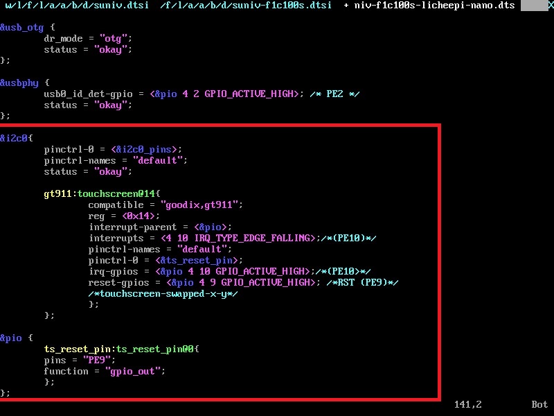

以下为 suniv-f1c100s-licheepi-nano.dts:
/dts-v1/;
#include "suniv-f1c100s.dtsi"
// touch screen
#include <dt-bindings/interrupt-controller/irq.h>
	model = "Lichee Pi Nano";
	compatible = "licheepi,licheepi-nano", "allwinner,suniv-f1c100s",
		     "allwinner,suniv";
	aliases {
		serial0 = &uart0;
		spi0 = &spi0;
	chosen {
	panel: panel {
		compatible = "lg,lb070wv8", "simple-panel";
		#size-cells = <0>;
		enable-gpios = <&pio 4 5 GPIO_ACTIVE_HIGH>;
		port@0 {
			reg = <0>;
			#size-cells = <0>;
			panel_input: endpoint@0 {
				reg = <0>;
	reg_vcc3v3: vcc3v3 {
		regulator-name = "vcc3v3";
&de {
&mmc0 {
	vmmc-supply = <&reg_vcc3v3>;
	bus-width = <4>;
	broken-cd;
&otg_sram {
&spi0 {
	pinctrl-0 = <&spi0_pins_a>;
	flash@0 {
		#size-cells = <1>;
		reg = <0>;
		spi-max-frequency = <40000000>;
&tcon0 {
	pinctrl-0 = <&lcd_rgb666_pins>;
&tcon0_out {
	tcon0_out_lcd: endpoint@0 {
		reg = <0>;
&uart0 {
	pinctrl-0 = <&uart0_pins_a>;
&uart2 {
	pinctrl-0 = <&uart2_pins_a>;
&usb_otg {
	dr_mode = "otg";
&usbphy {
	usb0_id_det-gpio = <&pio 4 2 GPIO_ACTIVE_HIGH>; /* PE2 */
&i2c0{
	gt911:touchscreen@14{
		compatible = "goodix,gt911";
		reg = <0x14>;
		interrupt-parent = <&pio>;
		interrupts = <4 10 IRQ_TYPE_EDGE_FALLING>;/*(PE10)*/
		pinctrl-0 = <&ts_reset_pin>;
		irq-gpios = <&pio 4 10 GPIO_ACTIVE_HIGH>;/*(PE10>*/
		reset-gpios = <&pio 4 9 GPIO_ACTIVE_HIGH>; /*RST (PE9)*/
		/*touchscreen-swapped-x-y*/
&pio {
	ts_reset_pin:ts_reset_pin@0{
	pins = "PE9";
	function = "gpio_out";
最近编辑记录 guo_felix (2019-05-23 11:34:01)

我比较了一下, 并没有什么问题, 看来还是硬件问题比较大。
https://whycan.cn/t_2439.html
看下 PE11, PE12  能不能输出高低电平。

谢谢晕哥    之前一直怀疑设备树写得有问题 检测了好几遍,也确实检查出了问题。后来尝试控制PE11 和PE12,发现抓从底板上引出来的PE12没办法拉低,但cat value 又确实是0,最后发现是核心板和底板就这个脚虚焊了  现在i2cdetect:

注意到原理图中 电容屏中断口连接的是PE3?
ts_sch
而且实际复位端口也是直接用了RC,即图中1口,实际dts并没有配置到gt911的中断端口以及复位端口?
尝试如下修改,不过好像没什么用处:

总结一下,应该是需要dts将引脚改对(PE3),还有就是<reg>也要改到相应0x5d

我的板子原理图是这样的 按照你这个配法 也跟你一开始问题一样 ,引脚编号都对应好了  dts是按你这样去改引脚的 但还是不行
拜托帮忙看看

log发出来看下

xd717

图好像没发成功。原理图上是有2.2k的上拉电阻到3.3的
