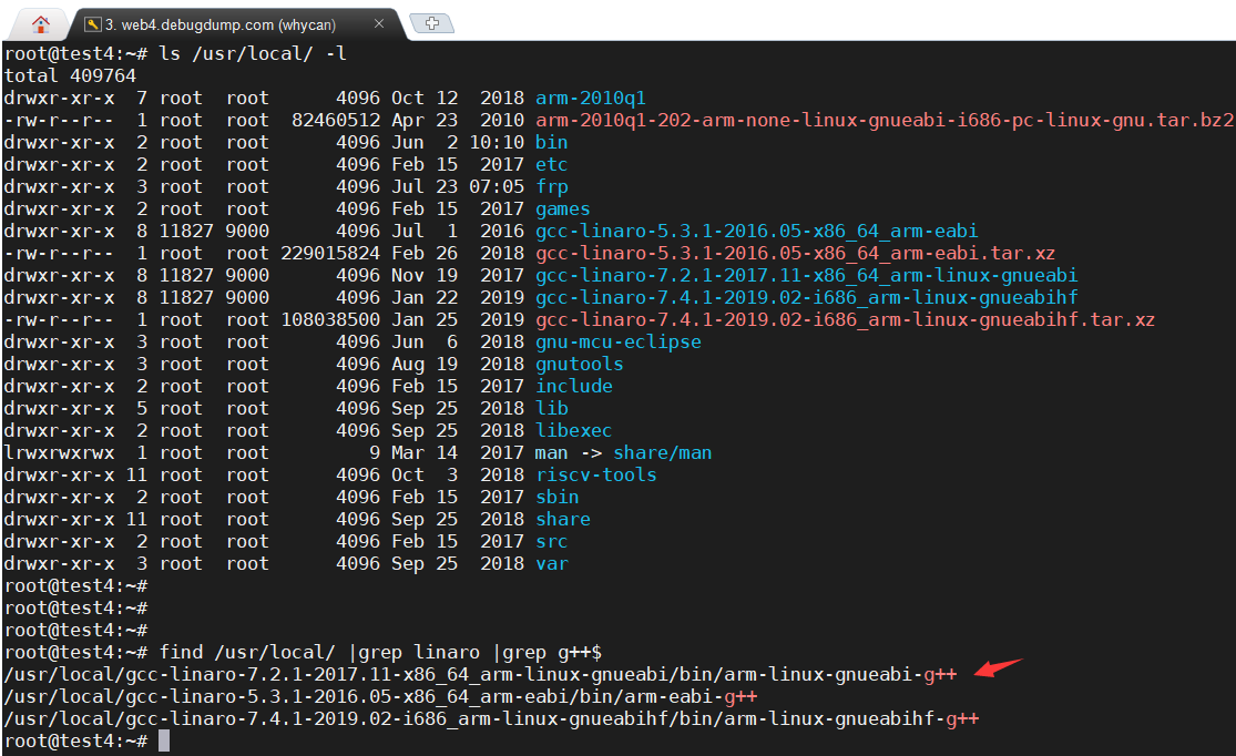

找不到g++
安装的gcc-linaro-6.3.1-2017.02-x86_64_arm-linux-gnueabihf,gcc 没问题。g++提示找不到。百度了一大圈也没搞定。哪位指点一下。谢谢。

root@test4:~# ls /usr/local/ -l
total 409764
drwxr-xr-x  7 root  root      4096 Oct 12  2018 arm-2010q1
-rw-r--r--  1 root  root  82460512 Apr 23  2010 arm-2010q1-202-arm-none-linux-gnueabi-i686-pc-linux-gnu.tar.bz2
drwxr-xr-x  2 root  root      4096 Jun  2 10:10 bin
drwxr-xr-x  2 root  root      4096 Feb 15  2017 etc
drwxr-xr-x  3 root  root      4096 Jul 23 07:05 frp
drwxr-xr-x  2 root  root      4096 Feb 15  2017 games
drwxr-xr-x  8 11827 9000      4096 Jul  1  2016 gcc-linaro-5.3.1-2016.05-x86_64_arm-eabi
-rw-r--r--  1 root  root 229015824 Feb 26  2018 gcc-linaro-5.3.1-2016.05-x86_64_arm-eabi.tar.xz
drwxr-xr-x  8 11827 9000      4096 Nov 19  2017 gcc-linaro-7.2.1-2017.11-x86_64_arm-linux-gnueabi
drwxr-xr-x  8 11827 9000      4096 Jan 22  2019 gcc-linaro-7.4.1-2019.02-i686_arm-linux-gnueabihf
-rw-r--r--  1 root  root 108038500 Jan 25  2019 gcc-linaro-7.4.1-2019.02-i686_arm-linux-gnueabihf.tar.xz
drwxr-xr-x  3 root  root      4096 Jun  6  2018 gnu-mcu-eclipse
drwxr-xr-x  3 root  root      4096 Aug 19  2018 gnutools
drwxr-xr-x  2 root  root      4096 Feb 15  2017 include
drwxr-xr-x  5 root  root      4096 Sep 25  2018 lib
drwxr-xr-x  2 root  root      4096 Sep 25  2018 libexec
lrwxrwxrwx  1 root  root         9 Mar 14  2017 man -> share/man
drwxr-xr-x 11 root  root      4096 Oct  3  2018 riscv-tools
drwxr-xr-x  2 root  root      4096 Feb 15  2017 sbin
drwxr-xr-x 11 root  root      4096 Sep 25  2018 share
drwxr-xr-x  2 root  root      4096 Feb 15  2017 src
drwxr-xr-x  3 root  root      4096 Sep 25  2018 var
root@test4:~#
root@test4:~#
root@test4:~#
root@test4:~# find /usr/local/ |grep linaro |grep g++$
/usr/local/gcc-linaro-7.2.1-2017.11-x86_64_arm-linux-gnueabi/bin/arm-linux-gnueabi-g++
/usr/local/gcc-linaro-5.3.1-2016.05-x86_64_arm-eabi/bin/arm-eabi-g++
/usr/local/gcc-linaro-7.4.1-2019.02-i686_arm-linux-gnueabihf/bin/arm-linux-gnueabihf-g++
root@test4:~#

我安装在opt 下,我find 也有啊
sinlinx@ubuntu://opt$ find . |grep linaro |grep g++$
./gcc-linaro-7.4.1-2019.02-x86_64_arm-linux-gnueabihf/bin/arm-linux-gnueabihf-g++
./gcc-linaro-6.3.1-2017.02-x86_64_arm-linux-gnueabihf/bin/arm-linux-gnueabihf-g++
但是编译arm-linux-gnueabihf-g++ 编译一个最简单的hello就提示找不到arm-linux-gnueabihf-g++ .

root@test4:~# /usr/local/gcc-linaro-7.4.1-2019.02-i686_arm-linux-gnueabihf/bin/arm-linux-gnueabihf-g++ -v
Using built-in specs.
COLLECT_GCC=/usr/local/gcc-linaro-7.4.1-2019.02-i686_arm-linux-gnueabihf/bin/arm-linux-gnueabihf-g++
COLLECT_LTO_WRAPPER=/usr/local/gcc-linaro-7.4.1-2019.02-i686_arm-linux-gnueabihf/bin/../libexec/gcc/arm-linux-gnueabihf/7.4.1/lto-wrapper
Target: arm-linux-gnueabihf
Configured with: '/home/tcwg-buildslave/workspace/tcwg-make-release_0/snapshots/gcc.git~linaro-7.4-2019.02/configure' SHELL=/bin/bash --with-mpc=/home/tcwg-buildslave/workspace/tcwg-make-release_0/_build/builds/destdir/i686-pc-linux-gnu --with-mpfr=/home/tcwg-buildslave/workspace/tcwg-make-release_0/_build/builds/destdir/i686-pc-linux-gnu --with-gmp=/home/tcwg-buildslave/workspace/tcwg-make-release_0/_build/builds/destdir/i686-pc-linux-gnu --with-gnu-as --with-gnu-ld --disable-libmudflap --enable-lto --enable-shared --without-included-gettext --enable-nls --with-system-zlib --disable-sjlj-exceptions --enable-gnu-unique-object --enable-linker-build-id --disable-libstdcxx-pch --enable-c99 --enable-clocale=gnu --enable-libstdcxx-debug --enable-long-long --with-cloog=no --with-ppl=no --with-isl=no --disable-multilib --with-float=hard --with-fpu=vfpv3-d16 --with-mode=thumb --with-tune=cortex-a9 --with-arch=armv7-a --enable-threads=posix --enable-multiarch --enable-libstdcxx-time=yes --enable-gnu-indirect-function --with-build-sysroot=/home/tcwg-buildslave/workspace/tcwg-make-release_0/_build/sysroots/arm-linux-gnueabihf --with-sysroot=/home/tcwg-buildslave/workspace/tcwg-make-release_0/_build/builds/destdir/i686-pc-linux-gnu/arm-linux-gnueabihf/libc --enable-checking=release --disable-bootstrap --enable-languages=c,c++,fortran,lto --build=i686-pc-linux-gnu --host=i686-pc-linux-gnu --target=arm-linux-gnueabihf --prefix=/home/tcwg-buildslave/workspace/tcwg-make-release_0/_build/builds/destdir/i686-pc-linux-gnu
Thread model: posix
gcc version 7.4.1 20181213 [linaro-7.4-2019.02 revision 56ec6f6b99cc167ff0c2f8e1a2eed33b1edc85d4] (Linaro GCC 7.4-2019.02)
root@test4:~#
root@test4:~#
root@test4:~#
root@test4:~# /usr/local/gcc-linaro-7.2.1-2017.11-x86_64_arm-linux-gnueabi/bin/arm-linux-gnueabi-g++ -v
COLLECT_GCC=/usr/local/gcc-linaro-7.2.1-2017.11-x86_64_arm-linux-gnueabi/bin/arm-linux-gnueabi-g++
COLLECT_LTO_WRAPPER=/usr/local/gcc-linaro-7.2.1-2017.11-x86_64_arm-linux-gnueabi/bin/../libexec/gcc/arm-linux-gnueabi/7.2.1/lto-wrapper
Configured with: '/home/tcwg-buildslave/workspace/tcwg-make-release/builder_arch/amd64/label/tcwg-x86_64-build/target/arm-linux-gnueabi/snapshots/gcc.git~linaro-7.2-2017.11/configure' SHELL=/bin/bash --with-mpc=/home/tcwg-buildslave/workspace/tcwg-make-release/builder_arch/amd64/label/tcwg-x86_64-build/target/arm-linux-gnueabi/_build/builds/destdir/x86_64-unknown-linux-gnu --with-mpfr=/home/tcwg-buildslave/workspace/tcwg-make-release/builder_arch/amd64/label/tcwg-x86_64-build/target/arm-linux-gnueabi/_build/builds/destdir/x86_64-unknown-linux-gnu --with-gmp=/home/tcwg-buildslave/workspace/tcwg-make-release/builder_arch/amd64/label/tcwg-x86_64-build/target/arm-linux-gnueabi/_build/builds/destdir/x86_64-unknown-linux-gnu --with-gnu-as --with-gnu-ld --disable-libmudflap --enable-lto --enable-shared --without-included-gettext --enable-nls --disable-sjlj-exceptions --enable-gnu-unique-object --enable-linker-build-id --disable-libstdcxx-pch --enable-c99 --enable-clocale=gnu --enable-libstdcxx-debug --enable-long-long --with-cloog=no --with-ppl=no --with-isl=no --disable-multilib --with-float=soft --with-mode=thumb --with-tune=cortex-a9 --with-arch=armv7-a --enable-threads=posix --enable-multiarch --enable-libstdcxx-time=yes --enable-gnu-indirect-function --with-build-sysroot=/home/tcwg-buildslave/workspace/tcwg-make-release/builder_arch/amd64/label/tcwg-x86_64-build/target/arm-linux-gnueabi/_build/sysroots/arm-linux-gnueabi --with-sysroot=/home/tcwg-buildslave/workspace/tcwg-make-release/builder_arch/amd64/label/tcwg-x86_64-build/target/arm-linux-gnueabi/_build/builds/destdir/x86_64-unknown-linux-gnu/arm-linux-gnueabi/libc --enable-checking=release --disable-bootstrap --enable-languages=c,c++,fortran,lto --build=x86_64-unknown-linux-gnu --host=x86_64-unknown-linux-gnu --target=arm-linux-gnueabi --prefix=/home/tcwg-buildslave/workspace/tcwg-make-release/builder_arch/amd64/label/tcwg-x86_64-build/target/arm-linux-gnueabi/_build/builds/destdir/x86_64-unknown-linux-gnu
Thread model: posix
gcc version 7.2.1 20171011 (Linaro GCC 7.2-2017.11)
root@test4:~#
root@test4:~#
arm-linux-gnueabi-g++: fatal error: no input files
compilation terminated.
arm-linux-gnueabihf-g++: fatal error: no input files
root@test4:~#
你的 是什么发行版本 Linux? 32bit 的吗?
我的是ubuntu-14.04.6-desktop-amd64 版本。
