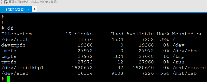

挂载成功:
# df
Filesystem           1K-blocks      Used Available Use% Mounted on
/dev/root                11776      4524      7252  38% /
devtmpfs                 19268         0     19268   0% /dev
tmpfs                    27972         0     27972   0% /dev/shm
tmpfs                    27972       324     27648   1% /tmp
tmpfs                    27972        12     27960   0% /run
/dev/mmcblk0p1         1920672        32   1920640   0% /mnt/sdcard
/dev/sda1                16334      9108      7226  56% /mnt/usb
