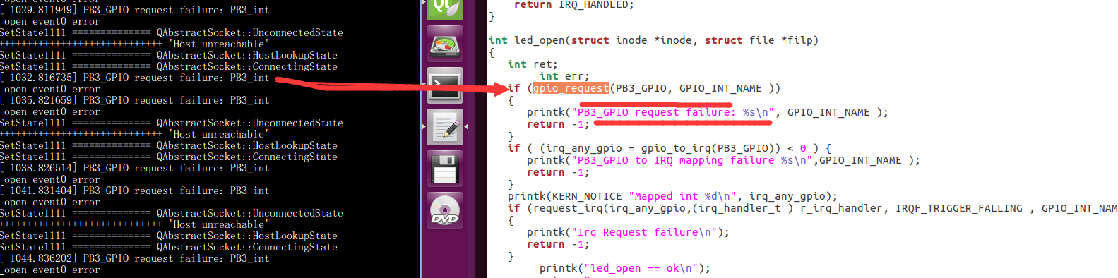

IO口作为按键中断写入了字符设备 Open的时候出现IO口申请错误
这个代码是通过晕哥那个中断驱动的帖子该了

我在Qt上面去Open设备的时候一到这里就就就进去了 if (gpio_request(PB3_GPIO, GPIO_INT_NAME )) 就返回负一了

[ 224.167890] Mapped int 44
[ 224.170614] genirq: Flags mismatch irq 44. 00000002 (PB3_int) vs. 00000002 (PB3_int)
[ 224.178386] Irq Request failure
open event0 error
[ 226.711062] interrupt received (irq: 44)
[ 226.715010] gpio pin is low
[ 227.053878] interrupt received (irq: 44)
[ 227.057826] gpio pin is low
