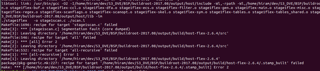

buildroot 编译出错recipe for target 'stage1scan.c' failed
buildroot 编译出错recipe for target 'stage1scan.c' failed,不知道怎么回事。如图:

Re: buildroot 编译出错recipe for target 'stage1scan.c' failed
https://github.com/spack/spack/issues/8152
sudo apt-get install install flex
