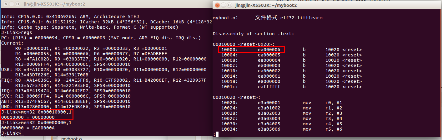

使芯片进入fel模式,确保安装好fel工具,输入make write,写入spi flash
jin@jin-X550JK:~/myboot2$ sudo sunxi-fel list
[sudo] jin 的密码:
USB device 001:005 Allwinner F1C100s
jin@jin-X550JK:~/myboot2$ make write
sudo sunxi-fel -p spiflash-write 0 myboot_sram.bin
100% [================================================] 1 kB, 56.8 kB/s
重新上电,用JLink调试
jin@jin-X550JK:~/myboot2$ sudo JLinkExe
SEGGER J-Link Commander V5.00 ('?' for help)
Compiled Jun 8 2015 21:14:06
DLL version V5.00, compiled Jun 8 2015 21:14:03
Firmware: J-Link V9 compiled Jun 2 2222 22:22:22
Hardware: V9.40
S/N: 81480416
Feature(s): GDB, RDI, FlashBP, FlashDL, JFlash, RDDI
VTarget = 3.174V
Info: TotalIRLen = 4, IRPrint = 0x01
Info: CP15.0.0: 0x41069265: ARM, Architecure 5TEJ
Info: CP15.0.1: 0x1D152192: ICache: 32kB (425632), DCache: 16kB (412832)
Info: Cache type: Separate, Write-back, Format C (WT supported)
Found 1 JTAG device, Total IRLen = 4:
#0 Id: 0x07926F0F, IRLen: 04, IRPrint: 0x1, ARM926EJ-S Core
Found ARM with core Id 0x07926F0F (ARM9)
Target interface speed: 100 kHz
J-Link>r
Reset delay: 0 ms
Reset type NORMAL: Using RESET pin, halting CPU after Reset
Info: Core does not stop after Reset, setting WP to stop it.
WARNING: PC of target system has unexpected value of 0x00000094 after reset.
J-Link>regs
PC: (R15) = 00000094, CPSR = 600000D3 (SVC mode, ARM FIQ dis. IRQ dis.)
Current:
R0 =00000001, R1 =00000022, R2 =00000033, R3 =00000001
R4 =00000055, R5 =00000066, R6 =00000077, R7 =DEADBEEF
R8 =4FA1C028, R9 =03033727, R10=00010020, R11=00000000, R12=00000000
R13=00009FF4, R14=0000006C, SPSR=00000010
USR: R8 =4FA1C028, R9 =03033727, R10=00010020, R11=00000000, R12=00000000
R13=43D7826E, R14=5391700B
FIQ: R8 =AA14036C, R9 =24AE5FF6, R10=C7F9D002, R11=B42000EF, R12=432D957F
R13=57F57D84, R14=221935F0, SPSR=00000010
IRQ: R13=0F419474, R14=66442FD7, SPSR=00000010
SVC: R13=00009FF4, R14=0000006C, SPSR=00000010
ABT: R13=D74F9C67, R14=66E3BEEF, SPSR=00000010
UND: R13=02800000, R14=12EDB4E6, SPSR=00000010
J-Link>
最近编辑记录 Jin劲 (2018-07-02 22:33:26)
楼主 #4 2018-07-02 23:01:53
Jin劲
注册时间: 2018-04-06
已发帖子: 217
积分: 217
Re: 小白求求挖坑填坑,f1c100s小小sram裸机
求解答,为啥读出来不是俺程序的第一条机器码

会不会是没有从flash加载到sram呢?
#6 2018-07-03 13:51:40
已发帖子: 9,526
mksunxiboot 这个做出来的 bin 文件,一定能给 f1c100s 加载吗?
做一个全是 0xFFFFFFFF 的文件, mksunxiboot 之后烧录到flash, 然后用jlink看 sram 是否正确?

#15 2018-07-10 10:10:00
楼主的mksunxiboot和xboot里的mksunxi有和不同,楼主的mksunxiboot我用了下,好像可以正确被识别,但是我用了xboot的mksunxi工具去处理bin,反而跑不起来,而且bin文件会变成8K(原来6k)代码
可以分析一下工具C源码,其实也就是加上一个文件头部信息
#17 2018-07-11 14:38:11
Jin劲 wrote:
研究了下搞懂了,xboot的工具是直接修改头的checksum,因为start.S已经有个头了。你的工具是在原来的bin前加个头。
