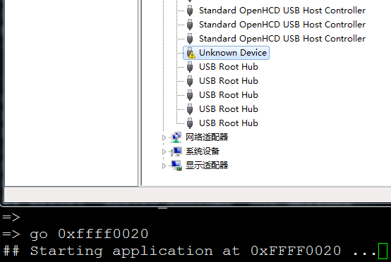

uboot: go 0xffff0020
Through serial console
If you have access to the UART already, you can send the character '1' ('2' on some devices) to the device during power-up.
Boot1 is initialized using this method.
With later SoCs, Allwinner's U-boot supports the "efex" command.
If "efex" is not available in your U-boot, you can use the simple uboot "go" command with arguments pointing to the return FEL address:
http://linux-sunxi.org/BROM#Other_booting_methods
=> go 0xffff0020
Starting application at 0xFFFF0020 ...

#6 2019-08-08 14:07:35
还能这么玩
注册时间: 2019-04-14
已发帖子: 119
积分: 119
Re: F1C100s如何在uboot触发芯片进入usb otg烧录模式
我也测试了一下, 不行啊.
unknow device 不能识别的USB设备。
最近编辑记录 还能这么玩 (2019-08-08 14:08:00)

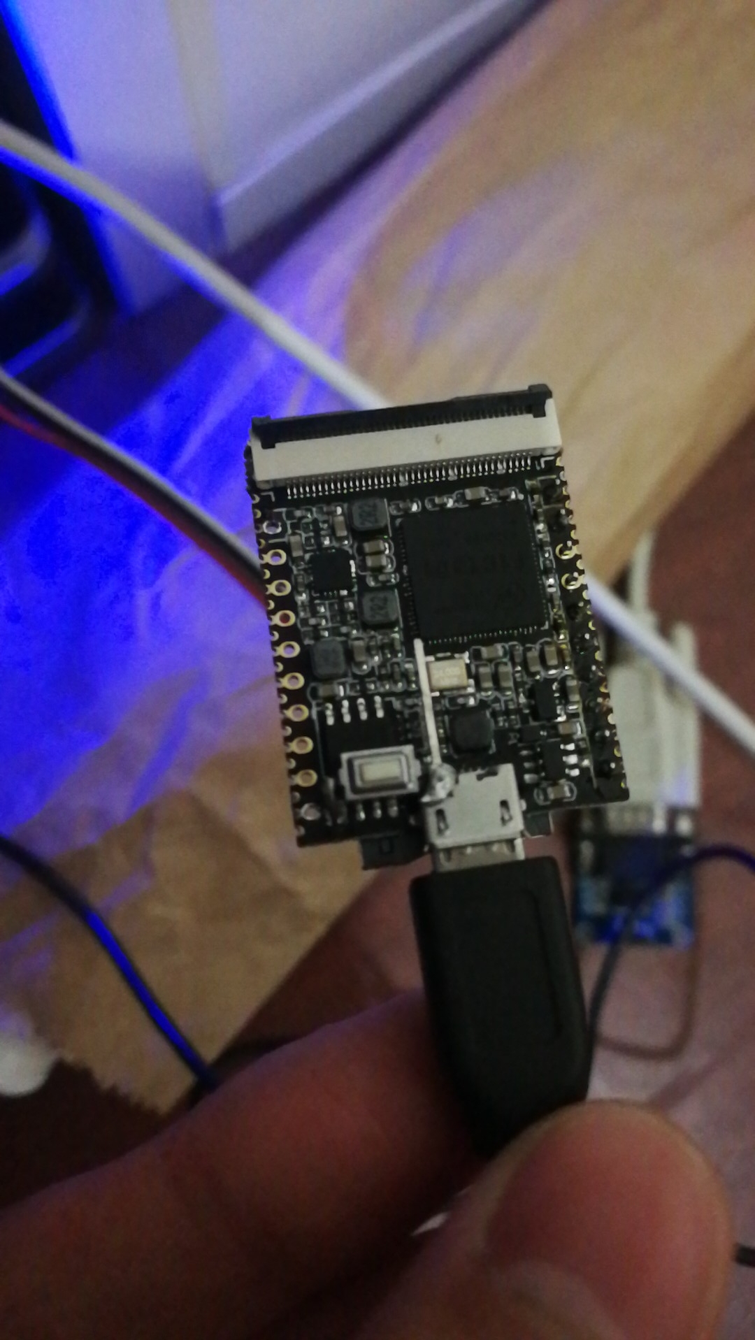

#7 2019-10-11 15:32:00
Rikka0w0
注册时间: 2019-10-08
可以在flash的1脚(Chip Select)和地(USB口外壳或者Flash的4脚)之间焊接一个按键,按住上电插USB就进FEL。如图:
