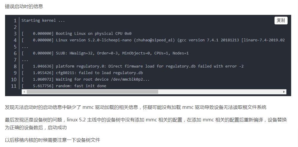

OrangePi zero plus2 H5 编译新的u-boot+linux kernel+rootfs无法启动的问题请教
题,上周六买的OrangePi zero plus2刚到,尝试了一下OrangePi给的系统后,决定自己去编译一下,然后就想用最新的u-boot和Linux kernel版本,于是下载了u-boot-2019.10的源码和linux kernel 5.3.6的源码,然后尝试编译,然后用busybox编译了文件系统,最终u-boot应该是可以正常启动了,但是引导内核,无法进入文件系统(描述或许不准确)。
由于之前没太接触过这方面的知识,对整个的流程或者步骤也不是很清楚,所以可能有些描述不正确,下面我贴一下具体的log和关键信息:

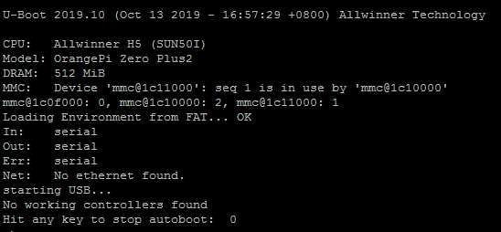

u-boot 启动截图:
u-boot start

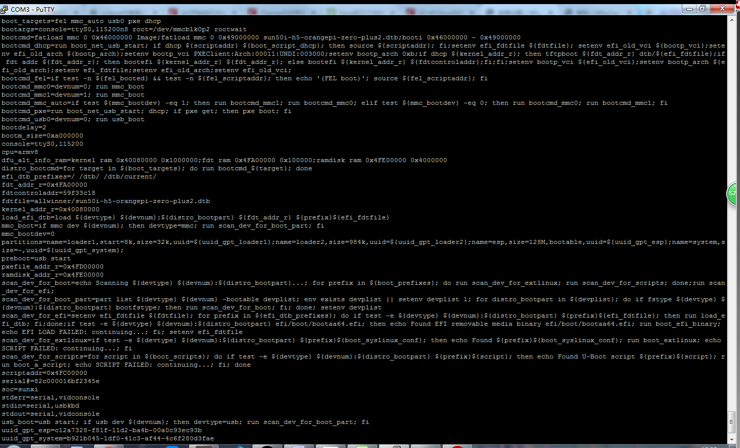

u-boot 环境变量:
u-boot env
图片太大,有可能看不清楚,我将bootcmd和bootargs单独截图出来;
u-boot bootargs bootcmd

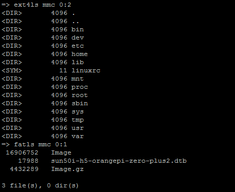

然后是kerenl启动log:
16906752 bytes read in 1256 ms (12.8 MiB/s)
17988 bytes read in 3 ms (5.7 MiB/s)
## Flattened Device Tree blob at 49000000
   Booting using the fdt blob at 0x49000000
   Loading Device Tree to 0000000049ff8000, end 0000000049fff643 ... OK
[    0.000000] Booting Linux on physical CPU 0x0000000000 [0x410fd034]
[    0.000000] Linux version 5.3.6 (imliubo@makingfunxyz) (gcc version 7.4.1 20181213 [linaro-7.4-2019.02 revision 56ec6f6b99cc167ff0c2f8e1a2eed33b1edc85d4] (Linaro GCC 7.4-2019.02)) #1 SMP PREEMPT Sun Oct 13 17:27:31 CST 2019
[    0.000000] Machine model: OrangePi Zero Plus2
[    0.000000] efi: Getting EFI parameters from FDT:
[    0.000000] efi: UEFI not found.
[    0.000000] cma: Reserved 32 MiB at 0x000000005e000000
[    0.000000] NUMA: No NUMA configuration found
[    0.000000] NUMA: Faking a node at [mem 0x0000000040000000-0x000000005fffffff]
[    0.000000] NUMA: NODE_DATA [mem 0x5dee4840-0x5dee5fff]
[    0.000000] Zone ranges:
[    0.000000]   DMA32    [mem 0x0000000040000000-0x000000005fffffff]
[    0.000000]   node   0: [mem 0x0000000040000000-0x000000005fffffff]
[    0.000000] Initmem setup node 0 [mem 0x0000000040000000-0x000000005fffffff]
[    0.000000] psci: PSCIv0.2 detected in firmware.
[    0.000000] psci: Trusted OS migration not required
[    0.000000] percpu: Embedded 22 pages/cpu s52184 r8192 d29736 u90112
[    0.000000] Detected VIPT I-cache on CPU0
[    0.000000] CPU features: detected: ARM erratum 845719
[    0.000000] Built 1 zonelists, mobility grouping on.  Total pages: 129024
[    0.000000] Policy zone: DMA32
[    0.000000] Kernel command line: console=ttyS0,115200n8 root=/dev/mmcblk0p2 rootwait

然后就一直卡在 Waiting for root device /dev/mmcblk0p2... 这了,不知道是什么原因,然后上一句mmc2: error -2,通过mmc list来看应该对应的是AP6212网卡,应该是没有驱动,所以没法识别,不晓得是不是这个原因:
u-boot mmc list
SD卡fat16分区和ext4分区的文件如下:
u-boot fat16 ext4

[    1.409981] mmc0: error -22 whilst initialising SD card
[    1.646334] mmc1: error -22 whilst initialising SDIO card
[    1.756957] mmc2: error -22 whilst initialising MMC card
mmc0,mmc1, mmc2 均初始化出错了
很可能是配置问题了, 因为能启动到这里硬件问题不会太大。

你用的是哪个 dtb 文件, 通过这个文件找对应的 dts 文件, 然后找到 mmc0 那个部分就可以。

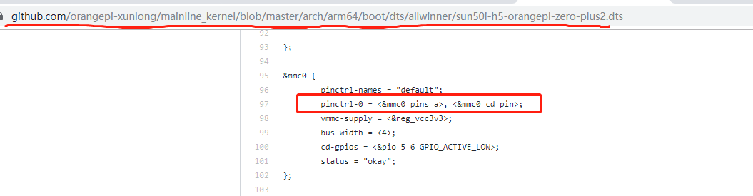

晚上好,晕哥,昨天晚上找了,主要是对设备文件的语法不懂,还有就是Orange Pi 仓库zero plus2的设备树文件有点乱,不晓得具体对应哪一个:
https://github.com/orangepi-xunlong/OrangePiH5_kernel/tree/master/arch/arm64/boot/OrangePiH5_Zero_Plus2_dts
就比如上面链接中有很多个,不晓得用哪一个。
然后还从这个仓库中发现了这个文件,与我编译的主线linux kernel中的不一样:
https://github.com/orangepi-xunlong/mainline_kernel/blob/master/arch/arm64/boot/dts/allwinner/sun50i-h5-orangepi-zero-plus2.dts
下面是主线linux kernel中的设备树文件:
https://github.com/torvalds/linux/blob/master/arch/arm64/boot/dts/allwinner/sun50i-h5-orangepi-zero-plus2.dts
可以看出两个文件关于mmc0部分确实不一样,原本以为直接替换编译就可以,但是提示两个管脚找不到,这就真不知道从什么地方去定义了。。。。
mmc0_pins_a
这个地方在主线linux kernel中的设备树文件中是没有定义的。
所以就不晓得咋修改了。。。。  第一次接触设备树,之前只是听说过。

https://whycan.cn/t_657.html#p2118
难道是 在menuconfig 里面把 CONFIG_REGULATOR 给禁用了 ???

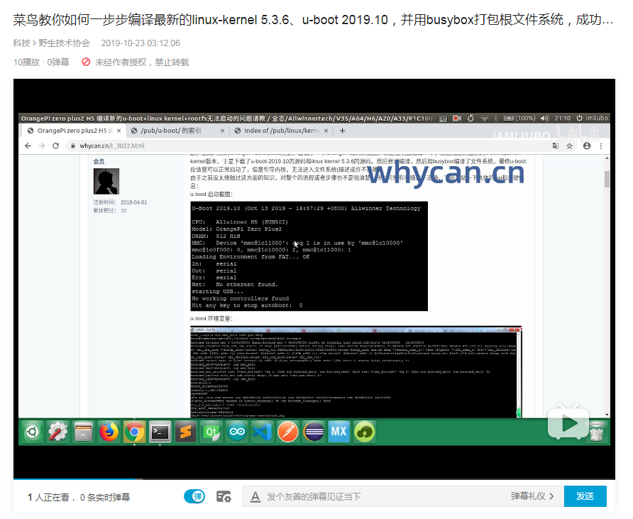

他来了,他来了,他带着视频走来了!
经过几天的努力视频终于搞完了,不得不说搞视频还是一个比较麻烦的工作!废话不多说,上链接!(话说怎么插入视频?)
以一个菜鸟的视角去学习如何编译属于你的镜像,有错误的话还请各位大神,在弹幕中批评指正。
https://www.bilibili.com/video/av73096039/
多谢晕哥的指导。
H5 linux-kernel u-boot B站
