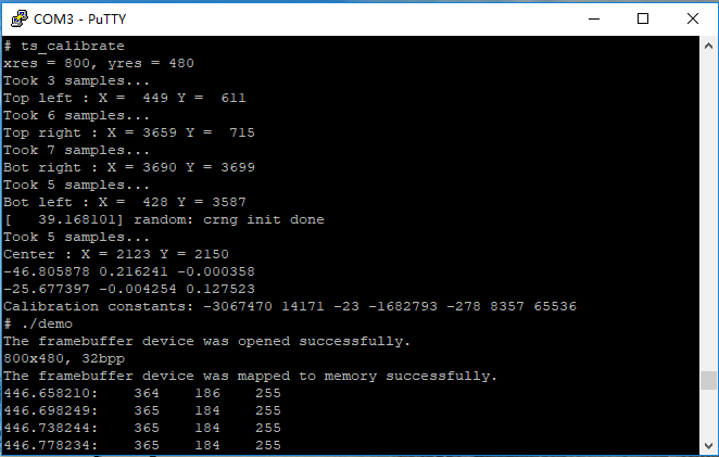

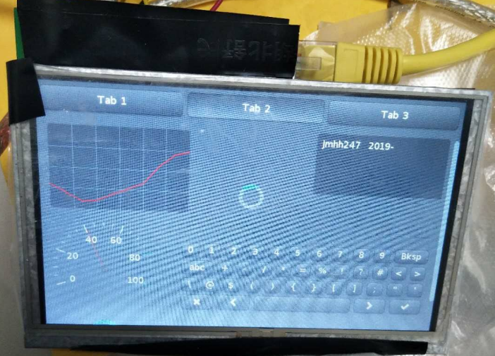

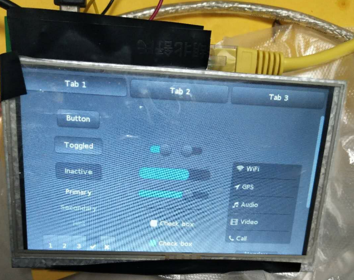

最后编译:
time make
运行截图:
上传一个附件用作参考。
整个工程较大,附件只包含需要修改的文件:main.c,evdev.c,Makefile,lv_conf.h,lv_drv_conf.h,lv_ex_conf.h。
lvgl-port-bak.rar

求助求助, 这个部分我使用tslib 1.4版本; 然后tslib移植成功, 并且ts_calibrate和ts_test 都可以测试通过;
但是运行lvgl后, 触摸就没有反应; 我尝试过没有在lvgl没有加入tslib的, 也尝试按照你的方式加入tslib后运行;
# ts_calibrate
xres = 800, yres = 480
Took 1 samples...
Top left : X =  400 Y =  672
Took 1 samples...
Top right : X = 3702 Y =  658
Took 2 samples...
Bot right : X = 3674 Y = 3478
Took 3 samples...
Bot left : X =  285 Y = 3479
Took 4 samples...
Center : X = 2067 Y = 2075
-34.692993 0.209173 0.005305
-40.521790 0.000298 0.135070
Calibration constants: -2273640 13708 347 -2655636 19 8851 65536
# ./lvgl_demo
The framebuffer device was opened successfully.
800x480, 32bpp
The framebuffer device was mapped to memory successfully.
[  174.892715] input input0: Poll touch data failed: -22
[  214.252723] input input0: Poll touch data failed: -22
[  264.092710] input input0: Poll touch data failed: -22
