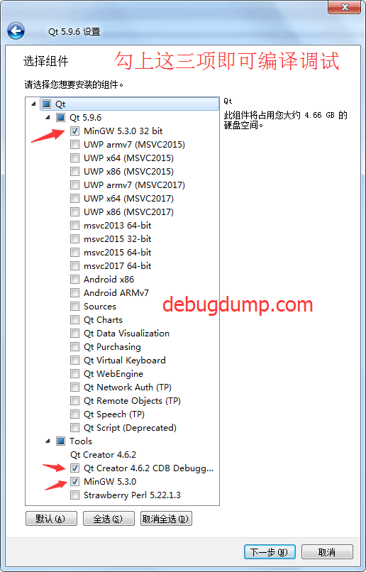

2018-08-11:
第1, 3步可以合并: 下载并安装 qt-opensource-windows-x86-5.9.6.exe, 选择 MinGW 5.3.0 32bit 即可!

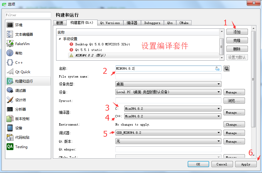

  1. 配置QtCreator mingw编译环境.

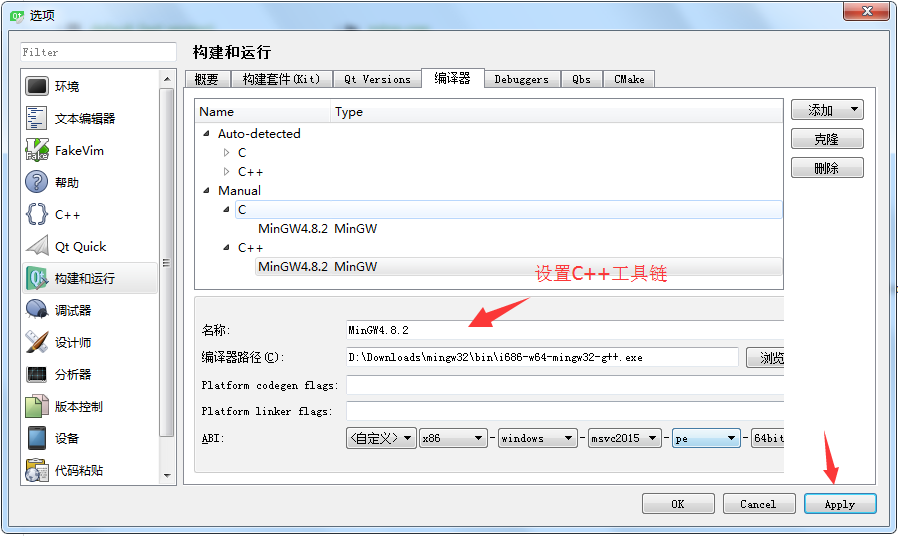

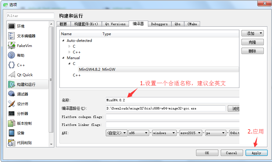

1) 设置编译工具链:
打开 【工具】->【选项】->【构建和运行】-> 【编译器】-> 【添加】->【MINGW】->【C】
打开 【工具】->【选项】->【构建和运行】-> 【编译器】-> 【添加】->【MINGW】->【C++】
2) 设置调试工具:

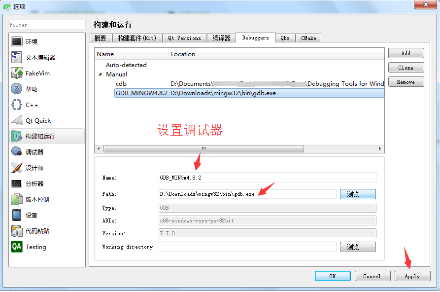

打开 【工具】->【选项】->【构建和运行】-> 【Debuggers】
3) 设置构建套件(Kit)
打开 【工具】->【选项】->【构建和运行】-> 【构建套件(Kit)】

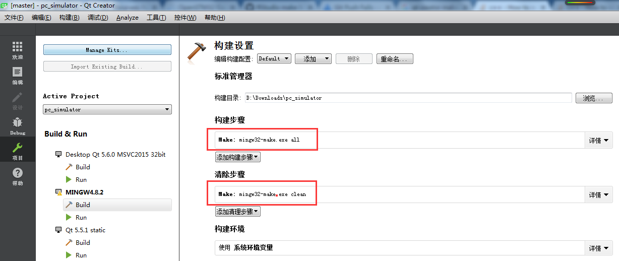

  1. 修改Makefile, 删除clean:
MAINOBJ -> OBJFILES
all: clean default
%.o: %.c
@$(CC) $(CFLAGS) -c $< -o $@
@echo "CC $<"
default: $(AOBJS) $(COBJS) $(MAINOBJ)
$(CC) -o $(BIN) $(MAINOBJ) $(AOBJS) $(COBJS) $(LDFLAGS)
clean:
rm -f $(BIN) $(AOBJS) $(COBJS) $(MAINOBJ)

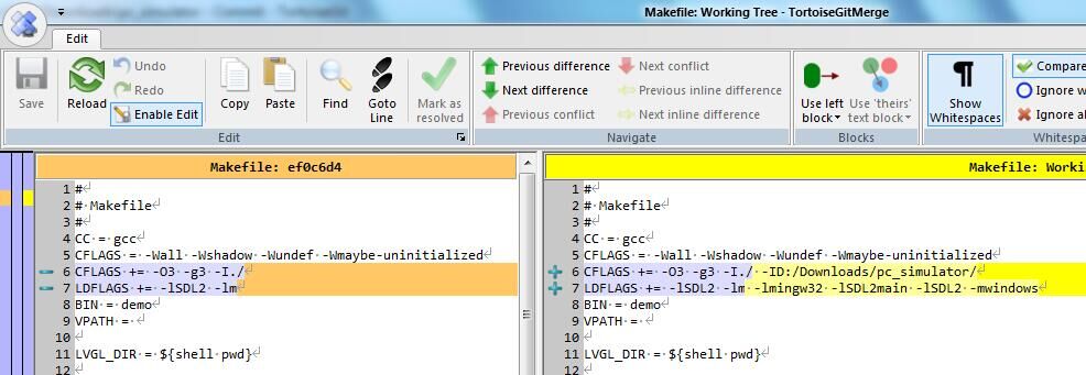

  1. 修改Makefile:
CFLAGS += -O3 -g3 -I./
LDFLAGS += -lSDL2 -lm
改为
CFLAGS += -O3 -g3 -I./ -ID:/Downloads/pc_simulator/
LDFLAGS += -lSDL2 -lm -lmingw32 -lSDL2main -lSDL2 -mwindows

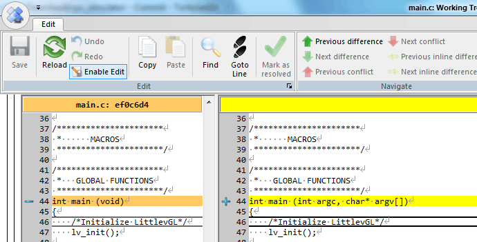

3.修改main.c:
int main (void)
int main (int argc, char* argv[])

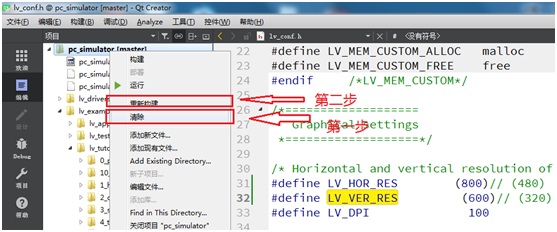

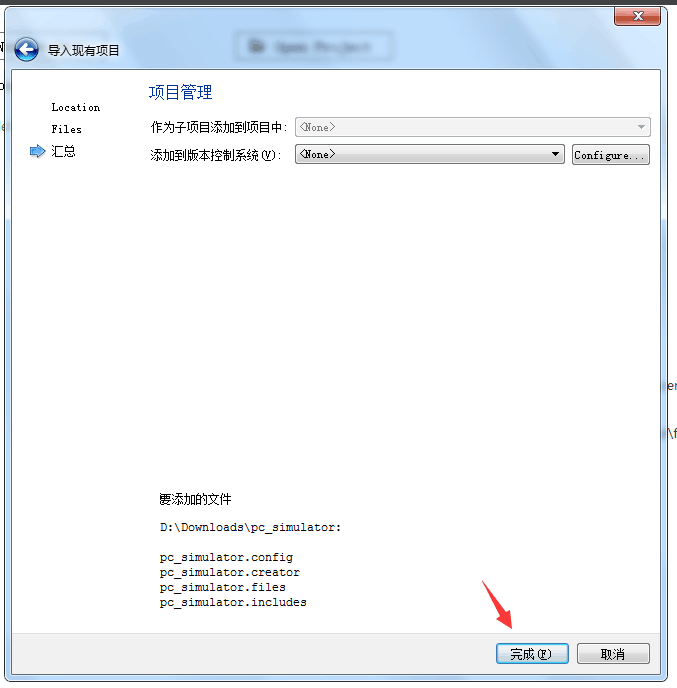

楼主 #4 2018-01-24 10:13:37
Re: 一步一步分享在Windows QtCreator/Mingw平台编译运行调试LittleVGL

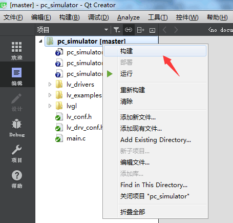

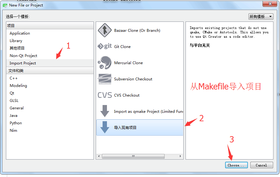

从Makefile导入工程:

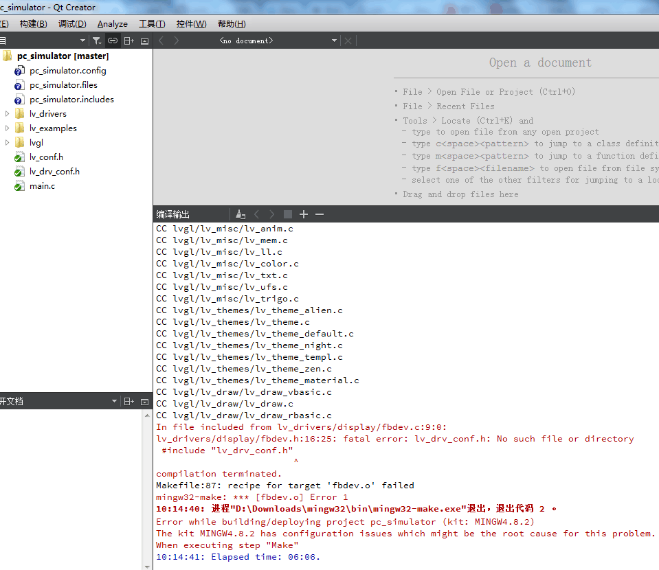

CC lvgl/lv_misc/lv_ll.c
CC lvgl/lv_misc/lv_color.c
CC lvgl/lv_misc/lv_txt.c
CC lvgl/lv_misc/lv_ufs.c
CC lvgl/lv_misc/lv_trigo.c
CC lvgl/lv_themes/lv_theme_alien.c
CC lvgl/lv_themes/lv_theme.c
CC lvgl/lv_themes/lv_theme_default.c
CC lvgl/lv_themes/lv_theme_night.c
CC lvgl/lv_themes/lv_theme_templ.c
CC lvgl/lv_themes/lv_theme_zen.c
CC lvgl/lv_themes/lv_theme_material.c
CC lvgl/lv_draw/lv_draw_vbasic.c
CC lvgl/lv_draw/lv_draw.c
CC lvgl/lv_draw/lv_draw_rbasic.c
In file included from lv_drivers/display/fbdev.c:9:0:
lv_drivers/display/fbdev.h:16:25: fatal error: lv_drv_conf.h: No such file or directory
#include "lv_drv_conf.h"
compilation terminated.
Makefile:87: recipe for target 'fbdev.o' failed
mingw32-make: *** [fbdev.o] Error 1
10:14:40: 进程"D:\Downloads\mingw32\bin\mingw32-make.exe"退出,退出代码 2 。
Error while building/deploying project pc_simulator (kit: MINGW4.8.2)
The kit MINGW4.8.2 has configuration issues which might be the root cause for this problem.
When executing step "Make"
10:14:41: Elapsed time: 06:06.
如果不修改Makefile和main.c, 编译或链接会出错,解决方案在3楼。

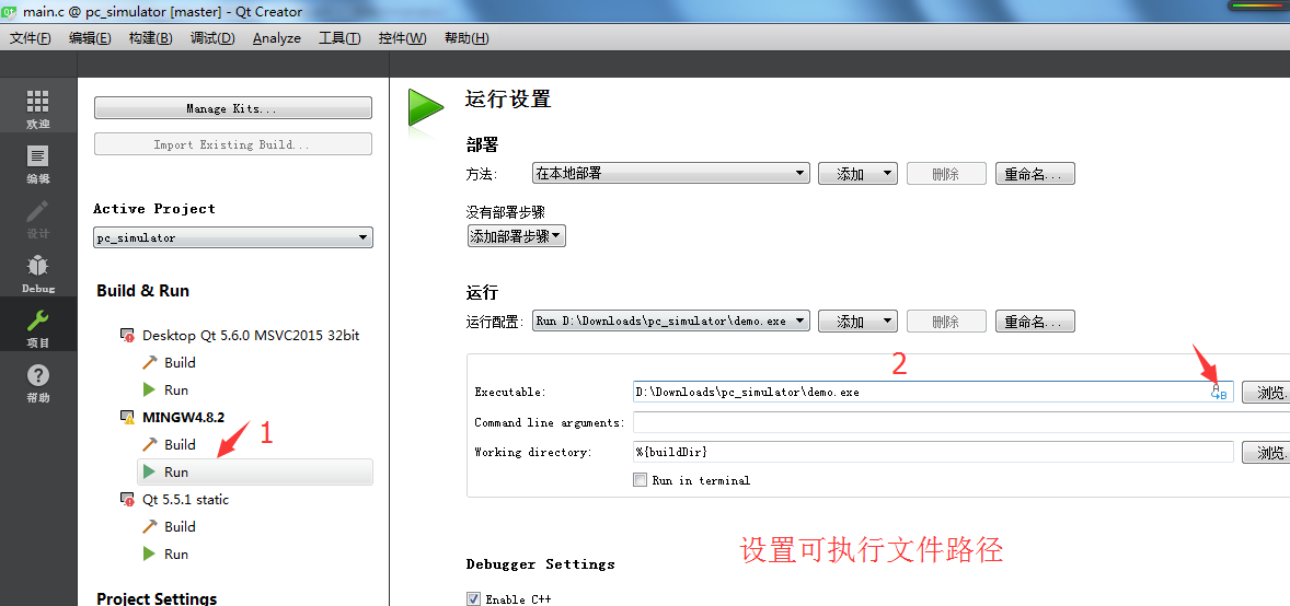

如果是上面的问题造成的,解决办法在此 how-to-make-exe-file-in-qt-creator
The executable is generated by the compiler when you build your application. To know where the executable is stored, look into
Projects (CTRL+5) -> Build settings -> General -> Build directory
This is where Qt creator will put the .exe it generates if you have shadow build enabled. If shadow build is disabled, the executable will be stored inside the project folder itself.

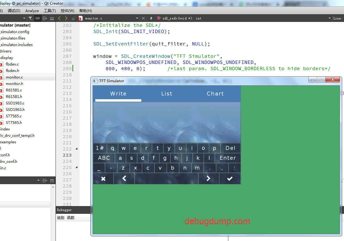

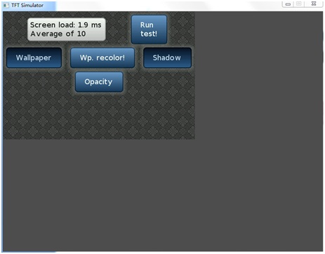

#16 2018-01-24 15:27:17

换个有颜色的,工程里面的例程比较详细
最近编辑记录 qwert1213131 (2018-01-24 15:51:48)
#19 2018-01-24 16:07:29
bugfix
注册时间: 2017-11-22
已发帖子: 125
积分: 125
qwert1213131 wrote:
/files/members/418/TIM20180124154945.png
换个有颜色的,工程里面的例程比较详细
怎么做到的?
能不能用汉字?
求汉字demo

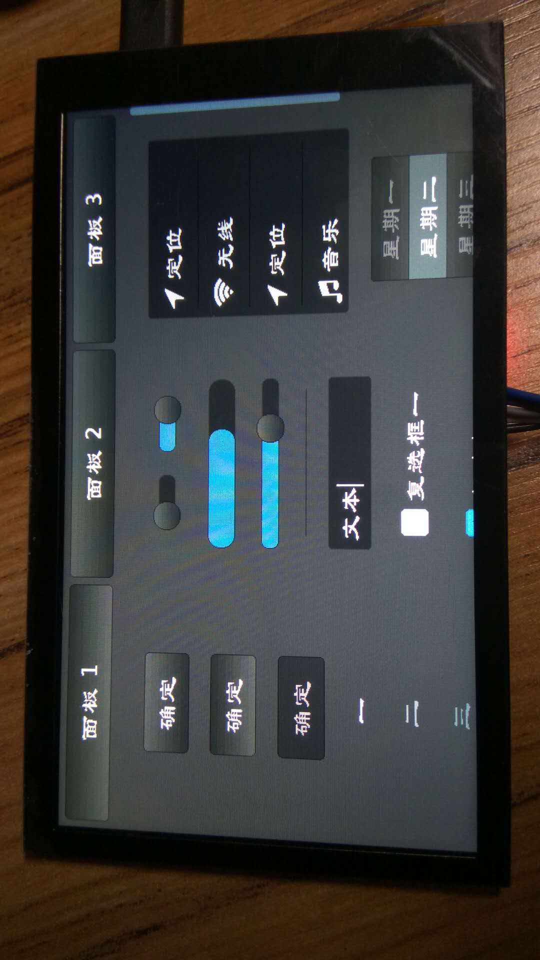

估计在下个版本会得到支持吧
lv_obj_t * label3 = lv_label_create(lv_scr_act(), NULL);
lv_label_set_text(label3, "hello dump#ff0000 debug#");
lv_label_set_recolor(label3, true);
lv_obj_align(label3, lv_scr_act(), LV_ALIGN_CENTER 0, 0);

跟贴,问一下,如何修改运行的窗体大小

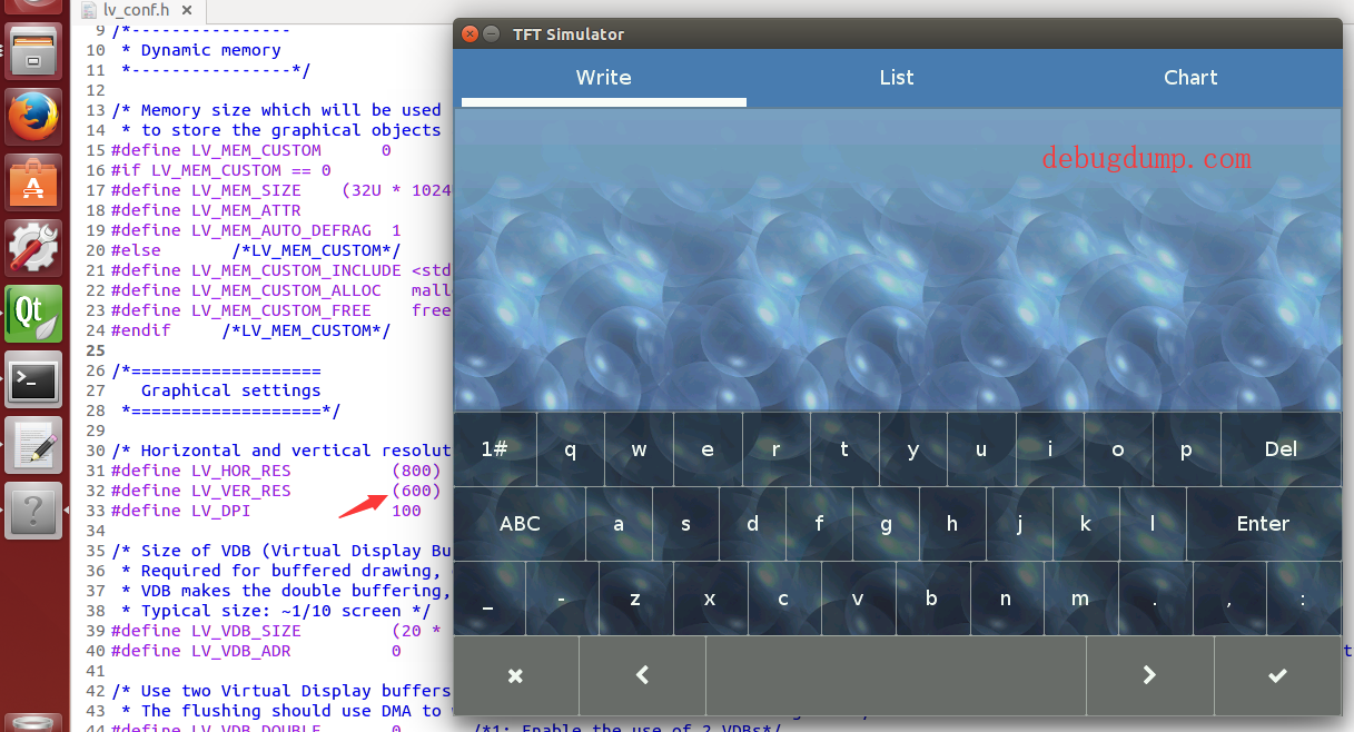

楼主 #50 2018-07-14 15:49:40
可以直接修改 SDL_CreateWindow 这个函数的参数,
或者修改 lv_conf.h:
/ Horizontal and vertical resolution of the library./
#define LV_HOR_RES (800)
#define LV_VER_RES (480)
清除(clean)后再重新编译即可。

#52 2018-07-14 18:11:05
beyondabcd
注册时间: 2018-06-12
已发帖子: 44
积分: 44
问题一:直接修改 SDL_CreateWindow 这个函数的参数,长宽设置为800X600,没有修改 lv_conf.h文件的情况下,程序运行。
窗体和程序显示的控件按比例一同变大了,显示开始有些模糊,鼠标按上面的几个按钮,基本失效。
问题二、修改 lv_conf.h文件的情况下,程序运行。修改lv_conf.h文件后,第一步清除,第二步重新构建。
窗体变大了,但显示的内容没有按比较变大。
请晕哥能不能解释一下,这两点的不同之处。
想贴几张图片上来,来说明情况,但没能明白,怎么贴图
楼主 #53 2018-07-14 18:13:58

#55 2018-07-14 20:02:41
是的,你当时问我怎么改模拟器大小,我直接找创建窗口的地方,试了一下 SDL_CreateWindow 确实直接可以改模拟器窗口大小,
但是只改这里是不行的,会带来其它后遗症, 这不触摸屏就乱套了.
至于为什么要 clean再编译才能起作用晚点公布答案
因为Makefile 写得不够严谨, 比如修改了 lv_conf.h 里面的长、宽之后,应该重新编译 monitor.c, 也就是说monitor.o 应该依赖 lv_conf.h, 实际上Makefile并没有这么做。
楼主 #58 2018-07-14 23:09:56
windows下gcc编译速度太慢,我在虚拟机ubuntu里面5分钟可以全部来过一次,windows半小时以上。
我试了一下修改lv_conf.h, 偷懒只删除 monitor.o, 确实和你上面的表现一致。
git clone https://github.com/littlevgl/pc_simulator.git
cd pc_simulator
git submodule update --init
make ###运行正常
./demo
make ###改 lv_config.h
./demo ###窗口放大正常
从上说明修改
#define LV_VER_RES (600)
肯定是可以的,至于为什么有问题,肯定是我们操作有问题。
