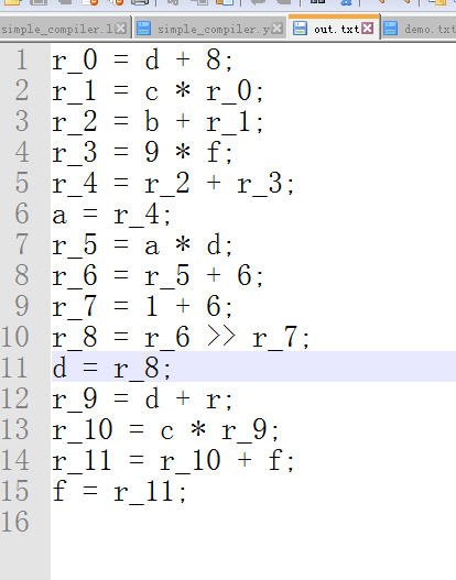

再上yacc文件:
#include <stdio.h>
#define YYSTYPE int
#include "lex.yy.c"
int yyparse(void);
void yyerror(char* s);
%token dig var lp_s rp_s plus minus mul divide mod shift_r shift_l not more less more_equal less_equal equal_equal not_equal equal split1 split2 next_line
code_lines: code_lines code_line next_line {}
code_line: code split2 {}
code: var_set {}
	| var_level5 {}
var_set: var equal var_level5 {printf("%s = %s;\n", (char*)$1, (char*)$3); free((char*)$1); free((char*)$3);}
var_level5: var_level5 more var_level4 {$$ = new_var(); printf("%s = %s > %s;\n", (char*)$$, (char*)$1, (char*)$3); free((char*)$1); free((char*)$3);}
	| var_level5 less var_level4 {$$ = new_var(); printf("%s = %s < %s;\n", (char*)$$, (char*)$1, (char*)$3); free((char*)$1); free((char*)$3);}
	| var_level5 more_equal var_level4 {$$ = new_var(); printf("%s = %s >= %s;\n", (char*)$$, (char*)$1, (char*)$3); free((char*)$1); free((char*)$3);}
	| var_level5 less_equal var_level4 {$$ = new_var(); printf("%s = %s <= %s;\n", (char*)$$, (char*)$1, (char*)$3); free((char*)$1); free((char*)$3);}
	| var_level5 equal_equal var_level4 {$$ = new_var(); printf("%s = %s == %s;\n", (char*)$$, (char*)$1, (char*)$3); free((char*)$1); free((char*)$3);}
	| var_level5 not_equal var_level4 {$$ = new_var(); printf("%s = %s != %s;\n", (char*)$$, (char*)$1, (char*)$3); free((char*)$1); free((char*)$3);}
	| var_level4 {$$ = $1;}
var_level4: var_level4 shift_r var_level3 {$$ = new_var(); printf("%s = %s >> %s;\n", (char*)$$, (char*)$1, (char*)$3); free((char*)$1); free((char*)$3);}
	| var_level4 shift_l var_level3 {$$ = new_var(); printf("%s = %s << %s;\n", (char*)$$, (char*)$1, (char*)$3); free((char*)$1); free((char*)$3);}
	| var_level3 {$$ = $1;}
var_level3: var_level3 plus var_level2 {$$ = new_var(); printf("%s = %s + %s;\n", (char*)$$, (char*)$1, (char*)$3); free((char*)$1); free((char*)$3);}
	| var_level3 minus var_level2 {$$ = new_var(); printf("%s = %s - %s;\n", (char*)$$, (char*)$1, (char*)$3); free((char*)$1); free((char*)$3);}
	| var_level2 {$$ = $1;}
var_level2: var_level2 mul var_level1 {$$ = new_var(); printf("%s = %s * %s;\n", (char*)$$, (char*)$1, (char*)$3); free((char*)$1); free((char*)$3);}
    | var_level2 divide var_level1 {$$ = new_var(); printf("%s = %s / %s;\n", (char*)$$, (char*)$1, (char*)$3); free((char*)$1); free((char*)$3);}
	| var_level2 mod var_level1 {$$ = new_var(); printf("%s = %s %% %s;\n", (char*)$$, (char*)$1, (char*)$3); free((char*)$1); free((char*)$3);}
    | var_level1 {$$ = $1;}
var_level1: var {$$ = $1;}
	| not var {$$ = new_var(); printf("%s = ~%s;\n", (char*)$$, (char*)$1); free((char*)$1);}
	| func_call {$$ = $1;}
	| not func_call {$$ = new_var(); printf("%s = ~%s;\n", (char*)$$, (char*)$1); free((char*)$1);}
	| lp_s var_level5 rp_s {$$ = $2;}
func_call: var lp_s rp_s {$$ = new_var(); printf("%s = %s;\n", (char*)$$, (char*)function_call($1));}
	| var lp_s func_para rp_s {$$ = new_var(); printf("%s = %s;\n", (char*)$$, (char*)function_callp($1, $3));}
func_para: var_level5 {$$ = $1;}
	| func_para split1 var_level5 {$$ = function_paras($1, $3);}
int main(int argc, char *argv[]) {
	return yyparse();
int yywrap(void) {
	return 1;
void yyerror(char* s) {
	printf("error: %s\n", s);
转换成c文件
bison.exe -d simple_compiler.y
flex simple_compiler.l
编译成exe,测试:
输入文件:
输出文件:
