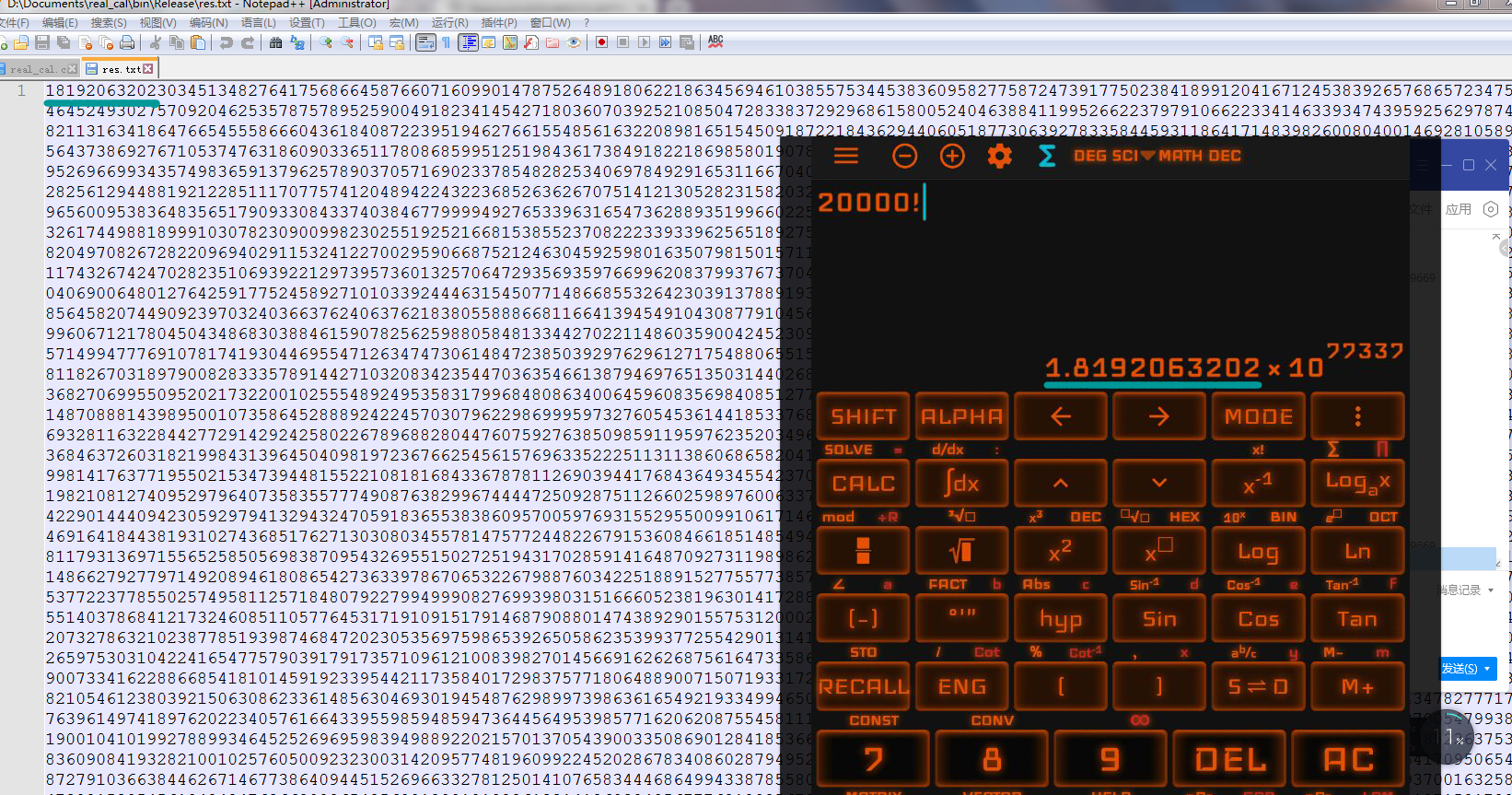

测试结果比对:

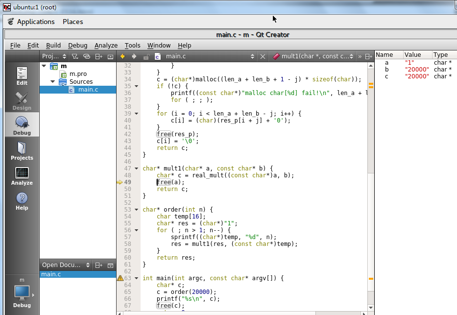

咦,服务器上面跑了一下, 有错误:
root@ubuntu:/tmp# vi multi.c
root@ubuntu:/tmp# gcc -o multi multi.c
multi.c: In function ‘real_mult’:
multi.c:6:10: warning: implicit declaration of function ‘strlen’ [-Wimplicit-function-declaration]
  len_a = strlen(a);
multi.c:6:10: warning: incompatible implicit declaration of built-in function ‘strlen’
multi.c:6:10: note: include ‘<string.h>’ or provide a declaration of ‘strlen’
root@ubuntu:/tmp#
root@ubuntu:/tmp#
root@ubuntu:/tmp#
root@ubuntu:/tmp#
root@ubuntu:/tmp# ./multi
free(): invalid pointer
Aborted
root@ubuntu:/tmp#

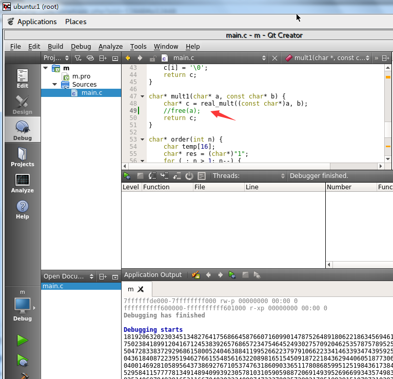

把49行注释起来, 就不会出现内存释放错误, 20000阶乘就算出来了.

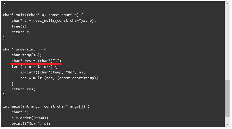

错不在这!
而是这里
FluxBB bbcode 错误点
改为这样:
char* order(int n)
    char temp[16];
    char* res = (char*)"1";    //删除
    char* res = (char*)malloc(32);    //改正后
    for ( ; n > 1; n--)
        sprintf((char*)temp, "%d", n);
        res = mult1(res, (const char*)temp);
    return res;
就可以了。

确实是这个BUG,疏忽了
