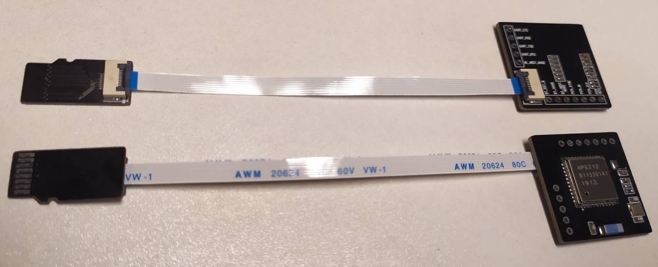

# ping www.163.com
PING www.163.com (183.47.233.12): 56 data bytes
64 bytes from 183.47.233.12: seq=0 ttl=47 time=42.783 ms
64 bytes from 183.47.233.12: seq=1 ttl=46 time=47.374 ms
64 bytes from 183.47.233.12: seq=2 ttl=47 time=45.310 ms
64 bytes from 183.47.233.12: seq=3 ttl=46 time=58.623 ms
64 bytes from 183.47.233.12: seq=4 ttl=46 time=51.602 ms
[   25.798286] brcmfmac: brcmf_sdio_bus_sleep: error while changing bus sleep state -110
[   25.806257] sunxi-mmc 1c10000.mmc: data error, sending stop command
[   25.812528] sunxi-mmc 1c10000.mmc: send stop command failed
[   25.818882] brcmfmac: brcmf_sdio_txfail: sdio error, abort command and terminate frame
[   25.831074] brcmfmac: brcmf_sdiod_regrw_helper: failed to write data F1@0x1000d, err: -110
[   25.843893] brcmfmac: brcmf_sdiod_regrw_helper: failed to read data F1@0x1001a, err: -110
[   25.855605] brcmfmac: brcmf_sdiod_regrw_helper: failed to read data F1@0x10019, err: -110
[   25.867632] brcmfmac: brcmf_sdiod_regrw_helper: failed to read data F1@0x1001a, err: -110
[   25.879965] brcmfmac: brcmf_sdiod_regrw_helper: failed to read data F1@0x10019, err: -110
[   25.892604] brcmfmac: brcmf_sdiod_regrw_helper: failed to read data F1@0x1001a, err: -110
[   25.904928] brcmfmac: brcmf_sdiod_regrw_helper: failed to read data F1@0x10019, err: -110
[   26.798518] brcmfmac: brcmf_sdio_bus_sleep: error while changing bus sleep state -110
[   26.806480] sunxi-mmc 1c10000.mmc: data error, sending stop command
[   26.812753] sunxi-mmc 1c10000.mmc: send stop command failed
[   26.819020] brcmfmac: brcmf_sdio_txfail: sdio error, abort command and terminate frame
[   26.831204] brcmfmac: brcmf_sdiod_regrw_helper: failed to write data F1@0x1000d, err: -110
[   26.844023] brcmfmac: brcmf_sdiod_regrw_helper: failed to read data F1@0x1001a, err: -110
[   26.856414] brcmfmac: brcmf_sdiod_regrw_helper: failed to read data F1@0x10019, err: -110
[   26.868714] brcmfmac: brcmf_sdiod_regrw_helper: failed to read data F1@0x1001a, err: -110
[   26.881046] brcmfmac: brcmf_sdiod_regrw_helper: failed to read data F1@0x10019, err: -110
[   26.893678] brcmfmac: brcmf_sdiod_regrw_helper: failed to read data F1@0x1001a, err: -110
[   26.905579] brcmfmac: brcmf_sdiod_regrw_helper: failed to read data F1@0x10019, err: -110
[   27.798723] brcmfmac: brcmf_sdio_bus_sleep: error while changing bus sleep state -110
[   27.806688] sunxi-mmc 1c10000.mmc: data error, sending stop command
[   27.812960] sunxi-mmc 1c10000.mmc: send stop command failed
[   27.819195] brcmfmac: brcmf_sdio_txfail: sdio error, abort command and terminate frame
[   27.831384] brcmfmac: brcmf_sdiod_regrw_helper: failed to write data F1@0x1000d, err: -110
[   27.844183] brcmfmac: brcmf_sdiod_regrw_helper: failed to read data F1@0x1001a, err: -110
[   27.856577] brcmfmac: brcmf_sdiod_regrw_helper: failed to read data F1@0x10019, err: -110
[   27.868875] brcmfmac: brcmf_sdiod_regrw_helper: failed to read data F1@0x1001a, err: -110
[   27.881207] brcmfmac: brcmf_sdiod_regrw_helper: failed to read data F1@0x10019, err: -110
[   27.893841] brcmfmac: brcmf_sdiod_regrw_helper: failed to read data F1@0x1001a, err: -110
[   27.905578] brcmfmac: brcmf_sdiod_regrw_helper: failed to read data F1@0x10019, err: -110

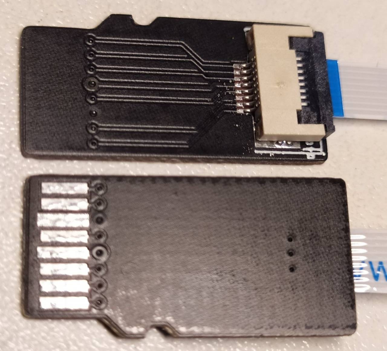

貌似一个关于休眠/复位的错误,  https://lore.kernel.org/patchwork/patch/1035997/
因为 TF 座上面没有多余的IO口,所以复位/休眠相关 IO 全部直接硬 上/下拉了。

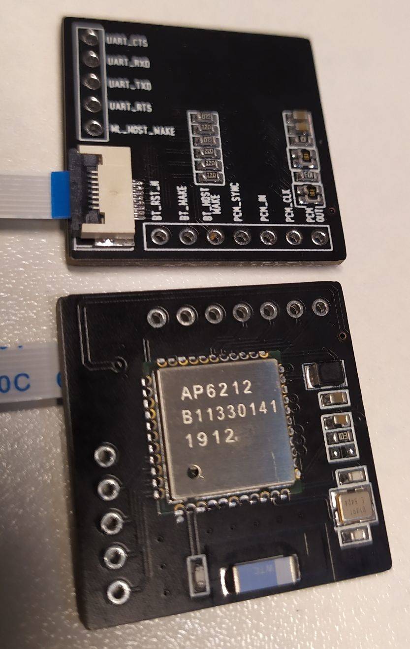

#9 2019-10-15 23:09:42
t123yh
注册时间: 2019-10-15
积分: 44
Re: 感谢 @小智科技 赠送的 TF卡 AP6212 WIFI 模组
https://whycan.cn/t_2522.html
看这个帖子的话应该是需要连接 Reset 脚的。

楼主 #16 2019-11-21 23:30:14
已发帖子: 9,403
可能是因为线太细, 电流不够引起.
后面空了我在飞线试一试.
资料你搜下本站 AP6212 帖子, 有很多的.我就是按照那个做的.
