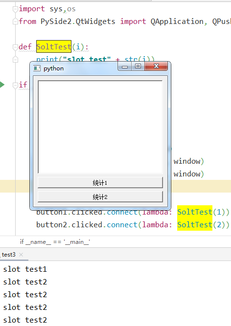

import sys,os
from PySide2.QtWidgets import QApplication, QPushButton, QTextEdit, QMainWindow, QVBoxLayout, QWidget
def SoltTest(i):
    print("slot test" + str(i))
if __name__ == '__main__':
    app = QApplication(sys.argv)
    window = QMainWindow()
    boxlayout = QVBoxLayout(window)
    button1 = QPushButton("统计1", window)
    button2 = QPushButton("统计2", window)
    textedit1 = QTextEdit(window)
    button1.clicked.connect(lambda: SoltTest(1))
    button2.clicked.connect(lambda: SoltTest(2))
    boxlayout.addWidget(textedit1)
    boxlayout.addWidget(button1)
    boxlayout.addWidget(button2)
    mainwidget = QWidget()
    mainwidget.setLayout(boxlayout)
    window.setCentralWidget(mainwidget)
    window.show()
    sys.exit(app.exec_())感谢楼主分享, 我也写了一个很简单的槽函数测试程序。
