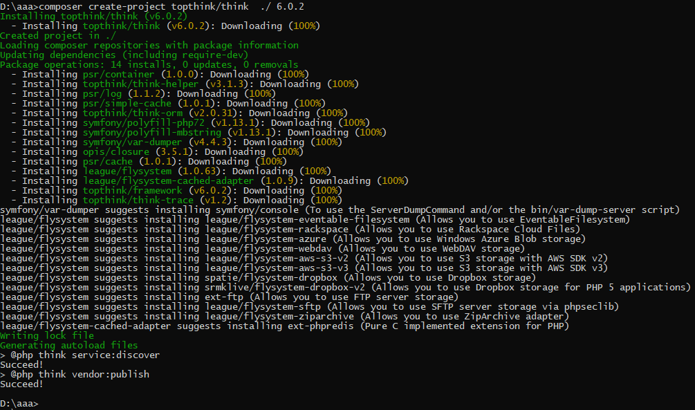

composer create-project topthink/think ./ 6.0.2
composer update topthink/framework
#如果上面的命令卡住不动, 就切换阿里云源#

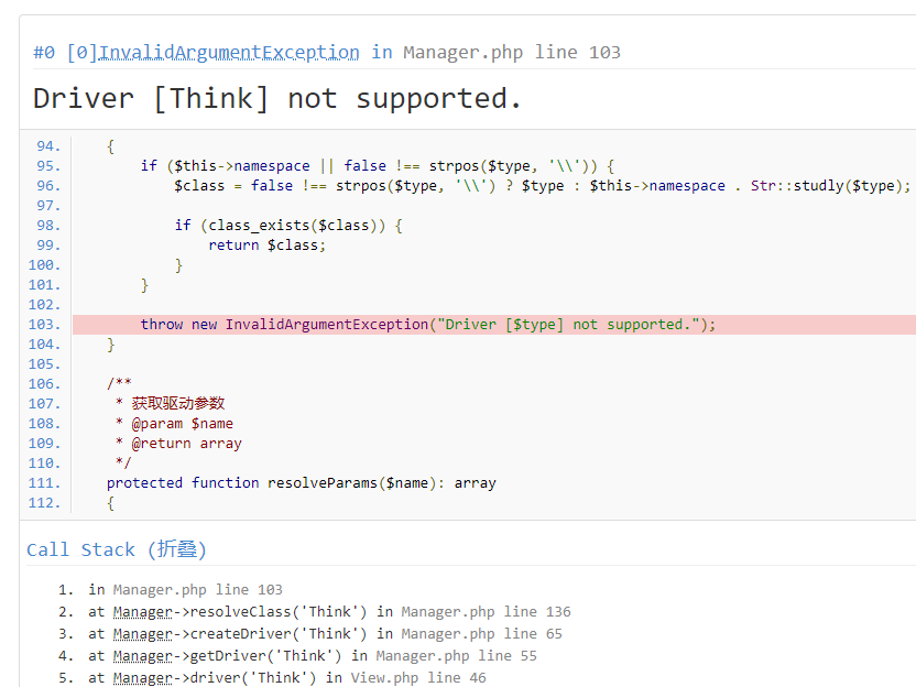

#0 [0]InvalidArgumentException in Manager.php line 103
Driver [Think] not supported.
if ($this->namespace || false !== strpos($type, '\\')) {
$class = false !== strpos($type, '\\') ? $type : $this->namespace . Str::studly($type);
if (class_exists($class)) {
return $class;
throw new InvalidArgumentException("Driver [$type] not supported.");
* 获取驱动参数
* @param $name
* @return array
protected function resolveParams($name): array

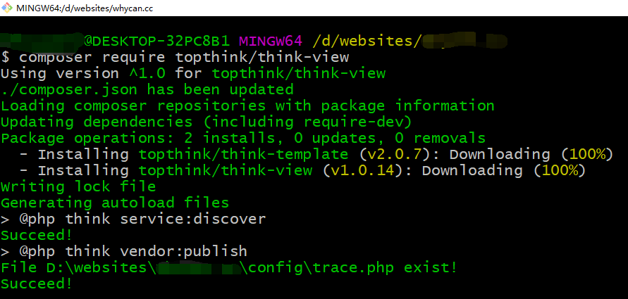

运行命令:
composer require topthink/think-view
解决上面的驱动问题.

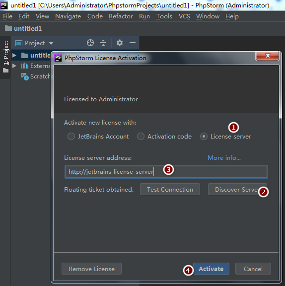

phpstorm 破解步奏 (穷人逃 ...
1. 下载 PhpStorm-2019.2.1.exe (其他版本可能破解不成功) 并安装
2. 解压 patch_for_phpstorm201902.7z 到 D:\Program Files\JetBrains\PhpStorm 2019.2.1\bin
3. 修改 phpstorm64.exe.vmoptions, 添加 -javaagent:D:\Program Files\JetBrains\PhpStorm 2019.2.1\bin\jetbrains-agent.jar
4. C:\Windows\System32\drivers\etc\hosts文件中追加: 0.0.0.0 account.jetbrains.com
5. 破解:
希望可以帮到各位手头拮据的phper, 有钱的朋友还是上官网买正版吧。
