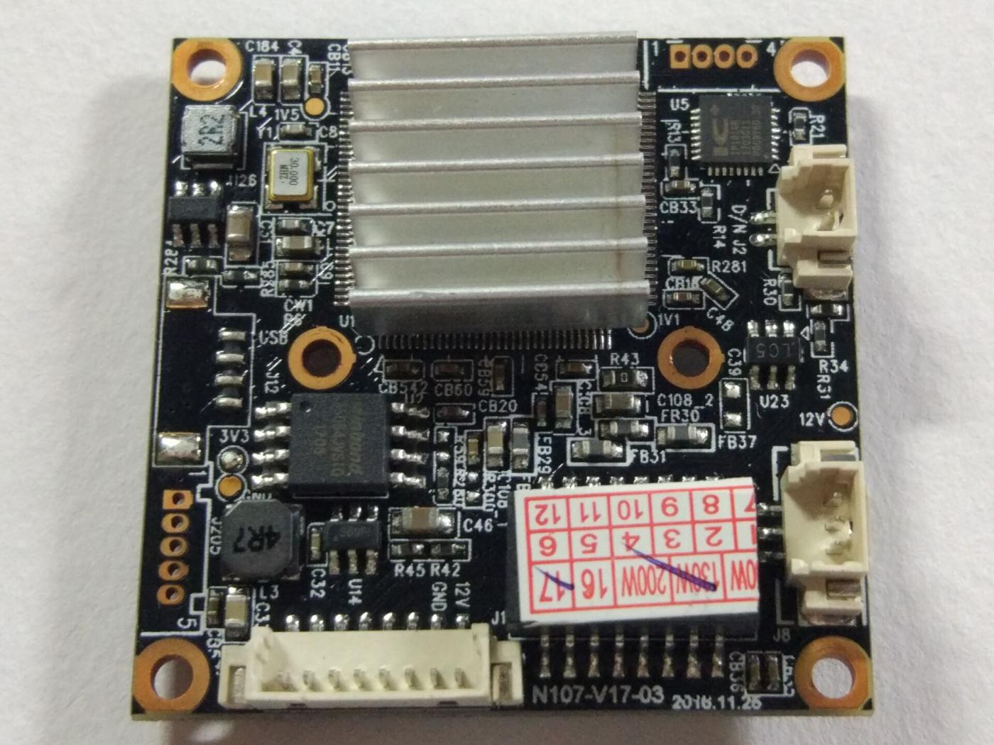

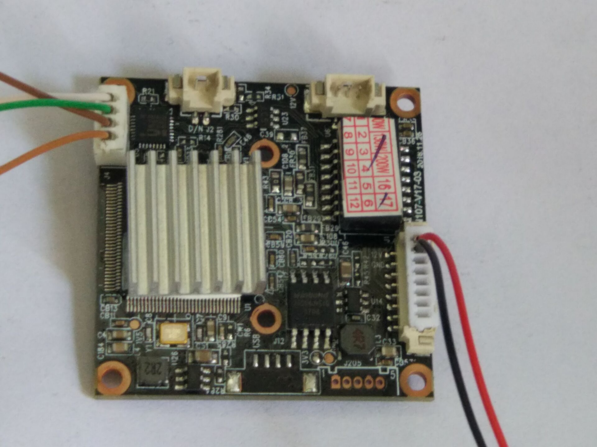

  1. 第一步当然是去淘宝买摄像头: 捷高智源升迈GM8135S 1135 130万960P大拿平台百万高清网络模组 目前39元.
  2. 焊上4pin串口端子,接上串口线.
  3. 接上网线端子,接入局域网, 下载软件,测试出厂固件和镜头。
  4. 下载GM8135s/GM8136s SDK(本站网友积分30以上可免费获取),编译下载.
  5. 烧录自产固件,开始愉快的DIY。

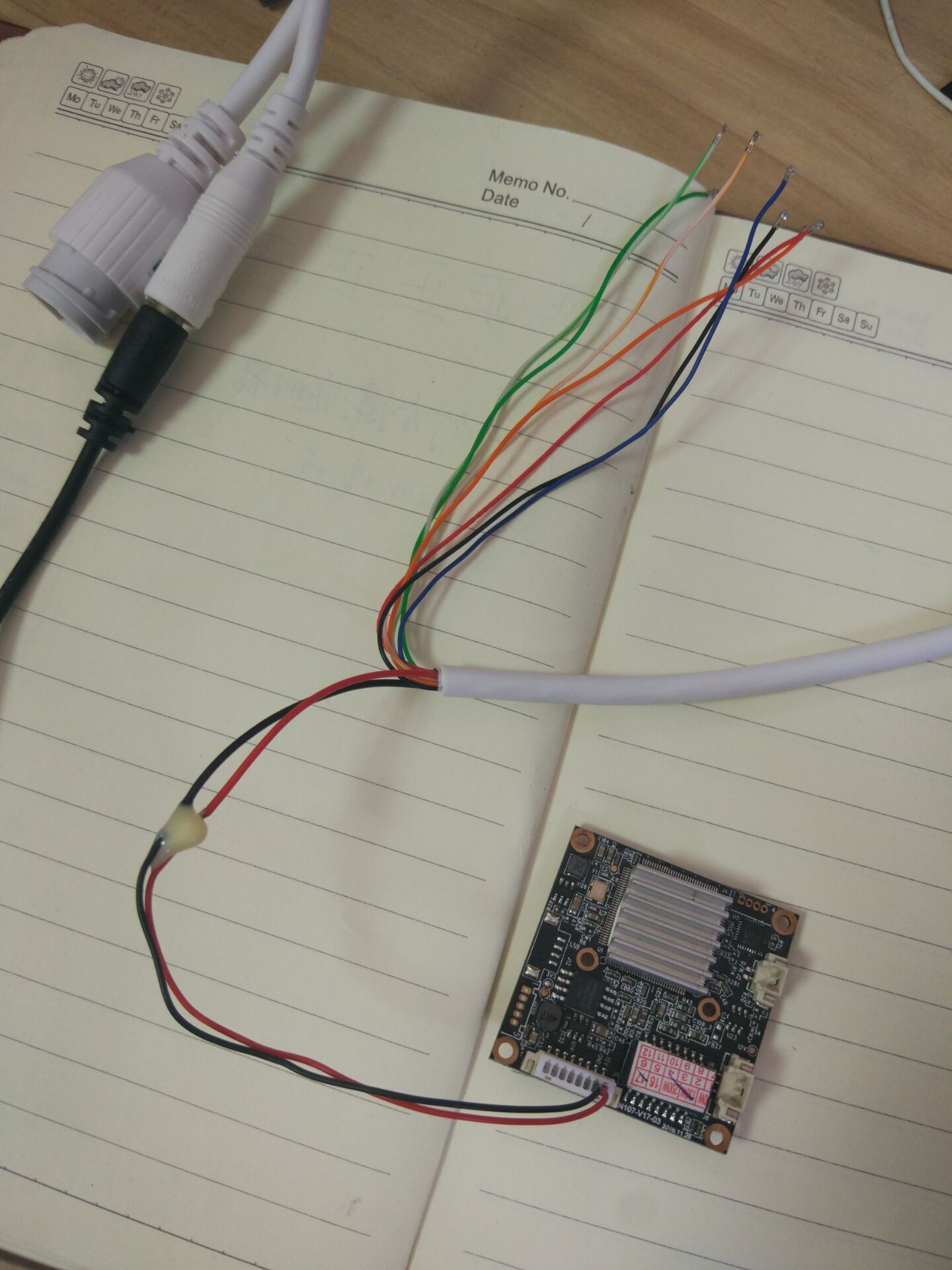

楼主 #3 2018-03-11 22:58:31
Re: GM8135s入坑记录
发现配送的线(电源和地线)与端子不匹配, 根本插不进去, 算了,改天再折腾.
楼主 #4 2018-03-12 14:35:04
Re: GM8135s入坑记录
终于把电源线给搞定了,
超级暖手宝,板子都是烫手的。
300mA@5V

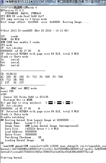

楼主 #5 2018-03-13 08:57:32
Re: GM8135s入坑记录
\0\0?\0\0鴡鏋鴨\0声mode 4
NSVersion V1.0.2
   STXWAMODE: RAO=0, STMWA=0
SPI NOR ID code:0xef 0x40 0x17
SPI jump setting is 3 bytes mode
Boot image offset: 0x10000. size: 0x40000. Booting Image .....
U-Boot 2013.01-svn4265 (Nov 03 2016 - 14:13:45)
I2C:   ready
DRAM:  64 MiB
ROM CODE has enable I cache
SPI mode
SF: Got idcodes
00000000: ef 40 17 00    .@..
SF: Detected W25Q64 with page size 64 KiB, total 8 MiB
flash is 3byte mode
In:    serial
Out:   serial
Err:   serial
AC: 200  HC: 200  P1: 712  P2: 600  P3: 540
C6: 712  DR: 950
J: 237   H1: 237
Net:   GMAC set RMII mode
reset PHY
eth0
  Sensor I2C Probe 0x60 is SC1135
  Bootargs Rtc is NONE
Hit any key to stop autoboot:  3  2  1  0
SF: Got idcodes
flash is 3byte mode
Disable watchdog!
## Booting kernel from Legacy Image at 02000000 ...
   Image Name:   Linux-3.3.0
   Data Size:    1425224 Bytes = 1.4 MiB
   Load Address: 00008000
   Entry Point:  00008000
   Verifying Checksum ... OK
   Loading Kernel Image ... OK
OK
: mem=64M gmmem=30M console=ttyS0,115200 user_debug=31 init=/squashfs_init root=/dev/mtdblock3 rootfstype=squashfs mtdparts=nor-flash:0x40000@0x10000(sf-bootloader),0x10000@0x50000(sf-bootenv),0x170000@0x60000(sf-kernel),0x210000@0x1D0000(sf-rootfs),0x370000@0x3E0000(sf-ipcfs),0xB0000@0x750000(sf-miscfs) sensor=SC1135 cpu=GM8135S ddr=SINGLE64M flash=SF rtc=NONE device_id=22000425146 ethaddr=00:66:78:06:7c:ba devinfo=jcoxa201704281b149fe11599f15e1be93fec5fe6366e000577h1ia8

把串口线焊上,电脑插入usb转ttl线,串口输出正常了.
从输出的日志来看,官网是这个了: http://www.cnjabsco.com/
