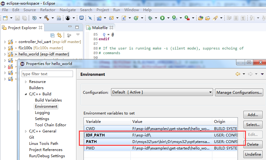

4. 打开elipse, 点击 File -> Import -> C/C++ -> Existing Code as Makefile Project,
找到 esp-idf 目录下面的 \examples\get-started\hello_world, 导入这个 hello_word项目,
右击项目, 在弹出的右击菜单里面选中最后一项Property.
在弹出的对话框中选择 C/C++ Build  -> Environment 添加一项:
IDF_PATH    ==>  F:\esp-idf\
修改PATH环境变量,添加: D:\msys32\usr\bin\;D:\msys32\opt\xtensa-esp32-elf\bin;D:\msys32\mingw32\bin;

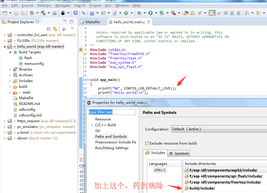

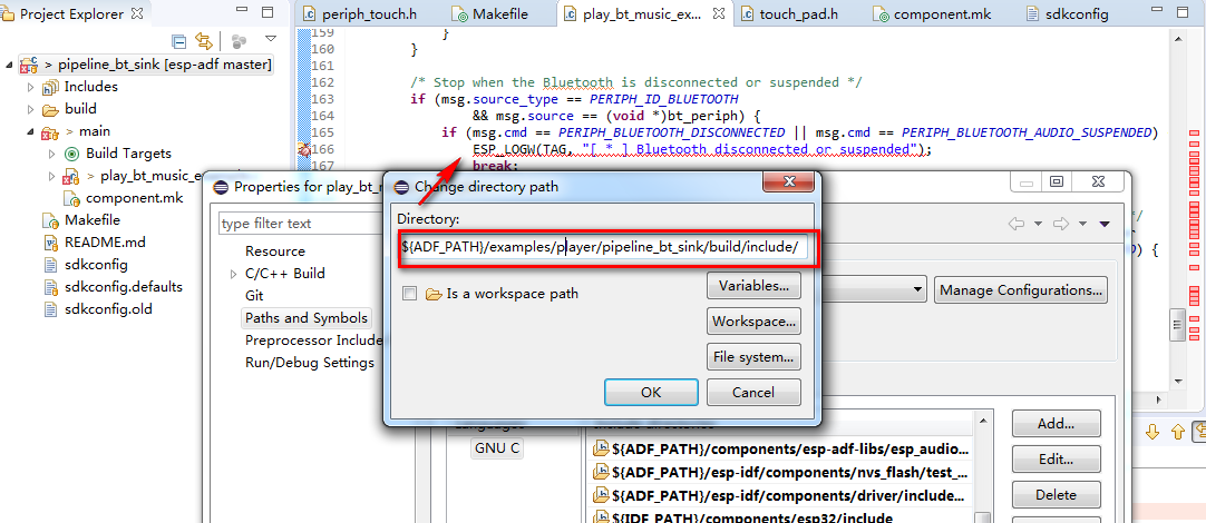

配置好头文件 之后,发现头文件 是没报错了,  但是 代码中 的一些宏 却还有 问题
例如 :  Symbol 'TOUCH_PAD_NUM9' could not be resolved
Symbol 'CONFIG_LOG_DEFAULT_LEVEL' could not be resolved
然后 在project >C/C++ index > Freshen All files  还是 没有解决 这个问题。
还专门查了一下 'TOUCH_PAD_NUM9'    在Touch_pad.h 下面,  于是 特意 加了#include "Touch_pad.h" 和对应的PATH。
但是 依然报错~~~~

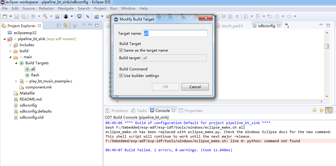

配置好 eclipse build 的时候 出错!

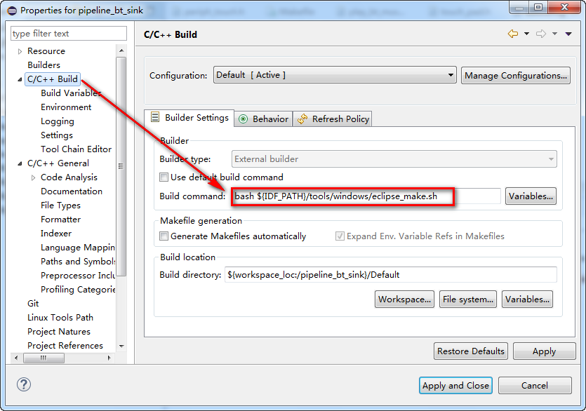

奇怪的是 怎么会跑去 找 F:\SysGCC\esp32\bin\python.exe:
15:46:48 **** Incremental Build of configuration Default for project pipeline_bt_sink ****
bash "F:\\Embedded\\esp-adf\\esp-idf/tools/windows/eclipse_make.sh" all
eclipse_make.sh has been replaced with eclipse_make.py. Check the Windows Eclipse docs for the new command.
This shell script will continue to work until the next major release.
      1 [main] python (5316) F:\SysGCC\esp32\bin\python.exe: *** fatal error - cygheap base mismatch detected - 0x612A2410/0x612E8408.
This problem is probably due to using incompatible versions of the cygwin DLL.
Search for cygwin1.dll using the Windows Start->Find/Search facility
and delete all but the most recent version.  The most recent version *should*
reside in x:\cygwin\bin, where 'x' is the drive on which you have
installed the cygwin distribution.  Rebooting is also suggested if you
are unable to find another cygwin DLL.
F:\Embedded\esp-adf\esp-idf/tools/windows/eclipse_make.sh: line 4:  5756 Segmentation fault      python ${IDF_PATH}/tools/windows/eclipse_make.py $@
15:46:51 Build Finished. 0 errors, 0 warnings. (took 2s.655ms)
楼主 #7 2018-05-02 16:47:10
已发帖子: 9,420
Re: 【ESP32视频分享2】Window 平台使用 Eclipse开发ESP32程序
下载会用到 Python,编译不会,
先用命令行试一试make是否正常吧。

试一试make  意思 是建立一个target 为 all 的, 然后进行build target 吗?  如图 也是显示一样的log ,找不到python。。。。
另外如果是在 toolchain 里面 进行make 倒是正常的~~~
我查看了get-started  guide 里面关于eclipse 的配置,其中C/C++build 配置目前有两个 版本
版本一:
•Click on the “C/C++ Build” properties page (top-level):
          .Uncheck “Use default build command” and enter this for the custom build command:
           python ${IDF_PATH}/tools/windows/eclipse_make.py.
版本二:
          bash ${IDF_PATH}/tools/windows/eclipse_make.sh.
两个版本最终都是 调用python 执行eclipse_make.py~~~~ 那其实 最终还是没有python 的问题吧~~~~
但奇怪 为什么toolchain 中make flash的时候 没见到用python~~~~

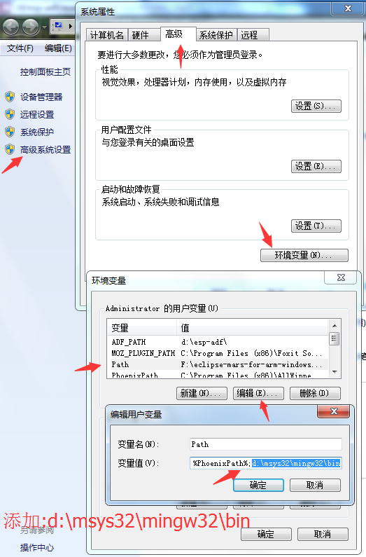

设置环境变量 PATH
export PATH=/mingw32/bin/:$PATH
上面是在msys里面添加 python.exe 所在的目录
你有没有把 D:\msys32\mingw32\bin\ 这个目录加到系统 PATH里面?

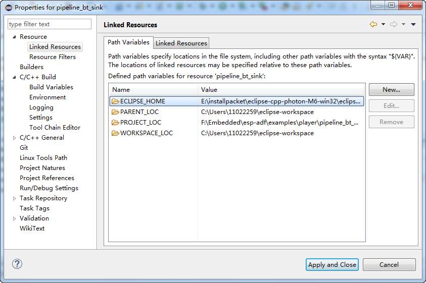

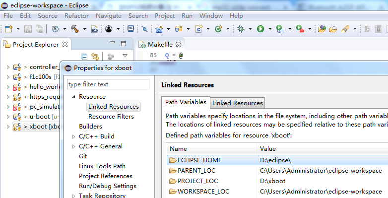

那新的问题又出现了, 就是 为啥 running  make  是在ECLIPSE_HOME 变量路径下呢???
这个没看懂
我的是这样, ECLIPSE_HOME 是指 eclipse.exe 所在的目录。
这个没看懂
https://whycan.cn/files/members/3/QQ20180503095142.png
我的这个路径 就是 eclipse.exe 的所在目录! 只是make 不是应该在工程文件下面进行吗?怎么跑到IDE 的路径下去呢?
楼主 #15 2018-05-03 11:19:38
已发帖子: 9,420
eclipse 和 make/Makefile 完全脱离关系,
他只会去调用存在 PATH 路径的 make.exe 去生成 文件,
与你在命令行下面的执行是一样的。
IDF_PATH    ==>  F:\\esp-idf\\
修改PATH环境变量,添加: D:\\msys32\mingw32\\bin\\;D:\msys32\usr\bin\;D:\\msys32\\opt\\xtensa-esp32-elf\\bin\\xtensa-esp32-elf-gcc.exe
按上面试一试
根据实际情况修改上面的路径。

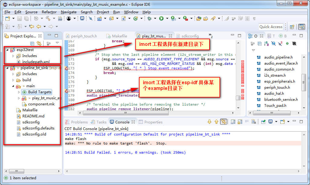

我尝试了一下, 主要是对比 import 工程时 exiting code location  选择了 自己新建的目录  还是选择 esp-idf 源代码 下 具体某个example的目录
选择了自己新建的目录 =====》 你会发现 工程配置好之后 没有 .c 源文件 也没有make 文件~~~~
选择esp-idf 源代码 下 具体某个example的目录 =====》 工程配置好之后,有对应的 .c源文件 有对应make 文件, 但是这种做法 非常不好, 这样不是污染了源代码?  不过 那个.c 文件 说实在 也是应用层的 东西,污染也就污染了~~~
现在按照要求一步步下来, 依然 存在两个问题:
1.  build 的时候 显示 一切的 target  都不存在 rule  无论 是clean  flash  all,  但是在msys32 窗口下 一切又是正常的
2.  所有相关的头文件 以及路径都 设置好之后,   ESP_LOGI  这个宏 依然 显示 Symbol 'CONFIG_LOG_DEFAULT_LEVEL' could not be resolved , 即便我重新 建立索引  也不行~~~
https://whycan.cn/files/members/3/QQ20180503143902.png
按上面试一试
根据实际情况修改上面的路径。
第一 : 为什么你的路径 有些是双 \\ 杆??  有些又不用???
第二 : PATH 中xtensa-esp32-elf 路径 要精确到 xtensa-esp32-elf-gcc.exe  吗?
第三 : 我设置的PATH是  F:\msys32\usr\bin;F:\msys32\mingw32\bin;F:\msys32\opt\xtensa-esp32-elf\bin
           IDF_PATH :  F:/Embedded/esp-adf/esp-idf
           ADF_PATH:  F:/Embedded/esp-adf
           还有一个 BATCH_BUILD : 1
           另外 Tool chain editor 选择的是:  Cygwin C
但是build 的时候 还是显示
14:43:15 **** Build of configuration Default for project pipeline_bt_sink ****
make flash
make: *** No rule to make target 'flash'.  Stop.
14:43:16 Build Failed. 1 errors, 0 warnings. (took 755ms)
最近编辑记录 mkseven32 (2018-05-03 14:48:38)

\\ 是为了防止 bug, 有些软件直接把字符串给了 C语言, 然后就出现了解析路径错误,多加一个斜杠不会错,更保险一点。
https://whycan.cn/files/members/853/ee.png
1) eclipse的工程其实是解析Makefile文件生成的,你的Makefile文件不存在,当然工程里面没有文件.
2) 不会污染,eclipse实际上还是调用 make/Makefile
3) Symbol 'CONFIG_LOG_DEFAULT_LEVEL' could not be resolved 这个问题还不清楚什么原因。
楼主 #24 2018-05-03 14:50:23
已发帖子: 9,420
你要把 build/include/ 添加到 【Paths & Symbols】
应该可以解决
这个问题.
因为 ./build/include/sdkconfig.h :
#define CONFIG_LOG_DEFAULT_LEVEL 3
====>  没有 你看看 实际有两个工程, 我只是对比一下 在import 工程时 选择的路径不同时的区别,
如果选择 esp-idf源码 目录下 example 时  是有make 文件  和 .c 源码的
====> 我说的污染 是指,esp-idf 源代码包 下载下来之后,按这样新建工程的逻辑, 后面编程时 就是直接修改 源代码包,稍微有点污染的 意味
=====> 您建好的工程  没有这个问题?
应该可以解决
这个问题.
这个build/include/ 是指在【Paths & Symbols】下的GNU  C ===》 include 添加 本工程目录 吗? (即 ${ADF_PATH}/examples/player/pipeline_bt_sink/build/include/ )
还是 直接添加  build/include/  ????
不过两种 我都试了  , 都不可以!!! 如图所示

晕哥我想问一哈,windows搭建eclipse环境,build target里make flash能把工程烧入到开发板里面,但是这个工程在eclipse编译会出现这个问题是咋回事咩?就点一下build all或者clean都会这样。。这样不就不能debug代码了嘛。。要咋配置。。。新人刚入坑求指点
16:27:29 **** Incremental Build of configuration Default for project esp ****
bash "C:\\msys32\\home\\Administrator\\esp\\esp-idf/tools/windows/eclipse_make.sh" all
make: *** No rule to make target 'all'.  Stop.
Running make in 'C:/msys32/home/Administrator/esp'
16:27:29 Build Failed. 1 errors, 0 warnings. (took 358ms)

感觉是环境没配置好.
