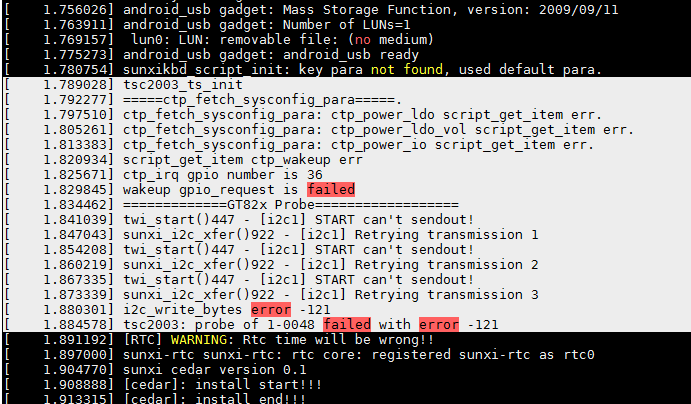

楼主 #3 2018-03-30 08:35:29
已发帖子: 9,524
Re: 【海豚派】解决海豚派自带SDK, 触摸校正程序ts_calibrate 无法正常工作的问题
经过海豚派Q群群友 向日葵 大神提醒:
tslib\tests\fbutils.c文件的260行修改一下
编译重新生成img.
屏幕显示果然正常了,但是触摸还是不行。
楼主 #4 2018-03-30 08:38:12
已发帖子: 9,524
跟踪linux的启动log, 发现 TSC2003触摸芯片检测不正常:
[ 1.789028] tsc2003_ts_init
[ 1.792277] =====ctp_fetch_sysconfig_para=====.
[ 1.797510] ctp_fetch_sysconfig_para: ctp_power_ldo script_get_item err.
[ 1.805261] ctp_fetch_sysconfig_para: ctp_power_ldo_vol script_get_item err.
[ 1.813383] ctp_fetch_sysconfig_para: ctp_power_io script_get_item err.
[ 1.820934] script_get_item ctp_wakeup err
[ 1.825671] ctp_irq gpio number is 36
[ 1.829845] wakeup gpio_request is failed
[ 1.834462] =============GT82x Probe==================
[ 1.841039] twi_start()447 - [i2c1] START can't sendout!
[ 1.847043] sunxi_i2c_xfer()922 - [i2c1] Retrying transmission 1
[ 1.854208] twi_start()447 - [i2c1] START can't sendout!
[ 1.860219] sunxi_i2c_xfer()922 - [i2c1] Retrying transmission 2
[ 1.867335] twi_start()447 - [i2c1] START can't sendout!
[ 1.873339] sunxi_i2c_xfer()922 - [i2c1] Retrying transmission 3
[ 1.880301] i2c_write_bytes error -121
[ 1.884578] tsc2003: probe of 1-0048 failed with error -121

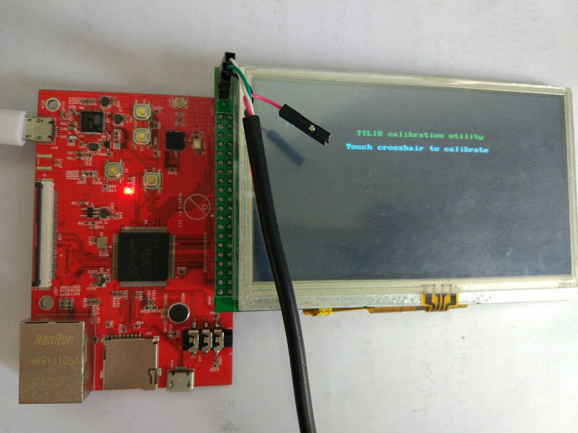

楼主 #6 2018-03-30 09:40:29
已发帖子: 9,524
arch\arm\mach-sunxi\sun8i.c的506行改一下
向日葵大神再次出手相救
改完之后
export TSLIB_TSDEVICE='/dev/input/event1'
ts_calibrate
一切OK
