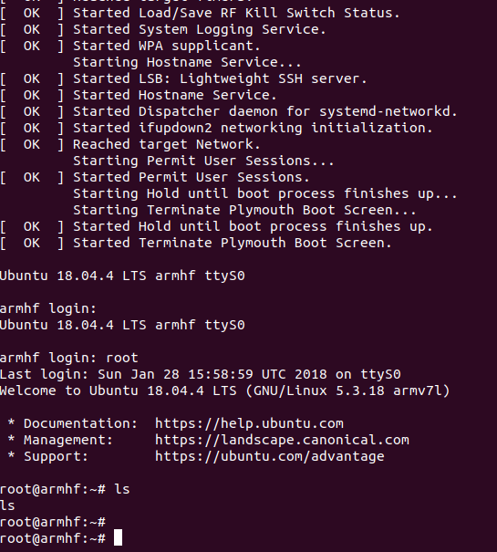

#5 2020-03-14 18:57:37
Re: Allwinner S3 Ubuntu Minimal 18.04.4 LTS 镜像
AaronHo wrote:
试过了系统可以跑起来。
/files/members/3338/Selection_001.png
