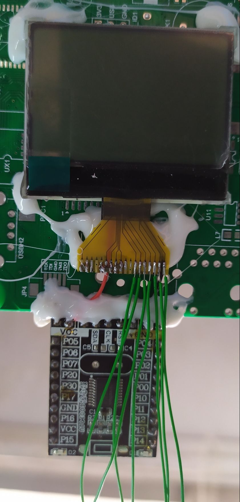

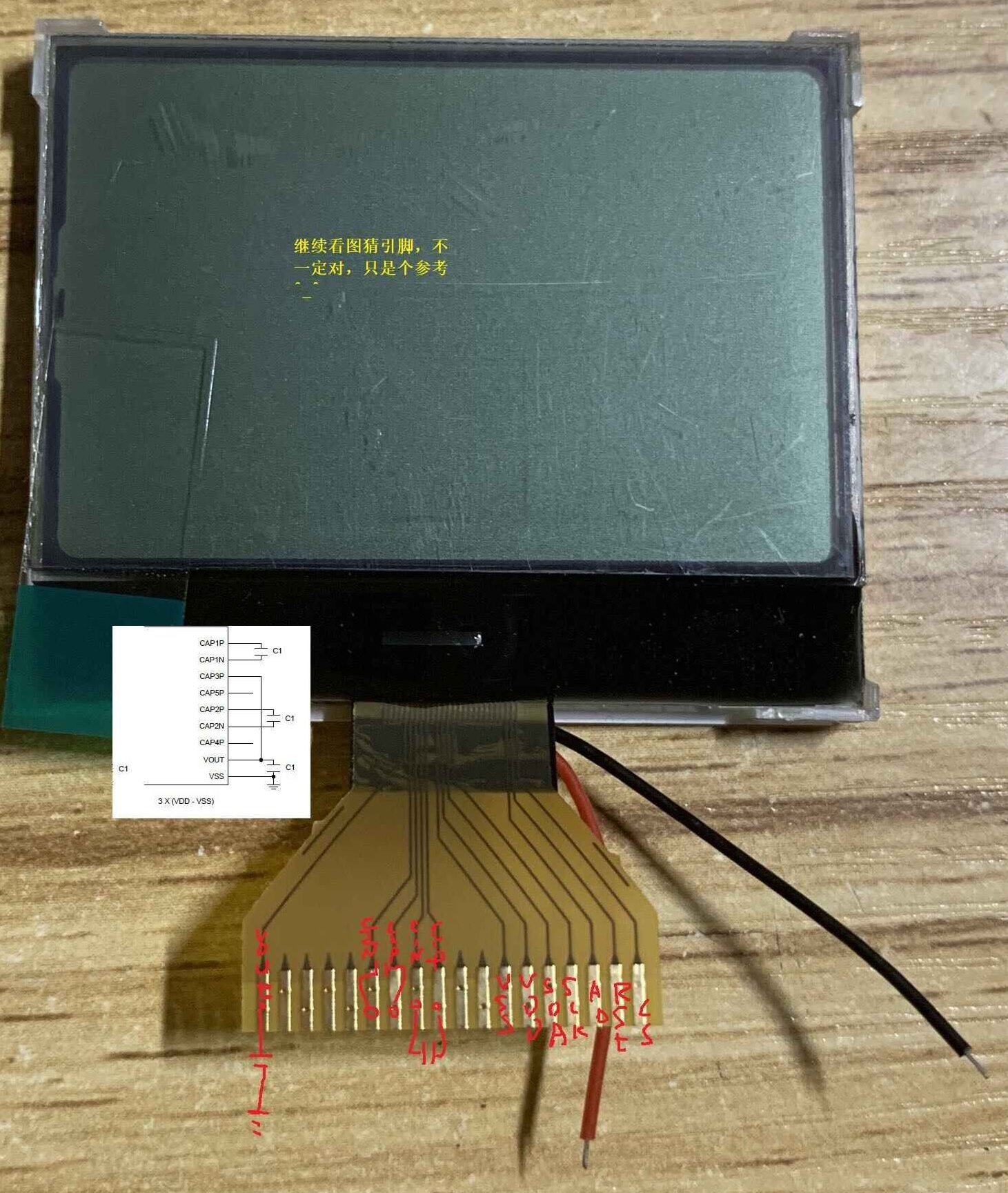

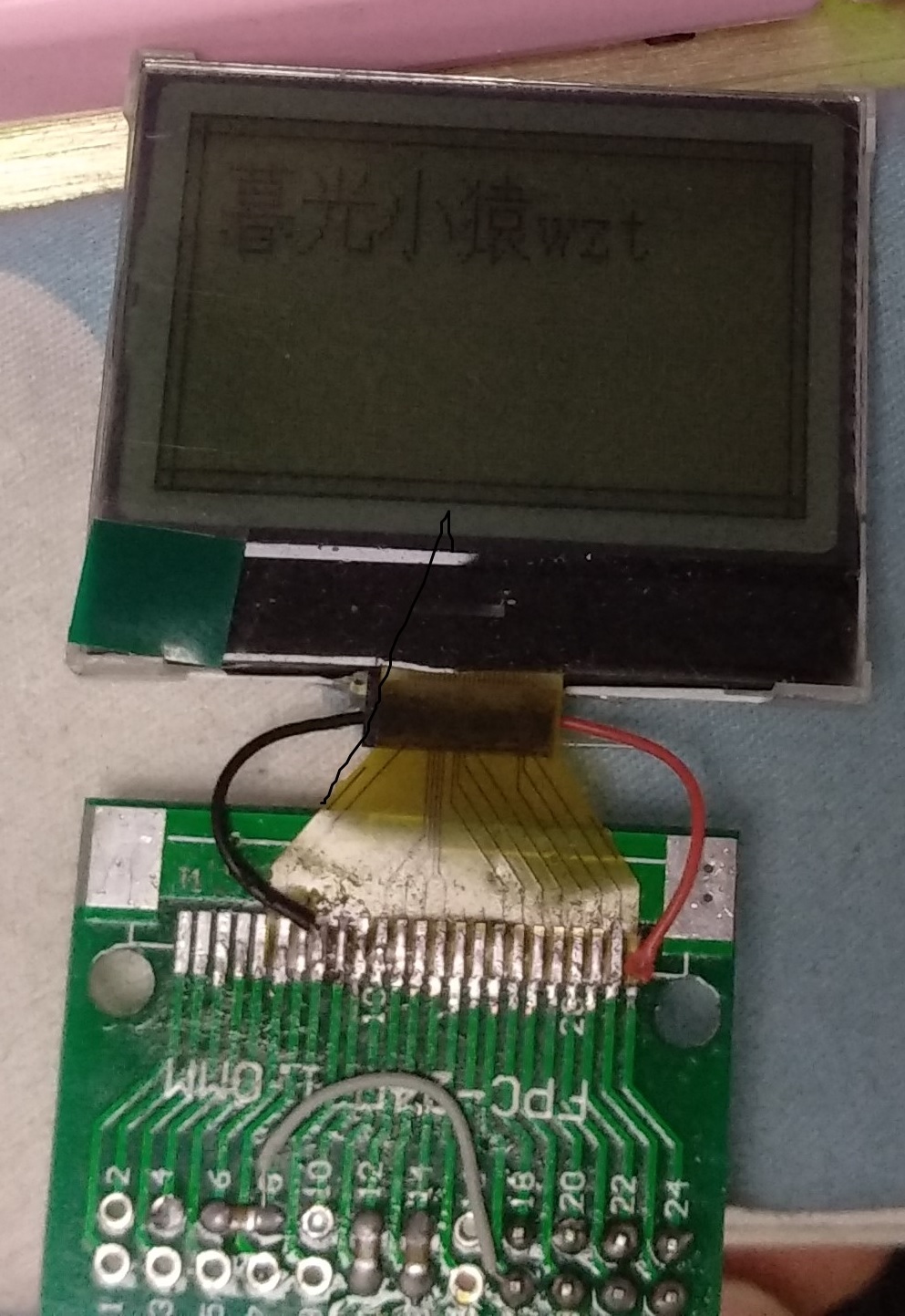

楼主 #1 2019-07-12 16:51:08
1.7寸12864液晶屏 st7565驱动芯片 带背光
1.7寸12864液晶屏 st7565驱动芯片 无型号 带背光: https://item.taobao.com/item.htm?id=596766414771

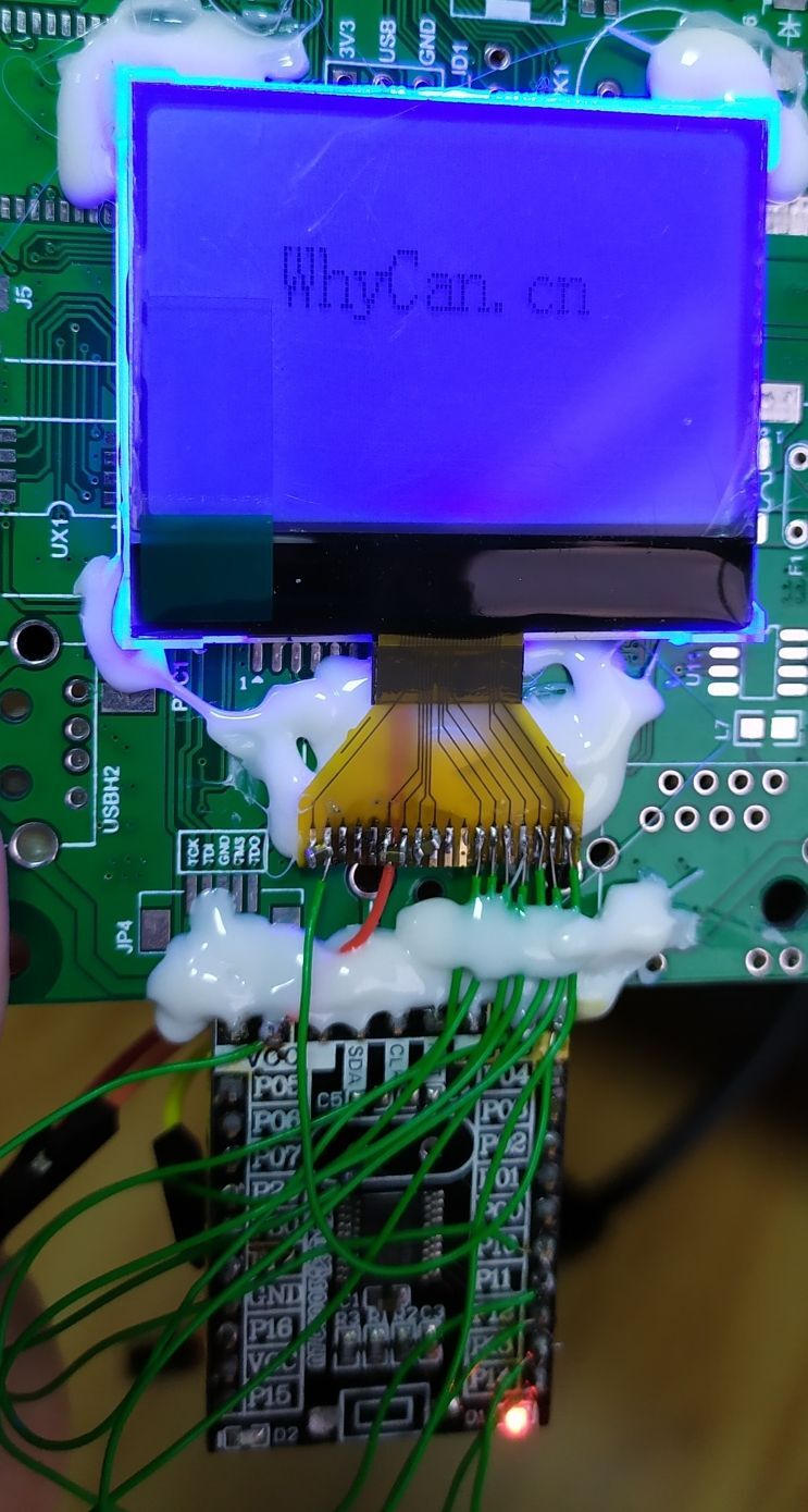

楼主 #5 2019-07-15 11:13:26
Re: 1.7寸12864液晶屏 st7565驱动芯片 带背光
#include "N76E003.h"
#include "SFR_Macro.h"
#include "Function_define.h"
#include "Common.h"
#include "Delay.h"
#include "intrins.h"
#include "ST7565.h"
#include "LCDFont.h"
#define Page0    0xb0  //第0页地址
#define Page_max   0xb8  //最大页地址,第8页
#define Column_h   0x10  //列地址(高位)
#define Column_l   0x00  //列地址(低位)
//--------------------------------------------------------- 4线SPI接口
sbit    SDO     =   P1^0;//串行数据           AAAAAAAAA
sbit	SCLK    =   P1^1;//串行时钟
sbit    CD      =   P1^2;//命令/数据切换 AAAAAAAA
sbit    RSTB    =   P1^3;
sbit    CS0     =   P1^4;//片选信号
//清屏函数
void clear_screen(uchar xx)
    uchar i,j;
    for(i=0;i<8;i++)
        CS0=0;
        Write_ST7567_COM(0xb0+i);	 //SET PAGE 0---8
        Write_ST7567_COM(0x10);	 //SET COLUMN MSB
        Write_ST7567_COM(0x00);	  //SET CLUMN LSB
        for(j=0;j<128;j++)
            Write_ST7567_DATA(xx);
//显示图片函数
void Display_pic1()
    uint i,j,adressd=0;
    for(i=0;i<8;i++)
        CS0=0;
        for(j=0;j<96;j++)
            Write_ST7567_DATA(graphic1[adressd]);
            adressd++;
//写命令函数
void Write_ST7567_COM(uchar COMDADA_4SPI)
    uchar bit8;
    CD=0;
    CS0=0;
    for(bit8=0;bit8<8;bit8++)
        SCLK=0;
        if((COMDADA_4SPI&0x80)==0x80)
        SDO=1;
        else
        SDO=0;
        //		SCL=0;
        SCLK=1;
        COMDADA_4SPI=(COMDADA_4SPI<<1);
    //  CS1=1;
//写数据函数
void Write_ST7567_DATA(uchar DATA_4SPI)
    uchar bit8;
    CD=1;
    CS0=0;
        SCLK=0;
        if((DATA_4SPI&0x80)==0x80)
        SDO=1;
        else
        SDO=0;
        SCLK=1;
        DATA_4SPI=(DATA_4SPI<<1);
    //	CS1=1;
//软件延时(不怎么准
void Delay_ms(unsigned long value)
	uint i,j;
    for (i=0;i<value;i++)
		for (j=0;j<500;j++);
//硬件复位函数
void HDReset()
	RSTB=0;
	Delay_ms(2);
	RSTB=1;
	Delay_ms(4);
////函数名称:WRITE_STRING(uchar plat,uchar column,uchar xs,uchar chr, uchar c)
////函数功能:显示字符
////输入参数:plat      行地址
////输入参数:column    列地址
////输入参数:chr    显示数值
////输入参数:fs   显示方式(0,反显,否则正常显示)
////返 回 值:无
void WRITE_STRING(uchar plat, uchar column, uchar chr, uchar fs)
    uchar page,page1,col,col_h,col_l;
    uchar i,a,j=0;
    page1= plat*2;
    page=page1+Page0;
    col=column*8;
    col_h=((col>>4)|0xf0)&0x1f;
    col_l=col&0x0f;
    chr=chr-' ';//得到偏移后的值
    for(a = 0; a <2; a++)
        Write_ST7567_COM(col_h);
        Write_ST7567_COM(col_l);
        Write_ST7567_COM(page+a);
        for(i = 0;  i <8; i ++ )
            if(fs == 0){Write_ST7567_DATA(s0[chr][j++]);}
            if(fs == 1){Write_ST7567_DATA(~(s0[chr][j++]));}
////函数名称:Disp_Nub8X16(uchar Row,uchar Col,uchar Number,uchar fs)
////函数功能:将数据显示出来
////输入参数:low       行地址
////输入参数:Col      列地址
////输入参数:Number    显示数值
////返 回 值:无
void Disp_Nub8X16(uchar Row,uchar Col,uchar Number,uchar fs)
	uchar page,page1,col,col_h,col_l,chr;
	uchar i,a,j=0;
	page1=Row*2;
	page=page1+Page0;
	col=Col*8;
	col_l=col&0x0f;
	if(Number<11)//十进制数据
		chr=Number+16;
	else//十六进制数据
		chr=Number-32;
//清屏函数
void Lcd12864_ClearScreen(void)
	uchar i, j;
	for(i=0; i<8; i++)
		Write_ST7567_COM(0xB0+i);
		for(j=0; j<128; j++)
			Write_ST7567_DATA(0x00);
////函数名称:Init_ST7567()
////函数功能:初始化液晶屏
////输入参数:无
////返 回 值:无
////		TIPS:命令符见ST7567数据手册
void Init_ST7567()
    HDReset();//硬复位
    Timer0_Delay1ms(100);
    Write_ST7567_COM(0xe2);//软复位
    Write_ST7567_COM(0xaf);//0xaf显示器开
    Write_ST7567_COM(0x2f);//0x2f升压电路,电压管理电路,
    Write_ST7567_COM(0x25);//0x20-0x27为V5电压内部电阻调整设置
    Write_ST7567_COM(0x81);// SET EV 调对比度
    Write_ST7567_COM(0x18);//0x01-0x3f电量寄存器设置模式
    Write_ST7567_COM(0xa0);//0xa0为Segment正向,0xa1 为Segment反向
    Write_ST7567_COM(0xc8);//0xc0正向扫描,0xc8反射扫描
    Write_ST7567_COM(0xa6);//0xa6正向显示,0xa7反向显示
    Write_ST7567_COM(0xa4);//0xa4正常显示,0xa5全屏点亮
    Write_ST7567_COM(0xf8);//背压比设置
    Write_ST7567_COM(0x00);//00--10
    Lcd12864_ClearScreen();//清屏
void main(void)
    Set_All_GPIO_Quasi_Mode;
    Init_ST7567();
    //Disp_Nub8X16(0, 0, 3, 0);
    WRITE_STRING(1, 0 + 3, 'W', 0);
    WRITE_STRING(1, 1 + 3, 'h', 0);
    WRITE_STRING(1, 2 + 3, 'y', 0);
    WRITE_STRING(1, 3 + 3, 'C', 0);
    WRITE_STRING(1, 4 + 3, 'a', 0);
    WRITE_STRING(1, 5 + 3, 'n', 0);
    WRITE_STRING(1, 6 + 3, '.', 0);
    WRITE_STRING(1, 7 + 3, 'c', 0);
    WRITE_STRING(1, 8 + 3, 'n', 0);
    while(1);

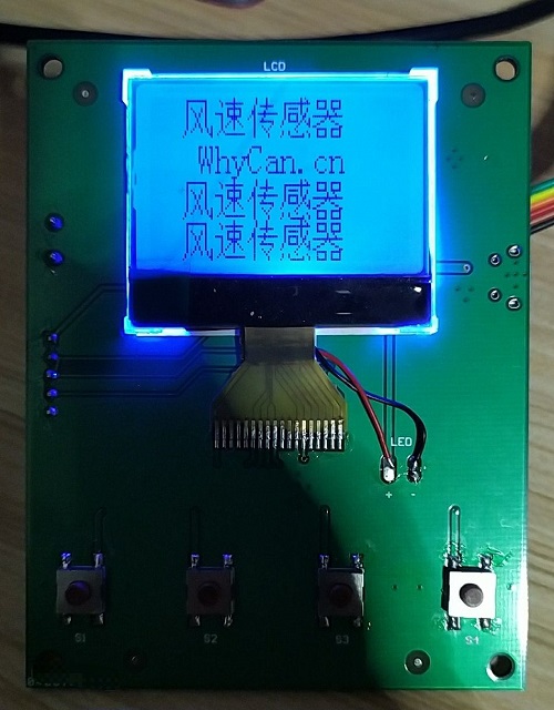

#7 2020-04-30 17:08:45
lgsapce
注册时间: 2020-04-30
正在学习这个,中文怎么显示?
#8 2020-04-30 17:17:08
已发帖子: 3,410
积分: 1907
lgsapce wrote:
正在学习这个,中文怎么显示?
电脑字模软件把字符生成数组, 然后把这个数组拷贝到显示缓冲区就可以了。
可以参考这个帖子: https://whycan.cn/t_982.html
#9 2020-04-30 17:21:19
lgsapce
注册时间: 2020-04-30
我试试,谢谢啦。
#10 2020-05-05 15:06:33
ludechan
注册时间: 2020-03-11
显示坐标图有什么方法?修改整屏显示缓存,定时刷新?
#11 2020-05-05 15:10:02
有梦的地方
已发帖子: 284
积分: 284
对,一般都是这么做的。
