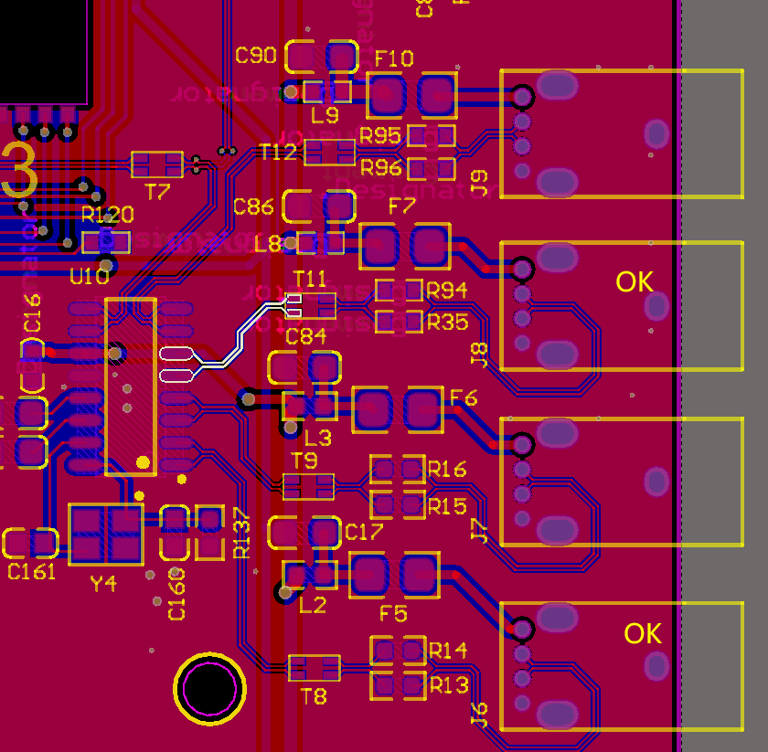

A33接SL2.1 USB HUB芯片, 扩展出来的四个口接U盘都可以, 但是有两个口接AIR720 4G模块出错
SL2.1 USB HUB这里买的: https://item.szlcsc.com/225853.html
第一个,第三个口插入AIR720提示是这样的:
[ 7148.309254] usb 1-1-port1: Cannot enable. Maybe the USB cable is bad?
[ 7149.499258] usb 1-1-port1: Cannot enable. Maybe the USB cable is bad?
[ 7150.689255] usb 1-1-port1: Cannot enable. Maybe the USB cable is bad?
[ 7151.879253] usb 1-1-port1: Cannot enable. Maybe the USB cable is bad?
[ 7151.885893] usb 1-1-port1: unable to enumerate USB device
第二个,第四个口插入AIR720提示是这样的:
[ 7407.579072] usb 1-1.2: new high-speed USB device number 37 using ehci-platform
[ 7407.736996] rndis_host 1-1.2:1.0 eth1: register 'rndis_host' at usb-1c1a000.usb-1.2, RNDIS device, ac:1f:e8:ad:df:e0
[ 7407.802040] option 1-1.2:1.2: GSM modem (1-port) converter detected
[ 7407.843663] usb 1-1.2: GSM modem (1-port) converter now attached to ttyUSB0
[ 7407.861566] option 1-1.2:1.3: GSM modem (1-port) converter detected
[ 7407.894022] usb 1-1.2: GSM modem (1-port) converter now attached to ttyUSB1
[ 7407.911665] option 1-1.2:1.4: GSM modem (1-port) converter detected
[ 7407.944312] usb 1-1.2: GSM modem (1-port) converter now attached to ttyUSB2

神奇了, 四个口都能接HUB, 然后AIR720接HUB上面都可以识别, 而且四个口都可以, 常理无法解释.

四个口都能识别 FT232RL 的 RS485 线, CP2104串口模块.

恭喜踩坑里了,看你的打印信息就是用的OTG那一路的USB吧,那个USB不支持ehci模式,可用端点就5个,另外一路USB是正常的,你可以飞线试试,目前只看到A64是支持两路都带ehci

我怎么感觉和可用端点没关系呢?楼主是四个扩展的usb两个可以用air720,两个不可以用air720,
但是四个口都可以接u盘,接ft232,cp2104串口芯片啊。
