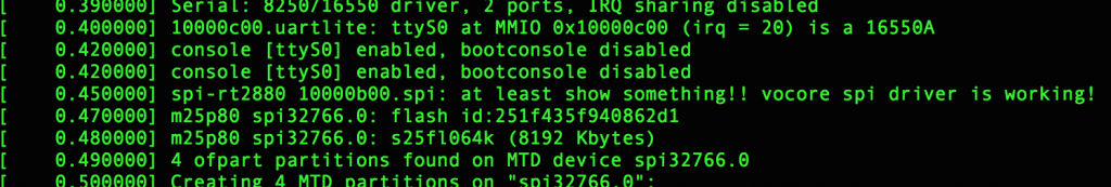

楼主 #1 2020-04-30 14:30:07
已发帖子: 3,389
修改Linux驱动显示Winbond W25Q64/W25Q128/W25Q256/W25Q512等flash的唯一Id(Unique Id
原帖地址: http://vonger.cn/?p=931
楼主 #2 2020-04-30 14:30:38
已发帖子: 3,389
Re: 修改Linux驱动显示Winbond W25Q64/W25Q128/W25Q256/W25Q512等flash的唯一Id(Unique Id
修改后的代码: http://vonger.cn/upload/m25p80.c

VoCore: SPI Flash Unique ID
SPI microSD is not done yet ? Just finish an easy driver patch.
This patch is used to get unique id from flash chip. That id is also VoCore Unique ID(unless you change the flash chip). It will be used to get back factory setting(include mac address, wifi parameter, etc.) If you change the flash partition “factory”(512 bytes) and want to change it back. That factory setting can be downloaded from this site by this VoCore Unique ID.
Download new driver file m25p80.c
diff the origin m25p80.c and my m25p80.c

Part of bootup log:
This is tested by using winbond flash, but from read other chip datasheet, this is supported too.
Now the openwrt is compiled under mac ? I do not have to use linux vm anymore. This makes the process a little faster. Thanks Markus Z for the tip, http://vocore.freshdesk.com/support/discussions/topics/1000033335
PS: there is a small bug in m25p80.c, jedec id of s25fl064k and w25q64 are same. w25q64(Winbond) jedec id is correct, so s25fl064k(Spansion) has a wrong id in the source. Is there anybody know its real jedec id? We should fix that little bug in linux kernel.
