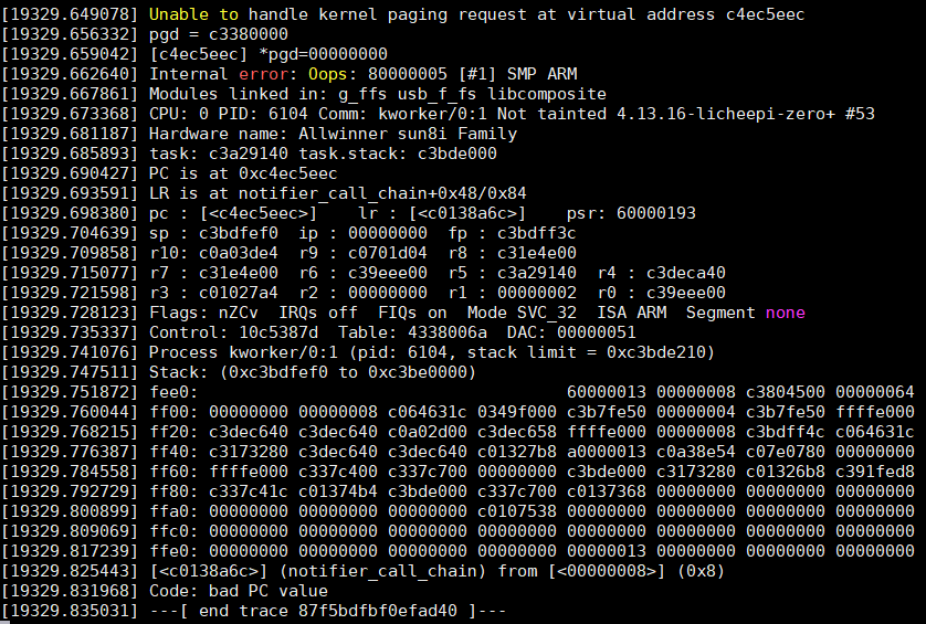

V3s Linux 应用程序跑了7个小时挂了, 请大家帮我把把脉.
[19329.649078] Unable to handle kernel paging request at virtual address c4ec5eec
[19329.656332] pgd = c3380000
[19329.659042] [c4ec5eec] *pgd=00000000
[19329.662640] Internal error: Oops: 80000005 [#1] SMP ARM
[19329.667861] Modules linked in: g_ffs usb_f_fs libcomposite
[19329.673368] CPU: 0 PID: 6104 Comm: kworker/0:1 Not tainted 4.13.16-licheepi-zero+ #53
[19329.681187] Hardware name: Allwinner sun8i Family
[19329.685893] task: c3a29140 task.stack: c3bde000
[19329.690427] PC is at 0xc4ec5eec
[19329.693591] LR is at notifier_call_chain+0x48/0x84
[19329.698380] pc : [<c4ec5eec>]    lr : [<c0138a6c>]    psr: 60000193
[19329.704639] sp : c3bdfef0  ip : 00000000  fp : c3bdff3c
[19329.709858] r10: c0a03de4  r9 : c0701d04  r8 : c31e4e00
[19329.715077] r7 : c31e4e00  r6 : c39eee00  r5 : c3a29140  r4 : c3deca40
[19329.721598] r3 : c01027a4  r2 : 00000000  r1 : 00000002  r0 : c39eee00
[19329.728123] Flags: nZCv  IRQs off  FIQs on  Mode SVC_32  ISA ARM  Segment none
[19329.735337] Control: 10c5387d  Table: 4338006a  DAC: 00000051
[19329.741076] Process kworker/0:1 (pid: 6104, stack limit = 0xc3bde210)
[19329.747511] Stack: (0xc3bdfef0 to 0xc3be0000)
[19329.751872] fee0:                                     60000013 00000008 c3804500 00000064
[19329.760044] ff00: 00000000 00000008 c064631c 0349f000 c3b7fe50 00000004 c3b7fe50 ffffe000
[19329.768215] ff20: c3dec640 c3dec640 c0a02d00 c3dec658 ffffe000 00000008 c3bdff4c c064631c
[19329.776387] ff40: c3173280 c3dec640 c3dec640 c01327b8 a0000013 c0a38e54 c07e0780 00000000
[19329.784558] ff60: ffffe000 c337c400 c337c700 00000000 c3bde000 c3173280 c01326b8 c391fed8
[19329.792729] ff80: c337c41c c01374b4 c3bde000 c337c700 c0137368 00000000 00000000 00000000
[19329.800899] ffa0: 00000000 00000000 00000000 c0107538 00000000 00000000 00000000 00000000
[19329.809069] ffc0: 00000000 00000000 00000000 00000000 00000000 00000000 00000000 00000000
[19329.817239] ffe0: 00000000 00000000 00000000 00000000 00000013 00000000 00000000 00000000
[19329.825443] [<c0138a6c>] (notifier_call_chain) from [<00000008>] (0x8)
[19329.831968] Code: bad PC value
[19329.835031] ---[ end trace 87f5bdfbf0efad40 ]---

内存泄漏?

@checkout 我也有点感觉内存泄漏, 这个VSZ不断增长.

请教了大佬, 叫我用 valgrind 工具测试内存泄露, 试了一下, 不知道如何看结果.
另外一个大佬说, 逐步屏蔽代码, 然后我看最有嫌疑的就是 libcurl 部分, 然后就屏蔽了,
现在VSZ已经不增长了:

这个还真不好查,只能不断在程序里打印日志,监测所有的怀疑的问题,一点点缩小范围,还有就是程序一点点屏蔽试试

达克罗德 说:
libcurl一般用来干什么的
在程序中post http/https 数据,
我是照抄libcurl最新例程,而且每次调用都释放了全部资源,没想到还是这样,最后我通过 system 函数调用 curl 命令发送数据,跑了一晚,目前还没有死机,感谢大家热心回复。
