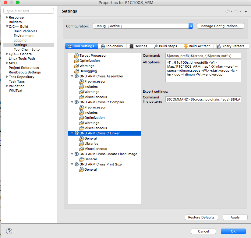

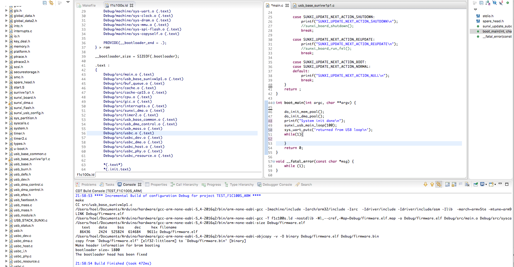

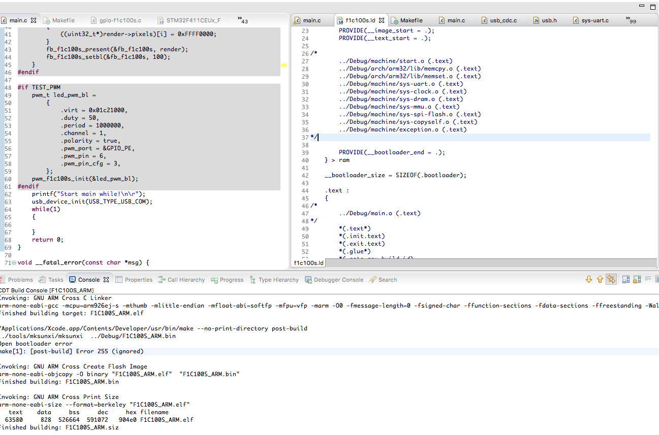

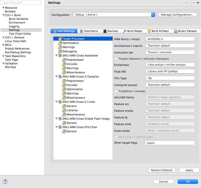

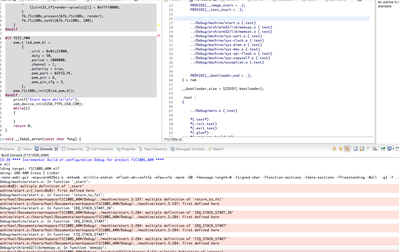

The USB stack already has the interrupt framework. I fear It will take a lot of efforts to adapt the USB stack to xboot, i want to avoid that, the stack is already working standalone, the only adaptation is the f1c100s.ld linker file. I made good progress yesterday, now the Eclipse project can compile and produce the .hex and .bin, the only remaining problem is to adapt the linker file f1c100s.ld, because currently it includes some object fils (.0) and Eclipse is not happy about it ("multiple definition of ..." error).
If i comment the included .o files in f1c100s.ld then the linking is successful.
USB堆栈已具有中断框架。 恐怕要使USB堆栈适应xboot会花费很多精力,我想避免这种情况,该堆栈已经可以独立工作,唯一的适应是f1c100s.ld链接器文件。 我昨天取得了良好的进展,现在Eclipse项目可以编译并生成.hex和.bin,唯一剩下的问题是改编链接器文件f1c100s.ld,因为当前它包含一些对象fils(.0),而Eclipse没有。 很高兴(“ ...的多个定义”错误)。
如果我注释了包含的.o文件,则链接成功。

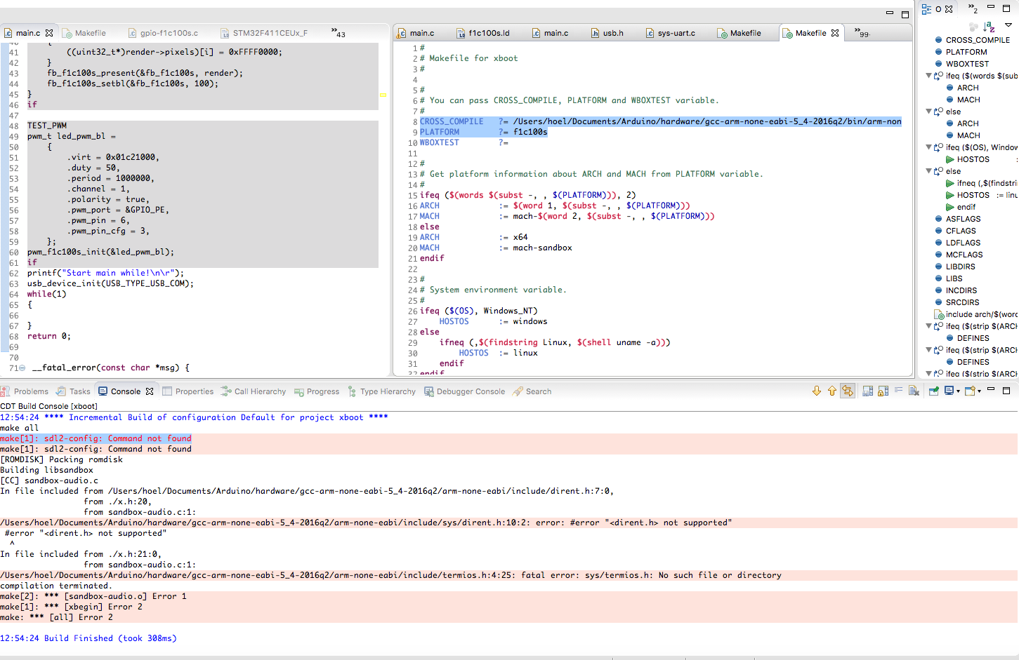

下载了官方文件,打开了Eclipse项目,设置PLATFORM和CROSS_COMPILE,甚至无法构建...
#6 2020-05-29 20:41:44
已发帖子: 3,392
Re: 裸机F1C100S,USB HOST + DMA,Eclipse,链接器和启动文件需要帮助
改为:
PLATFORM ?=arm32-f1c100s

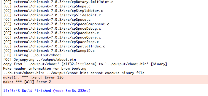

解决了第一个问题,我在macos上,所以我添加了mksunxi,但是仍然存在MKZ问题,提供的版本仅在linux上有效,无法在macos上执行,并且未提供源文件。 应该提供MKZ的源文件和makefile,以便我们至少可以在macOS上构建它
copy from `../output/xboot' [elf32-littlearm] to `../output/xboot.bin' [binary]
Make header information for brom booting
bootloader size= 2200
The bootloader head has been fixed
/bin/sh: arch/arm32/mach-f1c100s/tools/linux/mkz: cannot execute binary file
make[1]: *** [xend] Error 126
make: *** [all] Error 2

自行编译mkz之类的工具,源码目录里有。
