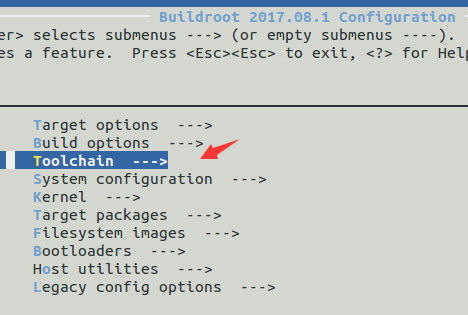

各位大神,如何配置buildroot用外部编译器?
#2 2017-12-29 15:24:36
已发帖子: 9,423
Re: 各位大神,如何配置buildroot用外部编译器?
make menuconfig
然后进入
Toolchain  --->
里面设置。

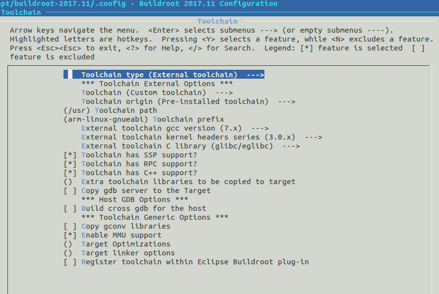

硬件环境是ilicheepi一代,系统是ubuntu17.10,想用buildroot创建根文件系统。
我打算用最新版本的交叉编译器,apt-get下载的版本是arm-linux-gnueabihf-gcc 7.2。查看了下,命令应该是在/usr/bin下,而相关库在/usr/arm-linux-gnueabihf文件夹下。
那么我在buildroot配置菜单里,toolchains是这么选的:
选择外部编译器;
选择编译器路径:/usr
选择编译器头?:arm-linux-genueabihf
然后我执行make,但仍报以下错误:
>>> toolchain-external-custom  Configuring
Distribution toolchains are unsuitable for use by Buildroot,
as they were configured in a way that makes them non-relocatable,
and contain a lot of pre-built libraries that would conflict with
the ones Buildroot wants to build.
package/pkg-generic.mk:224: recipe for target '/opt/buildroot-2017.11/output/build/toolchain-external-custom/.stamp_configured' failed
make: *** [/opt/buildroot-2017.11/output/build/toolchain-external-custom/.stamp_configured] Error 1
any@Any-Desktop-PC:/opt/buildroot-2017.11$
意思是:
交叉编译器不适合buildroot使用?
原因是它们以一种可重新定位的方式配置?
并且,包含了很多预置的库,这些库可能和buildroot想要创建的东西冲突?

选择编译器路径:/usr
这个应该是
/usr/bin
#5 2018-01-13 11:23:48
Any
注册时间: 2017-12-11
已发帖子: 20
积分: 20
/bin不用加的,make时会自动追加/bin
试了下:
Cannot execute cross-compiler '/usr/bin/bin/arm-linux-gnueabihf-gcc'
最近编辑记录 Any (2018-01-13 11:26:47)
我知道了, 你这个工具链不可以被重定位(non-relocatable), buildroot不接受这个工具链.

既然想用最新的工具链, 那应该不选external buildroot chains, 而应该让buildroot下载源码自己去生成arm-linux-gcc工具链。

如果我们在 buildroot 中的 toolchain 指定外部编译工具为之前在 Ubuntu 上面 apt-get 的交叉编译器,那么编译的时候则会出现错误信息:
这是因为 Ubuntu 得到的交叉编译器被配置成不可重定位的,而且包含了一些与 buildroot 相冲突的库,官方解释:
Distro toolchains, i.ie. toolchains coing with distributions, will
almost invariably be unsuitable for use with Buildroot:
they are mostly non-relocatable;
their sysroot is tainted with a lot of extra libraries.
Especially, the toolchains coming with Ubuntu (really, all the Debian
familly of distros) are configured with –sysroot=/ which makes them
non-relocatable, and they already contain quite some libraries that
conflict (in any combination of version, API or ABI) with what Buildroot
wants to build (i.e. extra libraries, some not even present in
Buildroot…) but also their mere preence when Buildroot does not expect
them to be already built (so that a package would enable features when
it should not).
所以我们要自己下载交叉编译工具或者让 buildroot 自动下载。

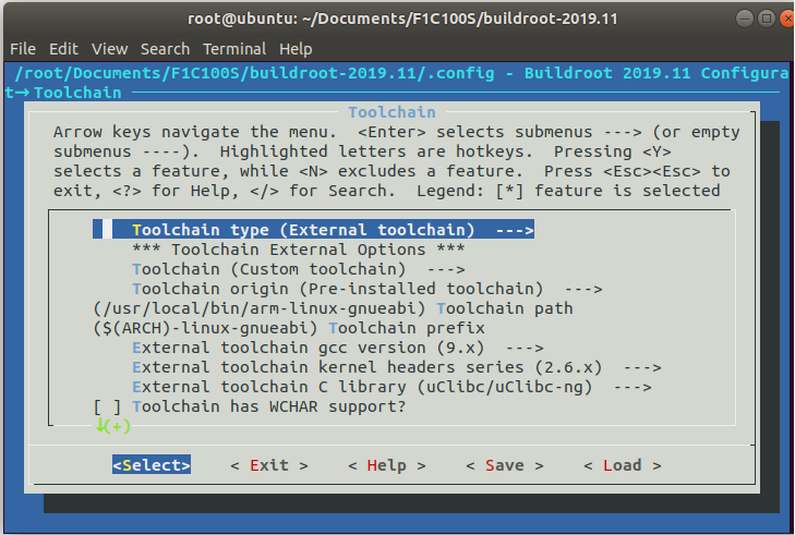

#31 2020-01-07 17:39:14
nufing
注册时间: 2020-01-02
已发帖子: 95
积分: 79.5
Incorrect selection of kernel headers: expected 2.6.x, got 4.10.x
package/pkg-generic.mk:228: recipe for target '/root/Documents/F1C100S/buildroot-2019.11/output/build/toolchain-external-custom/.stamp_configured' failed
make: *** [/root/Documents/F1C100S/buildroot-2019.11/output/build/toolchain-external-custom/.stamp_configured] Error 1
我的提示这个错误
#32 2020-01-07 18:23:31
已发帖子: 9,423
你用的是外部toolchain?
#33 2020-01-07 19:18:31
nufing
注册时间: 2020-01-02
已发帖子: 95
积分: 79.5
你用的是外部toolchain?
FluxBB bbcode buildroot menuconfig
#34 2020-01-07 19:20:42
已发帖子: 9,423
kernel header (2.6.x) 那里改选 4.10.x
#35 2020-01-07 20:18:07
nufing
注册时间: 2020-01-02
已发帖子: 95
积分: 79.5
上面的改过来 了,编译了好久, 然后遇到问题了, 是不是 arm-linux-gnueabi_7.x 不支持?
arm-none-linux-gnueabihf_9.2 这个不行,
arm-none-linux-gnueabi_9.x的没找到
错误提示如下:
root@ubuntu:~/Documents/F1C100S/buildroot-2019.11# make
Incorrect selection of the C library
make: *** [/root/Documents/F1C100S/buildroot-2019.11/output/build/toolchain-external-custom/.stamp_configured] Error 255
