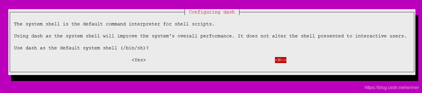

dopi@ubuntu:/usr/dopi/Hi3516EV200_SDK_V1.0.1.0/package$ cd osdrv/
dopi@ubuntu:/usr/dopi/Hi3516EV200_SDK_V1.0.1.0/package/osdrv$ make all- 编译错误:`/bin/sh: 1: pushd: not found`
解决方法:
在dash模式下,执行:sudo dpkg-reconfigure dash,弹出的串口选择NO,执行完成后,输入exit退出
dopi@ubuntu:/usr/dopi/Hi3516EV200_SDK_V1.0.1.0/package/osdrv$ cd /bin
dopi@ubuntu:/bin$ sh
$ sudo dpkg-reconfigure dash
[sudo] password for dopi:
Removing 'diversion of /bin/sh to /bin/sh.distrib by dash'
Adding 'diversion of /bin/sh to /bin/sh.distrib by bash'
Removing 'diversion of /usr/share/man/man1/sh.1.gz to /usr/share/man/man1/sh.distrib.1.gz by dash'
Adding 'diversion of /usr/share/man/man1/sh.1.gz to /usr/share/man/man1/sh.distrib.1.gz by bash'
$ sh
sh-4.4$ exit
