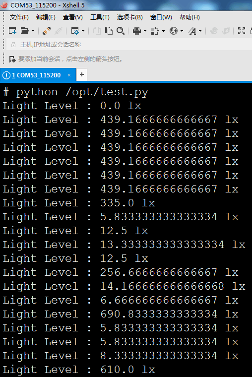

直接用shell读出亮度传感器数据:
i2cset -y 0 0x23 0x20;
sleep 1;
i2cget -y 0 0x23 0x00 w

#!/usr/bin/python
import smbus
import time
# Constants taken from the datasheet
DEVICE     = 0x23 # Default device I2C address
POWER_DOWN = 0x00 # No active state
POWER_ON   = 0x01 # Power on
RESET      = 0x07 # Reset data register value
# Start measurement at 4 lx resolution. Time typically 16ms.
CONTINUOUS_LOW_RES_MODE = 0x13
# Start measurement at 1 lx resolution. Time typically 120ms
CONTINUOUS_HIGH_RES_MODE_1 = 0x10
# Start measurement at 0.5 lx resolution. Time typically 120ms
CONTINUOUS_HIGH_RES_MODE_2 = 0x11
# Device is automatically set to Power Down after measurement.
ONE_TIME_HIGH_RES_MODE_1 = 0x20
ONE_TIME_HIGH_RES_MODE_2 = 0x21
ONE_TIME_LOW_RES_MODE = 0x23
bus = smbus.SMBus(0) # Rev 1 Pi uses 0
#bus = smbus.SMBus(1)  # Rev 2 Pi uses 1
def convertToNumber(data):
  # Simple function to convert 2 bytes of data
  # into a decimal number
  return ((data[1] + (256 * data[0])) / 1.2)
def readLight(addr=DEVICE):
  data = bus.read_i2c_block_data(addr, ONE_TIME_HIGH_RES_MODE_2)
  return convertToNumber(data)
def main():
  while True:
    print("Light Level : " + str(readLight()) + " lx")
    time.sleep(1)
if __name__=="__main__":
   main()
