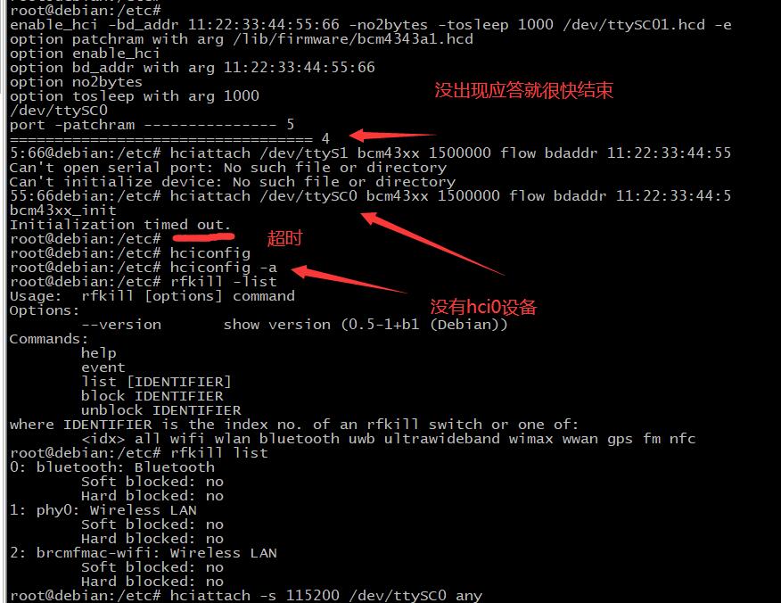

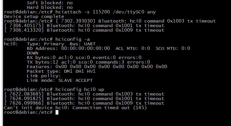

楼主 #1 2019-06-05 17:06:56
使用华嵌HQEmbed S3 开发板, 驱动经典的无线芯片 BCM43438(AP6212) 的 蓝牙Bluetooth
参考链接: 使用华嵌HQEmbed S3 开发板, 驱动经典的无线芯片 BCM43438(AP6212) 的 WIFI
固件下载地址: https://github.com/armbian/firmware/tree/master/brcm
参考链接:
https://github.com/torvalds/linux/blob/master/Documentation/devicetree/bindings/net/broadcom-bluetooth.txt
https://github.com/RoEdAl/alarm-bluetooth-raspberrypi/blob/master/bcmbt-overlay.dts
https://lkml.org/lkml/2019/2/28/1215
4.13/4.14 驱动的差异还蛮大的:
https://github.com/torvalds/linux/blob/v4.13/drivers/bluetooth/hci_bcm.c
https://github.com/torvalds/linux/blob/v4.14/drivers/bluetooth/hci_bcm.c
https://github.com/torvalds/linux/commit/33cd149e767be9afbab9fcd3d5165a2de62313c8#diff-6fa55bc95c463db86bd2105025cc42c8
                        uart1_pg_pins: uart1-pg-pins {
                                pins = "PG6", "PG7", "PG8", "PG9";
                                function = "uart1";
&uart1 {
        pinctrl-0 = <&uart1_pg_pins>;
        pinctrl-names = "default";
       bluetooth {
               compatible = "brcm,bcm43438-bt";
               max-speed = <921600>;
                vbat-supply = <&reg_vcc3v3>;
                vddio-supply = <&reg_vcc3v3>;
                device-wakeup-gpios = <&pio 1 13 GPIO_ACTIVE_HIGH>; /* PB13 */
                host-wakeup-gpios = <&pio 1 12 GPIO_ACTIVE_HIGH>; /* PB12 */
                shutdown-gpios = <&pio 1 11 GPIO_ACTIVE_HIGH>; /* PB11 */
https://github.com/torvalds/linux/blob/master/drivers/bluetooth/hci_bcm.c
测试中...

./patch -d --patchram bcm43438a1.hcd --enable_hci --bd_addr 11:22:33:44:55:
66 --no2bytes --tosleep 1000 /dev/ttyS1
option patchram with arg bcm43438a1.hcd
option enable_hci
option bd_addr with arg 11:22:33:44:55:66
option no2bytes
option tosleep with arg 1000
/dev/ttyS1
writing
01 03 0c 00
writing
01 03 0c 00
writing
01 03 0c 00
writing
01 03 0c 00
初始化命令没有回复.

用一楼的方法没有驱动,用二楼的方法在其他V3s板子搞定了AP6212蓝牙,晚些时候我再到华嵌S3板子测试。

我是自己后焊的BCM43438,表面喷了黑漆,不是亮晶晶的那款,hcd要用这个。
https://github.com/armbian/firmware/blob/master/ap6212/bcm43438a1.hcd
devmem 0x01c20828 32 0x771733 # 设置PB11工作模式为输出
devmem 0x01c20834 32 0x804 # 设置PB11输出高电平
brcm_patchram_plus -d --patchram /lib/firmware/brcm/bcm43438a1.hcd --enable_hci --bd_addr 11:22:33:44:55:66 --no2bytes --tosleep 1000 /dev/ttyS1
跑完了好像会一直卡死,直接^C掉
hciattach /dev/ttyS1 bcm43xx 1500000 flow bdaddr 11:22:33:44:55:66
挂载HCI设备
期待大佬出DTS版,devmem一点都不清真
固件下载与挂载设备
01 03 0c 00
received 7
04 0e 04 01 03 0c 00
writing
01 01 fc 06 66 55 44 33 22 11
received 7
04 0e 04 01 01 fc 00
Done setting line discpline
^C
# hciattach /dev/ttyS1 bcm43xx 1500000 flow bdaddr 11:22:33:44:55:66
bcm43xx_init
Patch not found, continue anyway
Set BDADDR UART: 11:22:33:44:55:66
Set Controller UART speed to 1500000 bit/s
Device setup complete
# hciconfig -a
hci0:   Type: Primary  Bus: UART
        BD Address: 11:22:33:44:55:66  ACL MTU: 1021:8  SCO MTU: 64:1
        DOWN
        RX bytes:612 acl:0 sco:0 events:30 errors:0
        TX bytes:398 acl:0 sco:0 commands:30 errors:0
        Features: 0xbf 0xfe 0xcf 0xfe 0xdb 0xff 0x7b 0x87
        Packet type: DM1 DM3 DM5 DH1 DH3 DH5 HV1 HV2 HV3
        Link policy: RSWITCH SNIFF
        Link mode: SLAVE ACCEPT
蓝牙发现
# hciconfig hci0 up
# hcitool scan
Scanning ...
        3C:CD:36:**:**:**       Xin的iPhone
        A0:C5:89:**:**:**       ThinkPad-X1
最近编辑记录 aodzip (2020-02-01 23:49:05)

好像我的BCM43438A1在patchram之前不响应和获取芯片版本相关的指令,有可能是早期版本的BUG。
但是这不会影响patchram的写入,可以修改Linux驱动暂时忽略掉这个问题,当patchram写入后,Linux会重新尝试获取芯片信息。

请教下,我在3.10内核,debian系统下调试AP6212蓝牙功能,在使用brcm_patchram_plus配置初始化参数,加载固件时很快结束,没看到有命令应答,在hciattach时会发生超时错误,hciattach命令只有使用any才会产生hci0设备,但hci0设备的地址都为空,也没发送接收字节,没法启动蓝牙,不知道哪儿出问题了。

enable_hci 加一个 -d 参数, 可以输出调试信息。

这就是加了调试信息的-d,串口终端命令行输入问题导致的没显示出来,具体命令是
brcm_patchram_plus -d -patchram /lib/firmware/bcm4343a1.hcd -enable_hci -bd_addr 11:22:33:44:55:66 -no2bytes -tosleep 1000 /dev/ttySC0

@晕哥
晕哥,我根据你2楼的连接,重新下载brcm_patchram_plus.c源码,编译后再执行初始化,有初始化命令01 03 0c 00发出,但没回应,跟你2楼情况有些一样,你当时没回应问题怎么解决的。
楼主 #18 2020-03-01 12:20:14
Re: 使用华嵌HQEmbed S3 开发板, 驱动经典的无线芯片 BCM43438(AP6212) 的 蓝牙Bluetooth
注意电源引脚,看 bt 是否使能了
华嵌的板子吗
这两条跑一下,可以临时测试用
(所以我自己做的板子把WL和BT的使能调整到AXP209上了

请问这个解决了吗?
我在nanopi-m1-plus上按照2楼的方法,也出现Bluetooth hci0 timeout command 0x1003 tx timeout的错误。
真系头大
