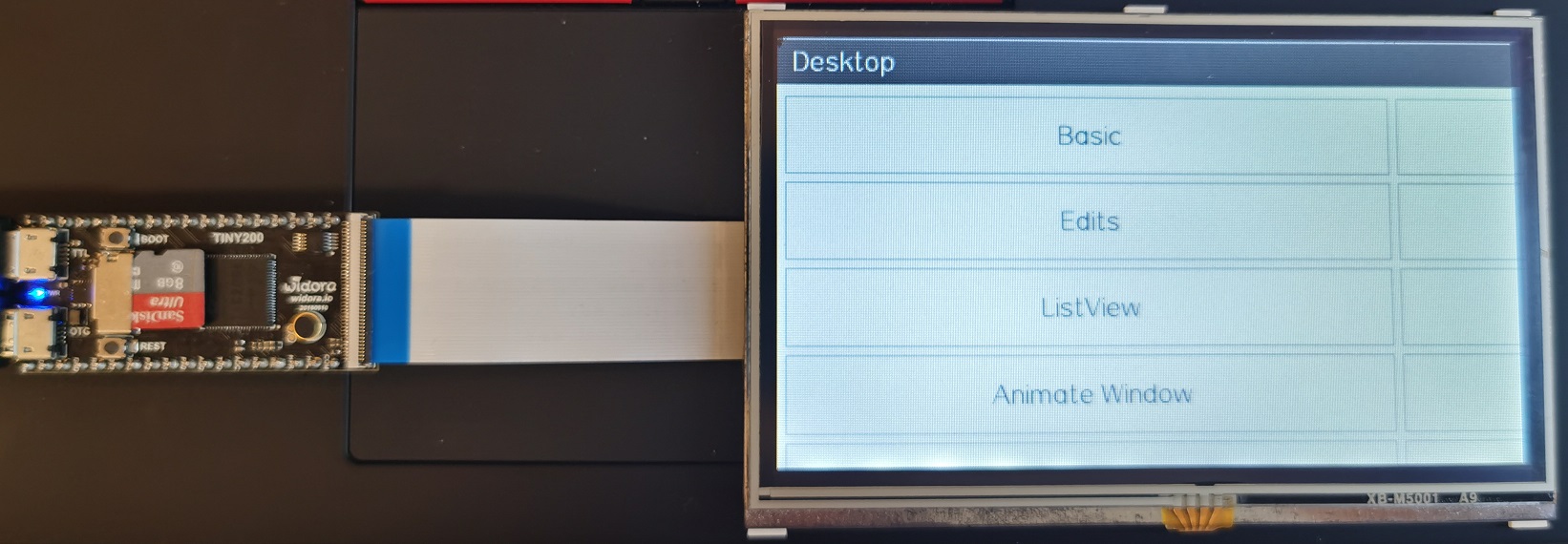

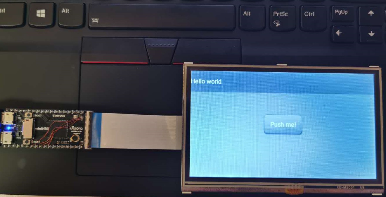

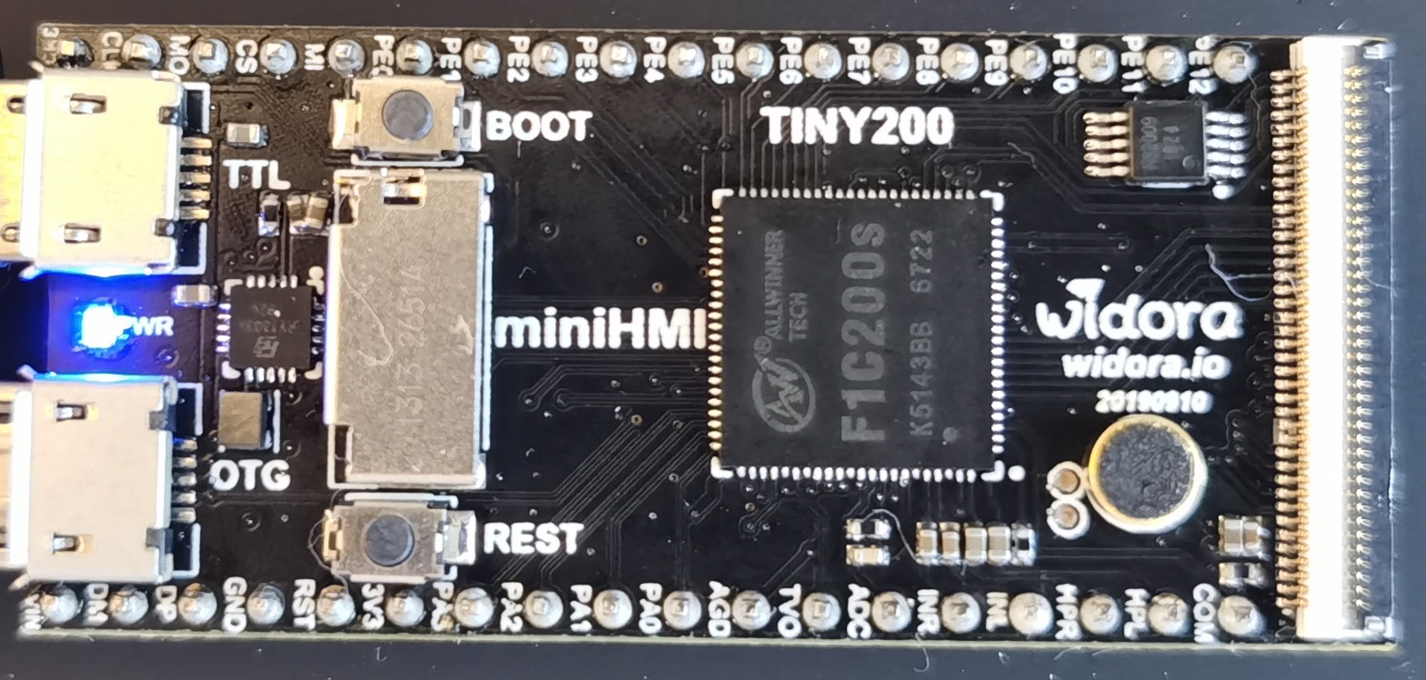

The Widora TINY 200 is a small one, not much larger than a uSD slot, the main chip, two USB ports (console and OTG) and an LCD connector.
The board comes with a 480*272 LCD with resistive touch. After connecting the FFC cable, writing demo firmware, I was able to see the LCD turning on running a demo app based on Linux.
At this moment, touch doesn't work as the firmware I run is not for this board, it was for Lichee pi nano, which is a tiny bit different.
Resolution is also not correct for the same reason.

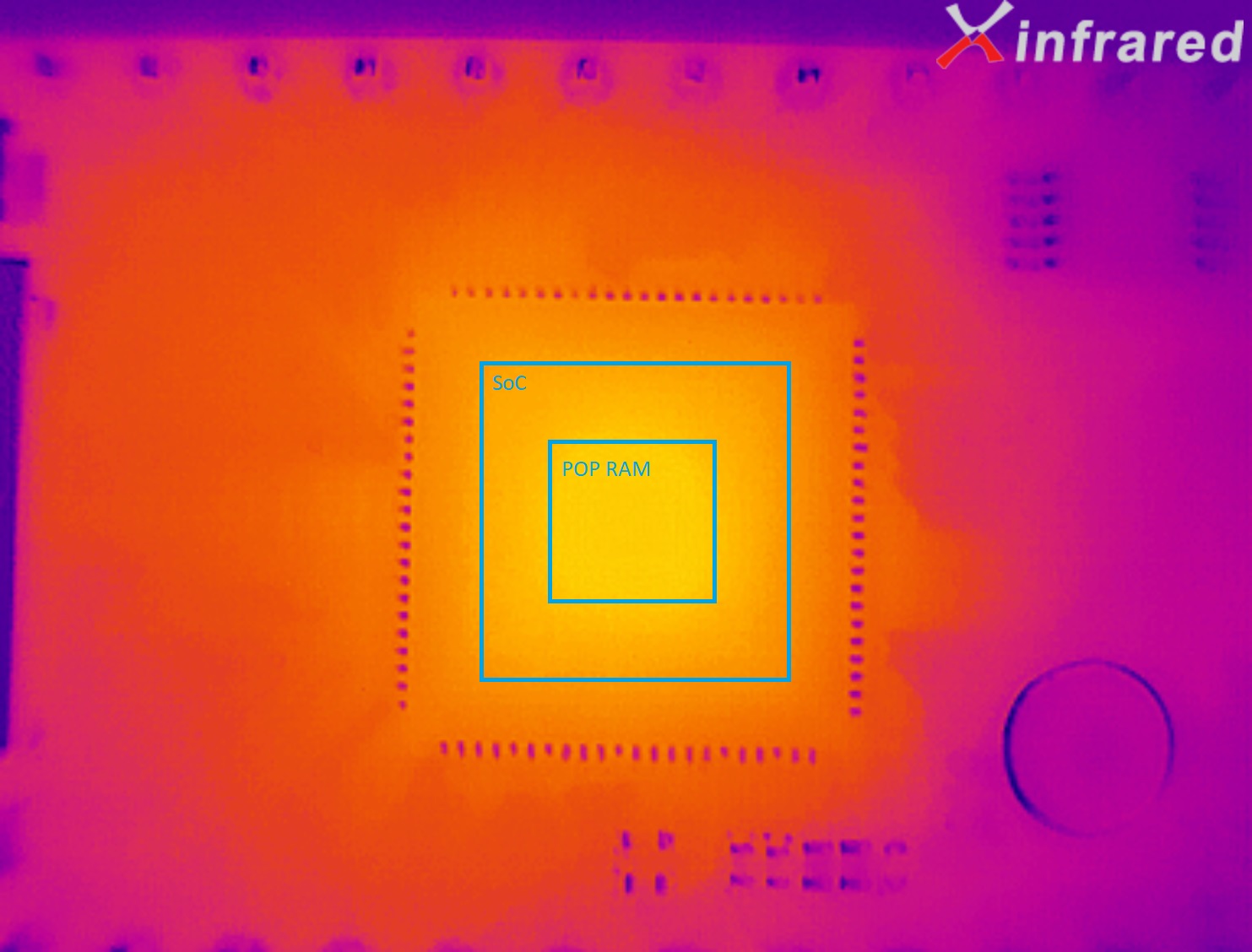

The SoC runs cool. Barely warm to touch. It runs at 5 degs above the rest of the board, which is at around 30C.
Interesting enough, we can see the stacked die structure from thermal image. The top die (hotter) is the RAM, and the bottom die (cooler) is SoC.
The RAM being hotter makes sense as some heat comes out from the SoC through the RAM, so it has to dissipate more heat.
