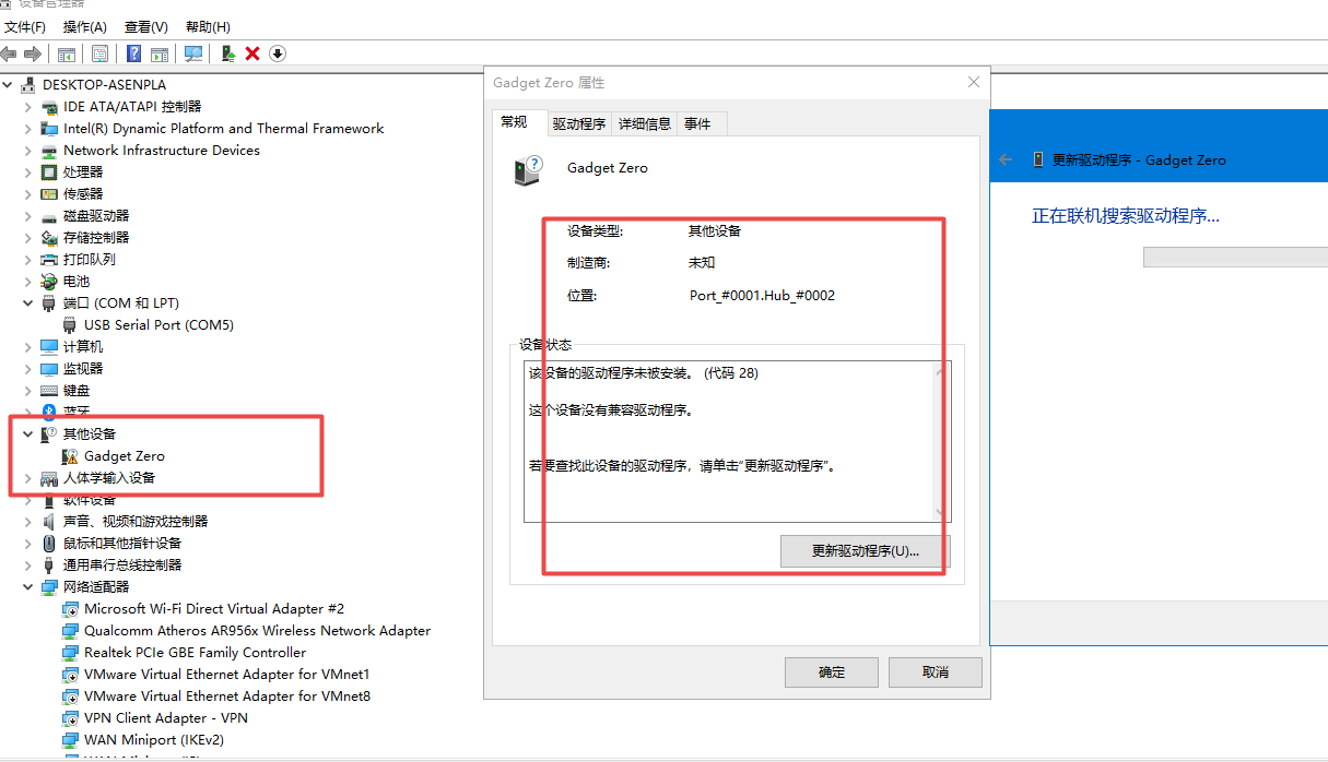

USB 插到PC 上能识别到 Gadget Zero,为啥就是不能识别出TF卡 为盘符呢,把SD NAND/TF卡挂载为电脑U盘
运行环境
f1c100s-nano uboot-2008.01 kernerl-5.2-tf
按照论坛里的 https://whycan.cn/t_3087.html u 盘可以插拔识别,现在又个疑问为啥板子 USB 插到PC 上能识别到 Gadget Zero,为啥就是不能识别出TF卡 为盘符呢,把SD NAND/TF卡挂载为电脑U盘,
记得晕哥的SD NAND 的
https://whycan.cn/t_2449.html -》》》USB启动 Linux,并且把SD NAND/TF卡挂载为电脑U盘, 然后可以通过dd或Win32DiskImager任烧写
这样一来既可以 传文件方便,也可以,方便后续烧写SD NAND

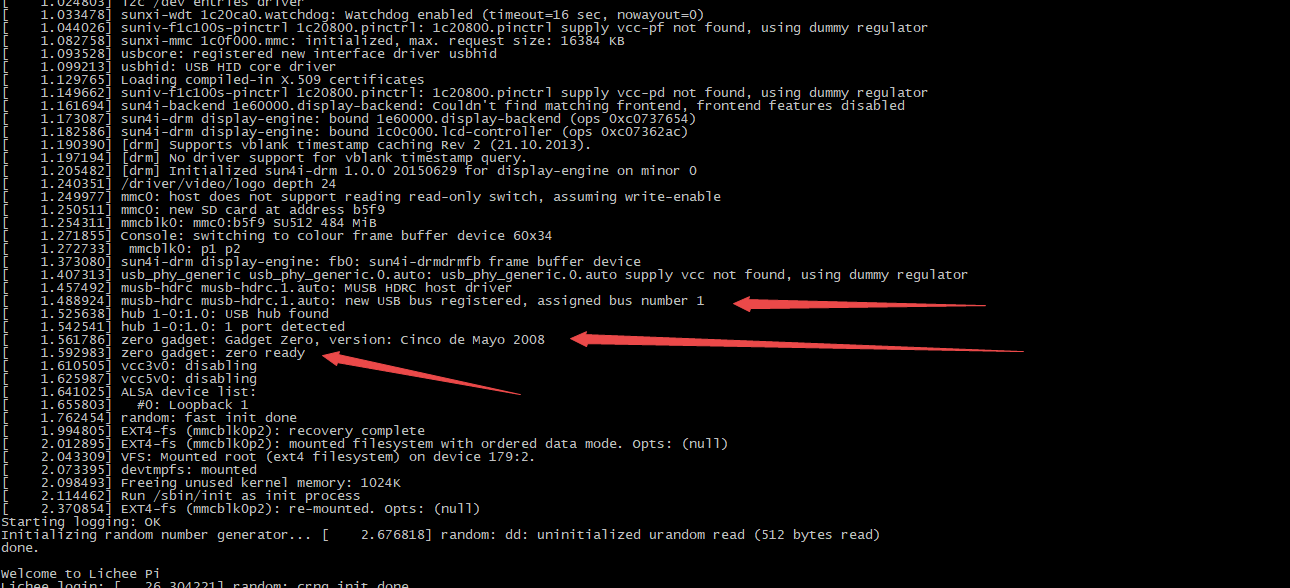

U-Boot SPL 2018.01-05676-g00188782ee (Apr 08 2018 - 16:10:25)
DRAM: 32 MiB
Trying to boot from MMC1
U-Boot 2018.01-05676-g00188782ee (Apr 08 2018 - 16:10:25 +0800) Allwinner Technology
Model: Lichee Pi Nano
DRAM:  32 MiB
MMC:   SUNXI SD/MMC: 0
In:    serial@1c25000
Out:   serial@1c25000
Err:   serial@1c25000
Net:   No ethernet found.
starting USB...
No controllers found
switch to partitions #0, OK
mmc0 is current device
Scanning mmc 0:1...
Found U-Boot script /boot.scr
reading /boot.scr
280 bytes read in 14 ms (19.5 KiB/s)
## Executing script at 80c50000
9711 bytes read in 27 ms (350.6 KiB/s)
reading zImage
3706568 bytes read in 334 ms (10.6 MiB/s)
   Loading Device Tree to 80e60000, end 80e655ee ... OK
[    0.000000] Linux version 5.2.0-licheepi-nano+ (root@ll-virtual-machine) (gcc version 7.2.1 20171011 (Linaro GCC 7.2-2017.11)) #18 Wed Aug 5 18:19:19 CST 2020
[    0.000000] Kernel command line: console=tty0 console=ttyS0,115200 panic=5 rootwait root=/dev/mmcblk0p2 rw
[    0.000000] Memory: 22728K/32768K available (6144K kernel code, 209K rwdata, 1288K rodata, 1024K init, 218K bss, 10040K reserved, 0K cma-reserved, 0K highmem)
[    0.000000] random: get_random_bytes called from start_kernel+0x280/0x48c with crng_init=0
[    0.000066] sched_clock: 32 bits at 24MHz, resolution 41ns, wraps every 89478484971ns
[    0.000167] clocksource: timer: mask: 0xffffffff max_cycles: 0xffffffff, max_idle_ns: 79635851949 ns
[    0.001032] Console: colour dummy device 80x30
[    0.002096] printk: console [tty0] enabled
[    0.002235] Calibrating delay loop... 358.80 BogoMIPS (lpj=1794048)
[    0.050408] pid_max: default: 32768 minimum: 301
[    0.050915] Mount-cache hash table entries: 1024 (order: 0, 4096 bytes)
[    0.051040] Mountpoint-cache hash table entries: 1024 (order: 0, 4096 bytes)
[    0.053006] CPU: Testing write buffer coherency: ok
[    0.055322] Setting up static identity map for 0x80100000 - 0x80100058
[    0.058007] devtmpfs: initialized
[    0.067885] clocksource: jiffies: mask: 0xffffffff max_cycles: 0xffffffff, max_idle_ns: 19112604462750000 ns
[    0.068101] futex hash table entries: 256 (order: -1, 3072 bytes)
[    0.068515] pinctrl core: initialized pinctrl subsystem
[    0.072084] DMA: preallocated 256 KiB pool for atomic coherent allocations
[    0.075253] cpuidle: using governor menu
[    0.146631] SCSI subsystem initialized
[    0.147289] usbcore: registered new interface driver usbfs
[    0.147615] usbcore: registered new interface driver hub
[    0.147931] usbcore: registered new device driver usb
[    0.148728] pps_core: LinuxPPS API ver. 1 registered
[    0.148848] pps_core: Software ver. 5.3.6 - Copyright 2005-2007 Rodolfo Giometti <giometti@linux.it>
[    0.149722] Advanced Linux Sound Architecture Driver Initialized.
[    0.151041] clocksource: Switched to clocksource timer
[    0.192686] NetWinder Floating Point Emulator V0.97 (double precision)
[    0.195634] Initialise system trusted keyrings
[    0.196398] workingset: timestamp_bits=30 max_order=13 bucket_order=0
[    0.230944] Key type asymmetric registered
[    0.231224] Asymmetric key parser 'x509' registered
[    0.231520] Block layer SCSI generic (bsg) driver version 0.4 loaded (major 251)
[    0.231647] io scheduler mq-deadline registered
[    0.231723] io scheduler kyber registered
[    0.234986] sun4i-usb-phy 1c13400.phy: Couldn't request ID GPIO
[    0.251524] suniv-f1c100s-pinctrl 1c20800.pinctrl: initialized sunXi PIO driver
[    0.505310] Serial: 8250/16550 driver, 8 ports, IRQ sharing disabled
[    0.513427] suniv-f1c100s-pinctrl 1c20800.pinctrl: 1c20800.pinctrl supply vcc-pe not found, using dummy regulator
[    0.516117] printk: console [ttyS0] disabled
[    0.536581] 1c25000.serial: ttyS0 at MMIO 0x1c25000 (irq = 26, base_baud = 6250000) is a 16550A
[    0.871373] printk: console [ttyS0] enabled
[    0.899493] 1c25800.serial: ttyS1 at MMIO 0x1c25800 (irq = 27, base_baud = 6250000) is a 16550A
[    0.913681] suniv-f1c100s-pinctrl 1c20800.pinctrl: 1c20800.pinctrl supply vcc-pd not found, using dummy regulator
[    0.936146] SCSI Media Changer driver v0.25
[    0.942595] suniv-f1c100s-pinctrl 1c20800.pinctrl: 1c20800.pinctrl supply vcc-pc not found, using dummy regulator
[    0.957295] suniv-f1c100s-pinctrl 1c20800.pinctrl: 1c20800.pinctrl supply vcc-pa not found, using dummy regulator
[    0.972018] ehci_hcd: USB 2.0 'Enhanced' Host Controller (EHCI) Driver
[    0.978664] ehci-platform: EHCI generic platform driver
[    0.984541] ohci_hcd: USB 1.1 'Open' Host Controller (OHCI) Driver
[    0.990889] ohci-platform: OHCI generic platform driver
[    0.996945] usbcore: registered new interface driver usb-storage
[    1.004530] udc-core: couldn't find an available UDC - added [zero] to list of pending drivers
[    1.015089] input: 1c23400.lradc as /devices/platform/soc/1c23400.lradc/input/input0
[    1.024389] i2c /dev entries driver
[    1.033073] sunxi-wdt 1c20ca0.watchdog: Watchdog enabled (timeout=16 sec, nowayout=0)
[    1.043630] suniv-f1c100s-pinctrl 1c20800.pinctrl: 1c20800.pinctrl supply vcc-pf not found, using dummy regulator
[    1.082358] sunxi-mmc 1c0f000.mmc: initialized, max. request size: 16384 KB
[    1.093123] usbcore: registered new interface driver usbhid
[    1.098807] usbhid: USB HID core driver
[    1.129327] Loading compiled-in X.509 certificates
[    1.149335] suniv-f1c100s-pinctrl 1c20800.pinctrl: 1c20800.pinctrl supply vcc-pd not found, using dummy regulator
[    1.161361] sun4i-backend 1e60000.display-backend: Couldn't find matching frontend, frontend features disabled
[    1.172747] sun4i-drm display-engine: bound 1e60000.display-backend (ops 0xc0737654)
[    1.182265] sun4i-drm display-engine: bound 1c0c000.lcd-controller (ops 0xc07362ac)
[    1.190075] [drm] Supports vblank timestamp caching Rev 2 (21.10.2013).
[    1.196872] [drm] No driver support for vblank timestamp query.
[    1.205187] [drm] Initialized sun4i-drm 1.0.0 20150629 for display-engine on minor 0
[    1.240061] /driver/video/logo depth 24
[    1.249669] mmc0: host does not support reading read-only switch, assuming write-enable
[    1.250196] mmc0: new SD card at address b5f9
[    1.254025] mmcblk0: mmc0:b5f9 SU512 484 MiB
[    1.271546] Console: switching to colour frame buffer device 60x34
[    1.272426]  mmcblk0: p1 p2
[    1.372815] sun4i-drm display-engine: fb0: sun4i-drmdrmfb frame buffer device
[    1.407055] usb_phy_generic usb_phy_generic.0.auto: usb_phy_generic.0.auto supply vcc not found, using dummy regulator
[    1.457237] musb-hdrc musb-hdrc.1.auto: MUSB HDRC host driver
[    1.488674] musb-hdrc musb-hdrc.1.auto: new USB bus registered, assigned bus number 1
[    1.525359] hub 1-0:1.0: USB hub found
[    1.542257] hub 1-0:1.0: 1 port detected
[    1.561491] zero gadget: Gadget Zero, version: Cinco de Mayo 2008
[    1.592672] zero gadget: zero ready
[    1.610195] vcc3v0: disabling
[    1.625676] vcc5v0: disabling
[    1.640711] ALSA device list:
[    1.655494]   #0: Loopback 1
[    1.686973] random: fast init done
[    1.702270] EXT4-fs (mmcblk0p2): mounted filesystem with ordered data mode. Opts: (null)
[    1.733104] VFS: Mounted root (ext4 filesystem) on device 179:2.
[    1.763498] devtmpfs: mounted
[    1.788824] Freeing unused kernel memory: 1024K
[    1.804837] Run /sbin/init as init process
[    2.063586] EXT4-fs (mmcblk0p2): re-mounted. Opts: (null)
Starting logging: OK
Initializing random number generator... [    2.374226] random: dd: uninitialized urandom read (512 bytes read)
done.
Welcome to Lichee Pi
Lichee login:
Lichee login: root
Password:
Login incorrect
Lichee login: root
Password:
login[97]: root login on 'ttyS0'
# [  100.991176] random: crng init done
# [  311.471184] usb 1-1: new high-speed USB device number 2 using musb-hdrc
[  311.675107] usb-storage 1-1:1.0: USB Mass Storage device detected
[  311.705128] scsi host0: usb-storage 1-1:1.0
[  312.802945] scsi 0:0:0:0: Direct-Access     Mass     Storage Device   1.00 PQ: 0 ANSI: 0 CCS
[  312.837063] sd 0:0:0:0: Attached scsi generic sg0 type 0
[  312.989234] sd 0:0:0:0: [sda] 990976 512-byte logical blocks: (507 MB/484 MiB)
[  313.019734] sd 0:0:0:0: [sda] Write Protect is off
[  313.037258] sd 0:0:0:0: [sda] No Caching mode page found
[  313.053771] sd 0:0:0:0: [sda] Assuming drive cache: write through
[  313.089394]  sda: sda1 sda2
[  313.110279] sd 0:0:0:0: [sda] Attached SCSI removable disk
楼主 #2 2020-08-07 15:42:58
小熊猫
注册时间: 2020-05-21
已发帖子: 71
积分: 65.5
Re: USB 插到PC 上能识别到 Gadget Zero,为啥就是不能识别出TF卡 为盘符呢,把SD NAND/TF卡挂载为电脑U盘
没人知道。OTG devices模式的时候,作为U盘挂载到PC 嘛嘛
#3 2020-08-07 15:47:00
已发帖子: 3,410
积分: 1907
make menuconfig 上面你的 usb gadget是怎么配置的?

验证完毕。。。
依赖关系 识别外插U盘
insmod libcomposite.ko
insmod usb_f_ss_lb.ko
insmod g_zero.ko
insmod g_zero.ko OK
[ 443.563551] zero gadget: Gadget Zero, version: Cinco de Mayo 2008
[ 443.569862] zero gadget: zero ready
PC端U盘
insmod usb_f_mass_storage.ko
insmod g_mass_storage.ko file=/dev/mmcblk0p1 stall=0 removable=1
