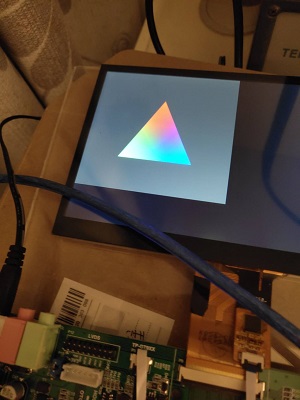

A33主线Linux跑起OpenGL/ES
A33的GPU有两个方向,开源的Lima和非开源的全志OpenGL库
Lima+Mesa3D
LIMA只需要在内核选上LIMA和SUN4I的DRM驱动即可
Mesa3D可以在buildroot选上
不过最后我运行mesa的demo直接出错也找不到问题就放弃了,不知道是哪里的问题,网上教程太少不会玩。
这时候我切到第二个方案:
其实教程就是 https://github.com/mripard/sunxi-mali
但是这里有个坑(我选的fbdev的库),导致一运行malitest就出错(malitest可以自己编一个 https://github.com/linux-sunxi/sunxi-mali/tree/master/test )
查资料得到了信息
  1. Must enable DRM_FBDEV_LEAK_PHYS_SMEM from kernel
  2. set drm_leak_fbdev_smem on compile time (for some reason, passing in command line did not help) in drm_fb_helper.c
  3. use latest r8p1
这回终于跑起来了
malitest和QT的OpenGL例子都运行正常
对了,最好在buildroot里选上sunxi-mali-mainline,这样它会自动给你生成一个启动时加载mali.ko的脚本。

运行malitest的结果,可以验证是否正确
EGL Version: "1.4 Linux-r8p1-00rel0"
EGL Vendor: "ARM"
EGL Extensions: "EGL_KHR_image EGL_KHR_image_base EGL_KHR_image_pixmap EGL_KHR_gl_texture_2D_image EGL_KHR_gl_texture_cubemap_image EGL_KHR_gl_renderbuffer_image EGL_KHR_reusable_sync EGL_KHR_fence_sync EGL_KHR_lock_surface EGL_KHR_lock_surface2 EGL_EXT_create_context_robustness EGL_ANDROID_blob_cache EGL_KHR_create_context EGL_KHR_partial_update EGL_KHR_create_context_no_error "
Surface size: 1024x600
GL Vendor: "ARM"
GL Renderer: "Mali-400 MP"
GL Version: "OpenGL ES 2.0 "mali450-r5p1-01rel0-lollipop-233-g52c929d""
GL Extensions: "GL_OES_texture_npot GL_OES_vertex_array_object GL_OES_compressed_ETC1_RGB8_texture GL_EXT_compressed_ETC1_RGB8_sub_texture GL_OES_standard_derivatives GL_OES_EGL_image GL_OES_depth24 GL_ARM_rgba8 GL_ARM_mali_shader_binary GL_OES_depth_texture GL_OES_packed_depth_stencil GL_EXT_texture_format_BGRA8888 GL_OES_vertex_half_float GL_EXT_blend_minmax GL_OES_EGL_image_external GL_OES_EGL_sync GL_OES_rgb8_rgba8 GL_EXT_multisampled_render_to_texture GL_EXT_discard_framebuffer GL_OES_get_program_binary GL_ARM_mali_program_binary GL_EXT_shader_texture_lod GL_EXT_robustness GL_OES_depth_texture_cube_map GL_KHR_debug GL_ARM_shader_framebuffer_fetch GL_ARM_shader_framebuffer_fetch_depth_stencil GL_OES_mapbuffer GL_KHR_no_error"

我这边运行 test 程序直接出现 Error: eglCreateWindowSurface failed: 0x00003003
查询错误码 是 EGL_BAD_ALLOC, 用的r8p1 fbdev ,你又遇到这个问题吗?
楼主 #8 2020-03-13 08:10:09
Re: A33主线Linux跑起OpenGL/ES
我也是遇到这个问题
  1. set drm_leak_fbdev_smem on compile time (for some reason, passing in command line did not help) in drm_fb_helper.c
    这个改了吗?我改了这个就好
    另外记得把drm的Framebuffer设成200既2倍大小
    还有如果有其它程序用fb比如xserver,要先关掉

换成4.19的内核也不行,现在的问题是 不管overalloc更改成200,还是300,系统中的y_virtual 都是600
# ./egl_test
EGL Vendor: "ARM"
The mem is :2457600
The line_length is :4096
The xres is :1024
The yres is :600
The xres_v is :1024
The yres_v is :600
bits_per_pixel is :32
见了鬼了

你的驱动不支持双缓冲。
The mem is :2457600 = 600 * 4096,显存明显只一个帧缓冲大小。
必须大于双缓冲以上的显存,y_virtual 才能翻倍。

用drm 的fb后可以有 双缓冲了,但是现在程序又死在 eglSwapBuffers中了,直接不返回了

NND, 终于跑起来了, 4.19.5内核外加补丁

#if IS_ENABLED(CONFIG_DRM_FBDEV_LEAK_PHYS_SMEM)
static bool drm_leak_fbdev_smem = true;
module_param_unsafe(drm_leak_fbdev_smem, bool, 0600);
MODULE_PARM_DESC(drm_leak_fbdev_smem,
		 "Allow unsafe leaking fbdev physical smem address [default=false]");
我记得有人说4.x之后需要这样改动:
config打开CONFIG_DRM_FBDEV_LEAK_PHYS_SMEM
然后在drm_fb_helper.c中drm_leak_fbdev_smem设置true;
其他就是按照那个github说明编maili.ko
