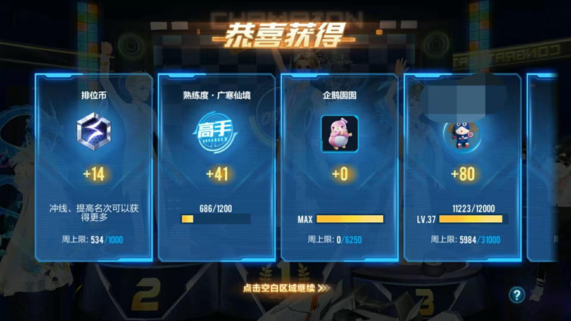

下面的截图来自最近沉迷的手游《QQ飞车》。(飞车一局2分钟左右,比王者玩起来轻松太多了,当然我主要是为看它的GUI设计,信吧~)

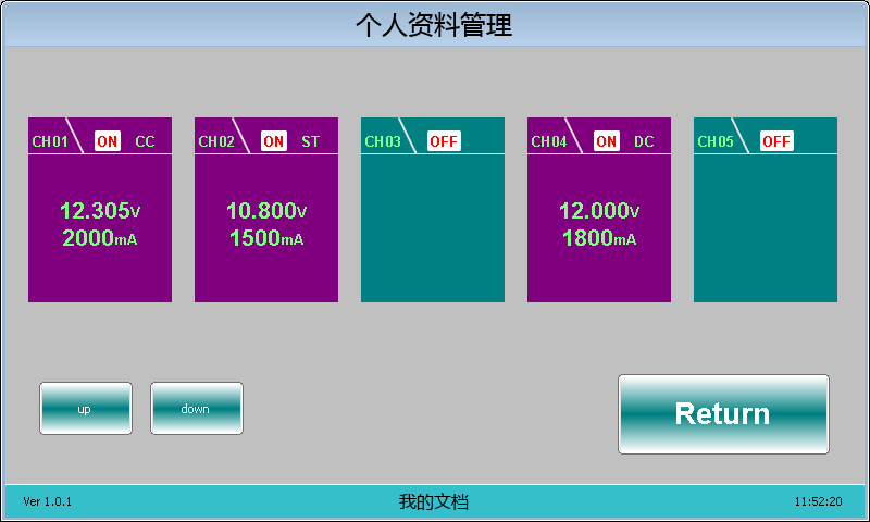

原理就是用emwin系统的皮肤设置函数+按钮私有数据。这相当于一种自定义控件实现的简单方法,通过不同的函数+数据结构就能实现不同功能的控件。

static BATINFO_USER_SKIN BatInfoData[] = {
    {ZL_BTN_CHKMODE_NO, GUI_DARKCYAN, GUI_DARKMAGENTA, &awefont24, "\uf0f6", "stm8", 1, 1, ZL_BATINFO_MODE_CC, 12.305, 2000},
    {ZL_BTN_CHKMODE_NO, GUI_DARKCYAN, GUI_DARKMAGENTA, &awefont24, "\uf030", "stm32", 2, 1, ZL_BATINFO_MODE_ST, 10.8, 1500},
    {ZL_BTN_CHKMODE_NO, GUI_DARKCYAN, GUI_DARKMAGENTA, &awefont24, "\uf008", "mcu", 3, 0, ZL_BATINFO_MODE_CV},
    {ZL_BTN_CHKMODE_NO, GUI_DARKCYAN, GUI_DARKMAGENTA, &awefont24, "\uf226", "linux", 4, 1, ZL_BATINFO_MODE_DC, 12.0, 1800},
    {ZL_BTN_CHKMODE_NO, GUI_DARKCYAN, GUI_DARKMAGENTA, &awefont24, "\uf144", "audio", 5},
