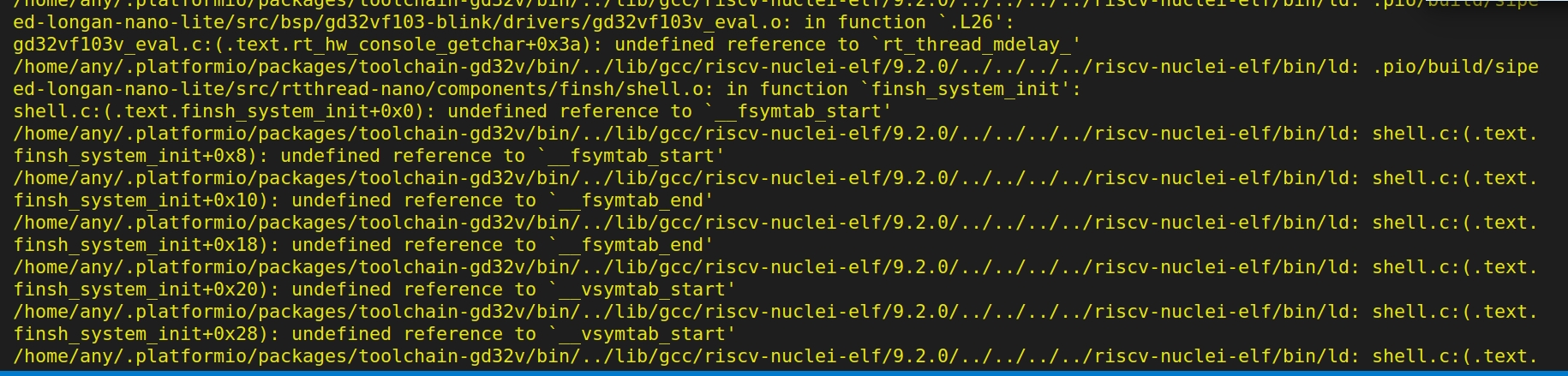

楼主 #4 2020-08-24 10:32:31
已发帖子: 1,438
积分: 1387.5
Re: vscode的插件platformio,目录结构该如何规划?
经群里朋友指点,将rt-thread-nao从platformio工程目录移到了lib目录下,编译又进了一步,现在的报错是貌似找不到rt_hw_interrupt_enable()这个函数定义。
...略去一部分报错...
/home/any/.platformio/packages/toolchain-gd32v/bin/../lib/gcc/riscv-nuclei-elf/9.2.0/../../../../riscv-nuclei-elf/bin/ld: .pio/build/sipeed-longan-nano-lite/lib168/librt-thread-nano.a(timer.o): in function `rt_timer_stop':
timer.c:(.text.rt_timer_stop+0x12): undefined reference to `rt_hw_interrupt_disable'
/home/any/.platformio/packages/toolchain-gd32v/bin/../lib/gcc/riscv-nuclei-elf/9.2.0/../../../../riscv-nuclei-elf/bin/ld: timer.c:(.text.rt_timer_stop+0x22): undefined reference to `rt_hw_interrupt_enable'
/home/any/.platformio/packages/toolchain-gd32v/bin/../lib/gcc/riscv-nuclei-elf/9.2.0/../../../../riscv-nuclei-elf/bin/ld: .pio/build/sipeed-longan-nano-lite/lib168/librt-thread-nano.a(timer.o): in function `rt_timer_check':
timer.c:(.text.rt_timer_check+0x1c): undefined reference to `rt_hw_interrupt_disable'
/home/any/.platformio/packages/toolchain-gd32v/bin/../lib/gcc/riscv-nuclei-elf/9.2.0/../../../../riscv-nuclei-elf/bin/ld: timer.c:(.text.rt_timer_check+0x50): undefined reference to `rt_hw_interrupt_enable'
*** [.pio/build/sipeed-longan-nano-lite/firmware.elf] Error 1
======================================== [FAILED] Took 0.85 seconds ========================================
我搜到了整个目录,只在两个地方找到了相关,分别是rthw.h和context_gcc.S。但是rthw.h里是声明,没有在.c文件里实现定义。
难道说context_gcc.S里的这几句汇编就是函数定义?
 * rt_base_t rt_hw_interrupt_disable(void);
    .globl rt_hw_interrupt_disable
rt_hw_interrupt_disable:
    csrrci a0, mstatus, 8
    ret
 * void rt_hw_interrupt_enable(rt_base_t level);
    .globl rt_hw_interrupt_enable
rt_hw_interrupt_enable:
    csrw mstatus, a0
    ret
最近编辑记录 Gentlepig (2020-08-24 10:36:27)

楼主 #6 2020-08-24 10:55:19
已发帖子: 1,438
积分: 1387.5
想试试rt-thread-nano,这个好像不能用scons来生成工程。
在context_gcc.S里有rt_hw_interrupt_enable相关定义。
我将context_gcc.S从lib的下级目录移到src的下级目录,和start.S和entry.S两个汇编放到一块。编译不报那个错误了。
但又找不到rt_hw_context_swith_interrupt和rt_hw_statck_init这两个函数定义,但我搜了下,在context_gcc.S和cpuport.c两个文件里,都有相关函数定义。
Building in release mode
Linking .pio/build/sipeed-longan-nano-lite/firmware.elf
/home/any/.platformio/packages/toolchain-gd32v/bin/../lib/gcc/riscv-nuclei-elf/9.2.0/../../../../riscv-nuclei-elf/bin/ld: .pio/build/sipeed-longan-nano-lite/lib168/librt-thread-nano.a(scheduler.o): in function `rt_schedule':
scheduler.c:(.text.rt_schedule+0x6e): undefined reference to `rt_hw_context_switch_interrupt'
/home/any/.platformio/packages/toolchain-gd32v/bin/../lib/gcc/riscv-nuclei-elf/9.2.0/../../../../riscv-nuclei-elf/bin/ld: .pio/build/sipeed-longan-nano-lite/lib168/librt-thread-nano.a(thread.o): in function `rt_thread_init':
thread.c:(.text.rt_thread_init+0x5c): undefined reference to `rt_hw_stack_init'
又查了下,这个函数定义是有条件的:RT_USING_SMP
最近编辑记录 Gentlepig (2020-08-24 11:23:30)
楼主 #7 2020-08-24 14:31:57
已发帖子: 1,438
积分: 1387.5
查了下这个SMP,说是对称多核用的...可我这是个单核单片机啊...
随便找了个地方使能了RT_USING_SMP。
再次编译还有个函数未定义的错误,查了下这个函数在libcpu/risc-v/comon/cpuport.c里,将这个.c文件移动到src目录下,编译通过了。
感觉像是src目录下的.c和.S文件都会被编译。
而lib目录下的,则是有条件的编译,但是不清楚是什么条件。

楼主 #13 2020-08-26 11:06:44
已发帖子: 1,438
积分: 1387.5
https://github.com/sipeed/platform-gd32v/issues/12
看这个问题说,下载芯来的最新版的openocd,就可以下载了。
可我下载后解压得到了个文件夹,不知道该怎么用,里面的bin目录下倒是有个可执行文件openocd。
我在platformio的.ini文件里,将debug_tool修改为custom,debug_server改为刚下的openocd地址,结果执行下载还是包一样的错误。

又发现,其实是可以用sipeed-rv-debugger下载的,是有报错,但是重启后发现程序已下载进去可以运行。
这是报错信息:

楼主 #23 2020-09-09 16:08:47
已发帖子: 1,438
积分: 1387.5

再回到rtthread-nano的msh功能。
之前编译后发现finsh_system_init()函数没有执行,于是手动调用这个函数,结果报__fsymtabl_start, __fsmtab_end等找不到的错误。去rtthread论坛搜,都提到了链接文件。当时没明白该去哪里找链接文件。在vsc工程目录里搜相关词也搜不到。
今天发现GD32VF103XX.lds就是链接文件,其中cbxx.lds里有相关定义,其他的没有,而我的板子正好是c8t6。把相关部分复制过来后,编译还是不行。想了想,platfromio用的是自带的lds,然后去.platformio目录下找到了相关的,把这部分复制过去。可以编译通过了,串口上也能显示msh>提示符了。不过输入没反应,可能是我串口输入部分写的有问题。
可以输入了,哈。
- RT -     Thread Operating System
 / | \     3.1.3 build Sep 10 2020
 2006 - 2019 Copyright by rt-thread team
msh >hahaha
RT-Thread shell commands:
list_timer list_mailbox list_sem list_thread version ps hel
msh >
上传一下目前的工程当个备份用。
需要注意的地方就是修改/home/any/.platformio/packages/framework-gd32vf103-sdk/RISCV/env_Eclipse下的.lds后缀的链接文件里的内容。也许platformio能指定用bsp里的lds,但我不知道怎么设置。并且,rtthread给的bsp里的,只有cbxx.lds里有__fsymtab_start相关部分,如果用的是c8t6的话,需要将c8xx.lds里的复制那部分进去。
rt-thread-nano-allinsrc.zip
最近编辑记录 Gentlepig (2020-09-10 16:14:18)
