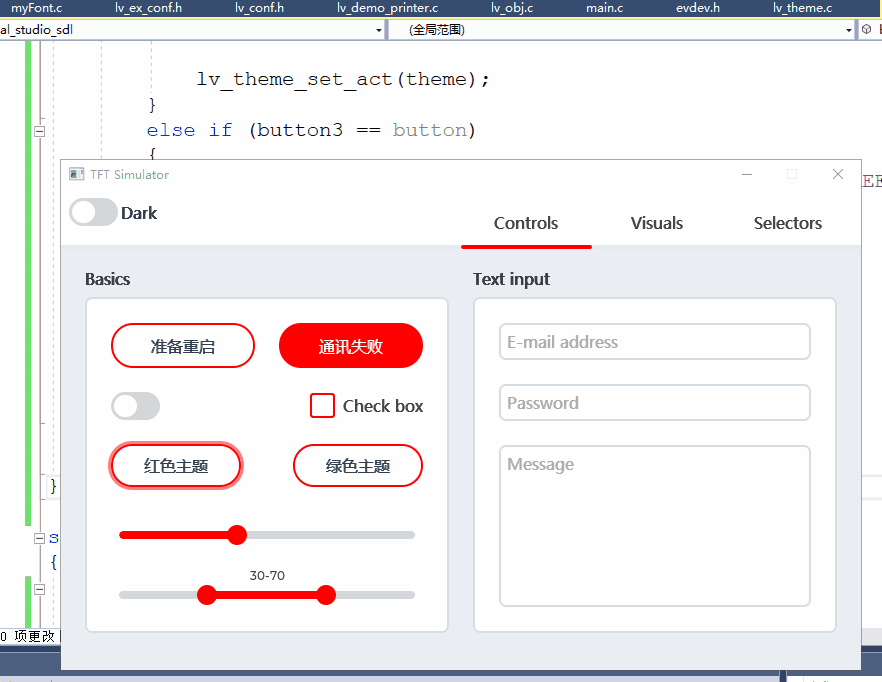

在线实时修改 LittleVGL7 / LVGL7 界面主题
LVGL7 大幅度修改了编程接口, 以前LVGL6版本的主题接口已经不能继续用了
楼主 #2 2020-08-04 18:48:29
明月照我沟渠
注册时间: 2020-07-09
已发帖子: 120
积分: 114
Re: 在线实时修改 LittleVGL7 / LVGL7 界面主题
添加定义:
static void button_event_cb(lv_obj_t * slider, lv_event_t e);
static lv_obj_t *button2, *button3;
添加两个按钮:
	button2 = lv_btn_create(h, NULL);
	lv_obj_set_event_cb(button2, button_event_cb);
	lv_obj_t* label2 = lv_label_create(button2, NULL);
	lv_label_set_text(label2, "红色主题");
	button3 = lv_btn_create(h, NULL);
	lv_obj_set_event_cb(button3, button_event_cb);
	lv_obj_t* label3 = lv_label_create(button3, NULL);
	lv_label_set_text(label3, "绿色主题");
添加按钮事件:
static void button_event_cb(lv_obj_t * button, lv_event_t e)
	if (e == LV_EVENT_RELEASED)
		if (button2 == button)
			lv_theme_t * theme = LV_THEME_DEFAULT_INIT(LV_COLOR_RED,
				LV_THEME_DEFAULT_COLOR_SECONDARY,
				LV_THEME_DEFAULT_FLAG,
				LV_THEME_DEFAULT_FONT_SMALL,
				&myFont,
				LV_THEME_DEFAULT_FONT_SUBTITLE,
				LV_THEME_DEFAULT_FONT_TITLE);
			lv_theme_set_act(theme);
		else if (button3 == button)
			lv_theme_t * theme = LV_THEME_DEFAULT_INIT(LV_COLOR_GREEN,
				&myFont,

挺好看的,坐等IDE拖放控件。
