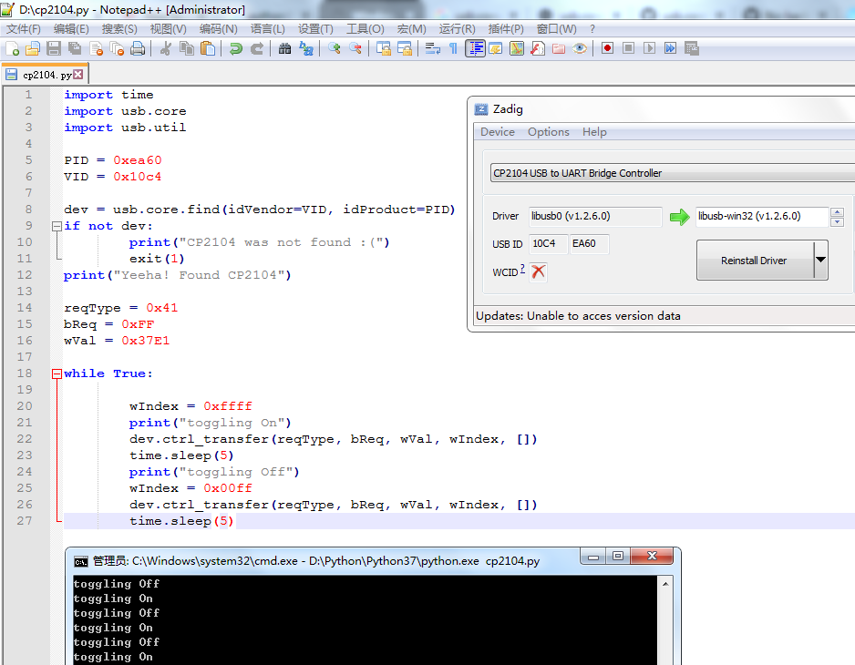

Re: Windows上用 Python 脚本控制 CP2104 GPIO 输出
import time
import usb.core
import usb.util
PID = 0xea60
VID = 0x10c4
dev = usb.core.find(idVendor=VID, idProduct=PID)
if not dev:
        print("CP2104 was not found :(")
        exit(1)
print("Yeeha! Found CP2104")
reqType = 0x41
bReq = 0xFF
wVal = 0x37E1
while True:
        wIndex = 0xffff
        print("toggling On")
        dev.ctrl_transfer(reqType, bReq, wVal, wIndex, [])
        time.sleep(5)
        print("toggling Off")
        wIndex = 0x00ff
        time.sleep(5)
  1. 用 zadig 给cp2104 强制装上 libusb-win32 驱动程序
  2. 运行D:\Python\Python37\python.exe cp2104.py
楼主 #3 2019-03-02 10:54:05
已发帖子: 9,526
debugdump@ubuntu:~$ sudo python3 /mnt/hgfs/D/cp2104.py
Yeeha! Found CP2104
toggling On
File "/mnt/hgfs/D/cp2104.py", line 22, in <module>
File "/usr/local/lib/python3.4/dist-packages/usb/core.py", line 1043, in ctrl_transfer
self.__get_timeout(timeout))
File "/usr/local/lib/python3.4/dist-packages/usb/backend/libusb1.py", line 883, in ctrl_transfer
timeout))
File "/usr/local/lib/python3.4/dist-packages/usb/backend/libusb1.py", line 595, in _check
raise USBError(_strerror(ret), ret, _libusb_errno[ret])
usb.core.USBError: [Errno 110] Operation timed out
在Ubuntu Linux 下跑会出现一个超时错误: [Errno 110] Operation timed out
楼主 #4 2019-03-02 10:55:51
已发帖子: 9,526
https://stackoverflow.com/questions/38658907/trouble-using-pyusb-to-read-write-from-usb-device-timeouts
解决方案: 在 find() 后加 reset()
import time
import usb.core
import usb.util
PID = 0xea60
VID = 0x10c4
dev.reset()
if not dev:
print("CP2104 was not found sad")
exit(1)
reqType = 0x41
bReq = 0xFF
wVal = 0x37E1
while True:
wIndex = 0xffff
time.sleep(5)
wIndex = 0x00ff
time.sleep(5)
#5 2020-10-09 21:09:20
九重天
注册时间: 2020-10-06
已发帖子: 28
积分: 20.5
感谢楼主, 测试py+cp2104测试成功.
