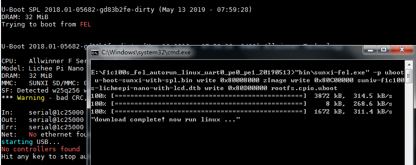

荔枝派nano f1c100s 使用sunxi-fel 借 u-boot 启动 Linux系统, 无需 spi flash / TF 卡
参考1: https://whycan.cn/t_2388.html (荔枝派zero/小智极客S3/V3s使用sunxi-fel 借 u-boot 启动 Linux系统, 无需 spi flash / TF 卡)
Run_F1C100s_LicheePi_Nano.bat
"bin\sunxi-fel.exe" -p uboot u-boot-sunxi-with-spl.bin write 0x80008000 zImage write 0x80C00000 suniv-f1c100s-licheepi-nano-with-lcd.dtb write 0x80D00000 rootfs.cpio.uboot
@echo "download complete! now run linux ..."
@sleep 5
默认串口是 UART0(PE0, PE1)
文件下载: f1c100s_fel_autorun_linux_uart0_pe0_pe1_20190514.7z

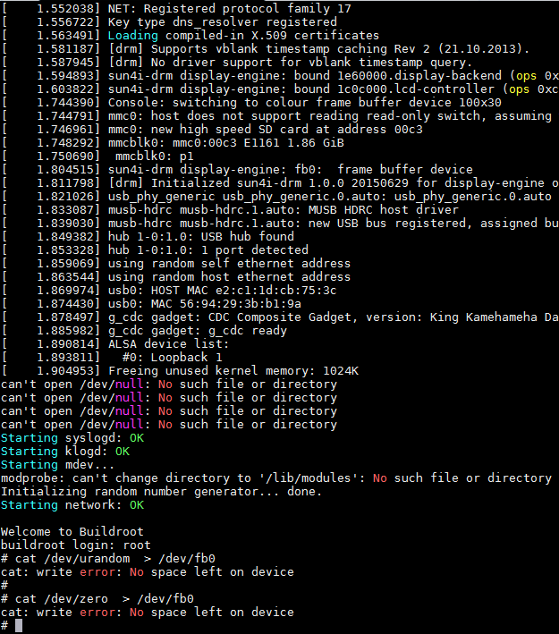

登录账号是 root, 密码空,
测试花屏:
cat /dev/urandom  > /dev/fb0
测试黑屏:
cat /dev/zero  > /dev/fb0
