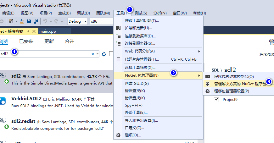

Visual C++ 编译一个SDL2 Demo
1. 新建新项目, 通过nuget安装sdl2
2. 添加一个main.cpp文件, 文件内容 https://github.com/AlmasB/SDL2-Demo/blob/master/src/Main.cpp

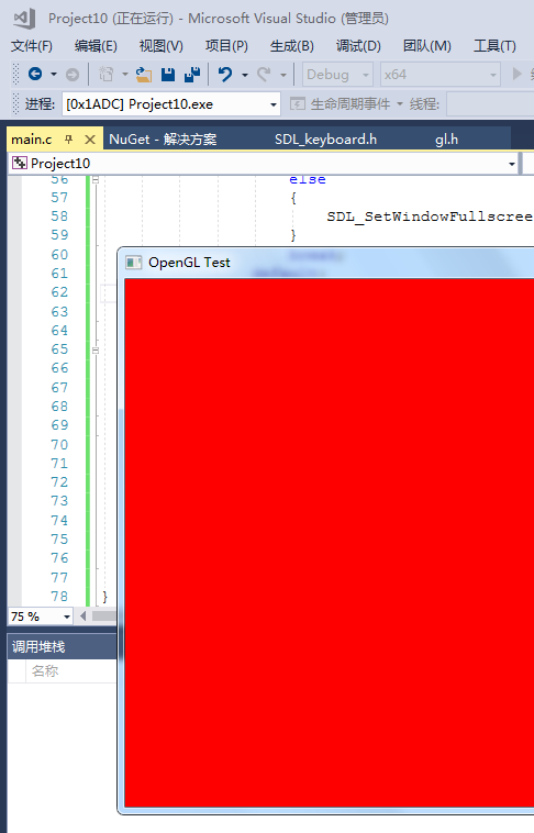

楼主 #4 2021-01-06 08:50:14
拉轰的脚踏车
注册时间: 2020-03-20
已发帖子: 288
积分: 222
Re: Visual C++ 编译一个SDL2 Demo
// To compile with gcc:  (tested on Ubuntu 14.04 64bit):
//	 g++ sdl2_opengl.cpp -lSDL2 -lGL
// To compile with msvc: (tested on Windows 7 64bit)
//   cl sdl2_opengl.cpp /I C:\sdl2path\include /link C:\path\SDL2.lib C:\path\SDL2main.lib /SUBSYSTEM:CONSOLE /NODEFAULTLIB:libcmtd.lib opengl32.lib
#include <stdio.h>
#include <stdint.h>
#include <assert.h>
#include <SDL.h>
#include <SDL_opengl.h>
#include <GL/gl.h>
#pragma comment(lib,"opengl32.lib")
#pragma comment(lib, "msvcrtd.lib")
#pragma comment(lib, "vcruntimed.lib")
#pragma comment(lib, "ucrtd.lib")
#pragma comment(linker, "/subsystem:\"windows\" /entry:\"SDL_main\"")
typedef int32_t i32;
typedef uint32_t u32;
typedef int32_t b32;
#define WinWidth 640
#define WinHeight 480
int main(int ArgCount, char **Args)
	u32 WindowFlags = SDL_WINDOW_OPENGL;
	SDL_Window *Window = SDL_CreateWindow("OpenGL Test",
		SDL_WINDOWPOS_CENTERED, SDL_WINDOWPOS_CENTERED,
		WinWidth, WinHeight, WindowFlags);
	assert(Window);
	SDL_GLContext Context = SDL_GL_CreateContext(Window);
	b32 Running = 1;
	b32 FullScreen = 0;
	while (Running)
		SDL_Event Event;
		while (SDL_PollEvent(&Event))
			if (Event.type == SDL_KEYDOWN)
				switch (Event.key.keysym.sym)
				case SDLK_ESCAPE:
					Running = 0;
					break;
				case 'f':
					FullScreen = !FullScreen;
					if (FullScreen)
						SDL_SetWindowFullscreen(Window, WindowFlags | SDL_WINDOW_FULLSCREEN_DESKTOP);
					else
						SDL_SetWindowFullscreen(Window, WindowFlags);
					break;
				default:
					break;
			else if (Event.type == SDL_QUIT)
				Running = 0;
		glViewport(0, 0, WinWidth/2, WinHeight/2);
		glClearColor(1.f, 0.f, 0.f, 0.5f);
		glClear(GL_COLOR_BUFFER_BIT);
		SDL_GL_SwapWindow(Window);
VC++2017 工程下载: Project10_sdl2_opengl_simple_demo.7z

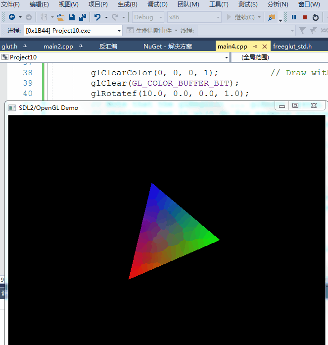

楼主 #5 2021-01-06 17:23:49
拉轰的脚踏车
注册时间: 2020-03-20
已发帖子: 288
积分: 222
https://github.com/crust/sdl2-examples/blob/master/glcontext.cpp
#include <iostream>
#include <SDL.h>
using std::cout;
int main(int argc, char* argv[]) {
	SDL_Init(SDL_INIT_VIDEO); // Init SDL2
	// Create a window. Window mode MUST include SDL_WINDOW_OPENGL for use with OpenGL.
	SDL_Window *window = SDL_CreateWindow(
		"SDL2/OpenGL Demo", SDL_WINDOWPOS_UNDEFINED, SDL_WINDOWPOS_UNDEFINED, 640, 480, SDL_WINDOW_OPENGL | SDL_WINDOW_RESIZABLE
	// Create an OpenGL context associated with the window.
	SDL_GLContext glcontext = SDL_GL_CreateContext(window);
	// Now, regular OpenGL functions ...
	glMatrixMode(GL_PROJECTION | GL_MODELVIEW);
	glLoadIdentity();
	glOrtho(-320, 320, 240, -240, 0, 1);
	// ... can be used alongside SDL2.
	SDL_Event e;
	float x = 0.0, y = 30.0;
	SDL_PollEvent(&e);
	while (e.type != SDL_KEYDOWN && e.type != SDL_QUIT) {  // Enter main loop.
		SDL_PollEvent(&e);      // Check for events.
		glClearColor(0, 0, 0, 1);          // Draw with OpenGL.
		glRotatef(10.0, 0.0, 0.0, 1.0);
		// Note that the glBegin() ... glEnd() OpenGL style used below is actually
		// obsolete, but it will do for example purposes. For more information, see
		// SDL_GL_GetProcAddress() or find an OpenGL extension loading library.
		glBegin(GL_TRIANGLES);
		glColor3f(1.0, 0.0, 0.0); glVertex2f(x, y + 90.0);
		glColor3f(0.0, 1.0, 0.0); glVertex2f(x + 90.0, y - 90.0);
		glColor3f(0.0, 0.0, 1.0); glVertex2f(x - 90.0, y - 90.0);
		glEnd();
		SDL_GL_SwapWindow(window);  // Swap the window/buffer to display the result.
		SDL_Delay(100);              // Pause briefly before moving on to the next cycle.
	// Once finished with OpenGL functions, the SDL_GLContext can be deleted.
	SDL_GL_DeleteContext(glcontext);
	// Done! Close the window, clean-up and exit the program.
	SDL_DestroyWindow(window);
	SDL_Quit();
