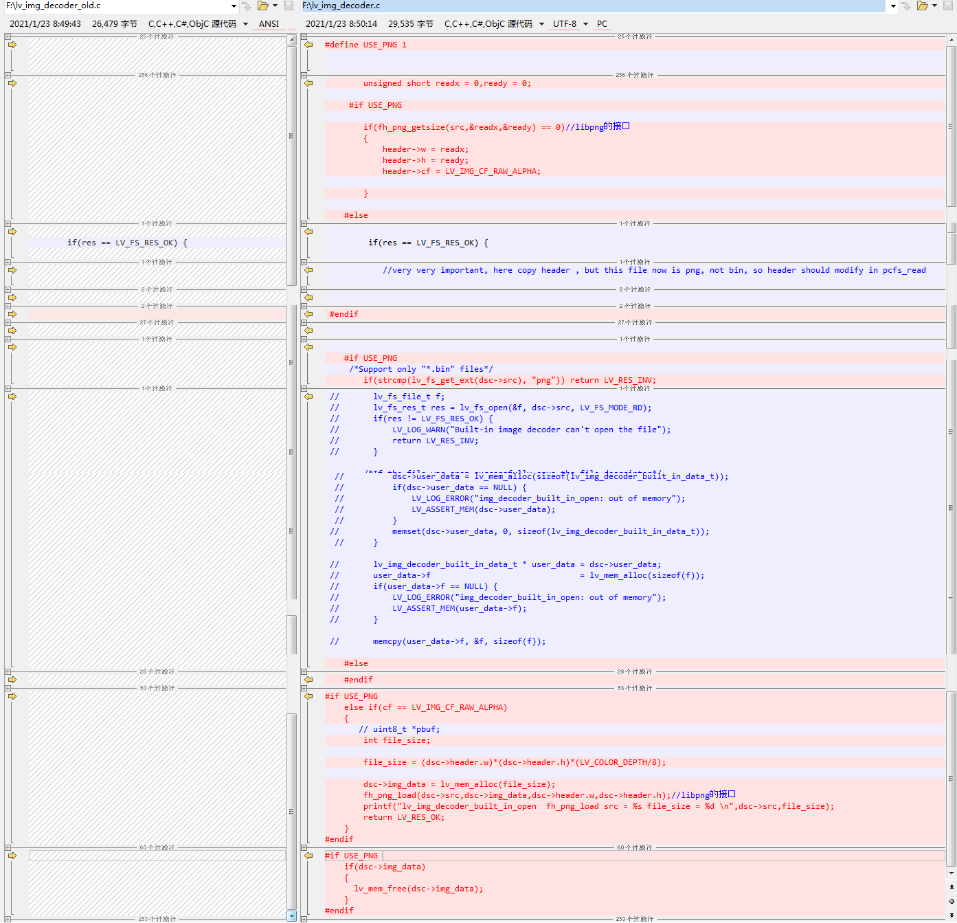

LVGL6.0的linux_frame_buffer项目支持PNG解码
下载下来的linux_frame_buffer 跑在V3S tina
跑起来没有支持png解码,图片啥的程序从单片机那边过来,都是bin啊啥的,ARGB8888 数据超大还占磁盘,很难受啊。
tina环境已经支持了libpng,这里边默认是调用了libpng里边的接口。
话不多说,上代码:

    else if(src_type == LV_IMG_SRC_FILE) {
        lv_fs_file_t file;
        lv_fs_res_t res;
        uint32_t rn;
        unsigned short readx = 0,ready = 0;
     #if USE_PNG
        if(fh_png_getsize(src,&readx,&ready) == 0)//libpng的接口
            header->w = readx;
            header->h = ready;
            header->cf = LV_IMG_CF_RAW_ALPHA;
    #else
        res = lv_fs_open(&file, src, LV_FS_MODE_RD);
         if(res == LV_FS_RES_OK) {
            res = lv_fs_read(&file, header, sizeof(lv_img_header_t), &rn);
            //very very important, here copy header , but this file now is png, not bin, so header should modify in pcfs_read
            lv_fs_close(&file);
        if(header->cf < CF_BUILT_IN_FIRST || header->cf > CF_BUILT_IN_LAST) return LV_RES_INV;

lv_res_t lv_img_decoder_built_in_open(lv_img_decoder_t * decoder, lv_img_decoder_dsc_t * dsc)
    /*Open the file if it's a file*/
    if(dsc->src_type == LV_IMG_SRC_FILE) {
#if LV_USE_FILESYSTEM
    #if USE_PNG
     /*Support only "*.bin" files*/
        if(strcmp(lv_fs_get_ext(dsc->src), "png")) return LV_RES_INV;
 //       lv_fs_file_t f;
 //       lv_fs_res_t res = lv_fs_open(&f, dsc->src, LV_FS_MODE_RD);
 //       if(res != LV_FS_RES_OK) {
 //           LV_LOG_WARN("Built-in image decoder can't open the file");
 //           return LV_RES_INV;
        /*If the file was open successfully save the file descriptor*/
  //      if(dsc->user_data == NULL) {
  //          dsc->user_data = lv_mem_alloc(sizeof(lv_img_decoder_built_in_data_t));
  //              LV_LOG_ERROR("img_decoder_built_in_open: out of memory");
  //              LV_ASSERT_MEM(dsc->user_data);
 //           memset(dsc->user_data, 0, sizeof(lv_img_decoder_built_in_data_t));
 //       lv_img_decoder_built_in_data_t * user_data = dsc->user_data;
 //       user_data->f                               = lv_mem_alloc(sizeof(f));
 //       if(user_data->f == NULL) {
 //           LV_ASSERT_MEM(user_data->f);
 //       memcpy(user_data->f, &f, sizeof(f));
    #else
        if(strcmp(lv_fs_get_ext(dsc->src), "bin")) return LV_RES_INV;
        lv_fs_file_t f;
            return LV_RES_INV;
#else
        LV_LOG_WARN("Image built-in decoder cannot read file because LV_USE_FILESYSTEM = 0");
        return LV_RES_INV;
    lv_img_cf_t cf = dsc->header.cf;
    /*Process true color formats*/
    if(cf == LV_IMG_CF_TRUE_COLOR || cf == LV_IMG_CF_TRUE_COLOR_ALPHA || cf == LV_IMG_CF_TRUE_COLOR_CHROMA_KEYED) {
        if(dsc->src_type == LV_IMG_SRC_VARIABLE) {
            /* In case of uncompressed formats the image stored in the ROM/RAM.
             * So simply give its pointer*/
            dsc->img_data = ((lv_img_dsc_t *)dsc->src)->data;
            return LV_RES_OK;
        } else {
            /*If it's a file it need to be read line by line later*/
            dsc->img_data = NULL;
            return LV_RES_OK;
    /*Process indexed images. Build a palette*/
    else if(cf == LV_IMG_CF_INDEXED_1BIT || cf == LV_IMG_CF_INDEXED_2BIT || cf == LV_IMG_CF_INDEXED_4BIT ||
            cf == LV_IMG_CF_INDEXED_8BIT) {
#if LV_IMG_CF_INDEXED
        uint8_t px_size       = lv_img_color_format_get_px_size(cf);
        uint32_t palette_size = 1 << px_size;
        /*Allocate the palette*/
        user_data->palette                         = lv_mem_alloc(palette_size * sizeof(lv_color_t));
        user_data->opa                             = lv_mem_alloc(palette_size * sizeof(lv_opa_t));
        if(user_data->palette == NULL || user_data->opa == NULL) {
            LV_ASSERT_MEM(user_data->palette);
            LV_ASSERT_MEM(user_data->opa);
            /*Read the palette from file*/
            lv_fs_seek(user_data->f, 4); /*Skip the header*/
            lv_color32_t cur_color;
            uint32_t i;
            for(i = 0; i < palette_size; i++) {
                lv_fs_read(user_data->f, &cur_color, sizeof(lv_color32_t), NULL);
                user_data->palette[i] = lv_color_make(cur_color.ch.red, cur_color.ch.green, cur_color.ch.blue);
                user_data->opa[i]     = cur_color.ch.alpha;
#else
            LV_LOG_WARN("Image built-in decoder can read the palette because LV_USE_FILESYSTEM = 0");
            return LV_RES_INV;
        } else {
            /*The palette begins in the beginning of the image data. Just point to it.*/
            lv_color32_t * palette_p = (lv_color32_t *)((lv_img_dsc_t *)dsc->src)->data;
            uint32_t i;
                user_data->palette[i] = lv_color_make(palette_p[i].ch.red, palette_p[i].ch.green, palette_p[i].ch.blue);
                user_data->opa[i]     = palette_p[i].ch.alpha;
        return LV_RES_OK;
#else
        LV_LOG_WARN("Indexed (palette) images are not enabled in lv_conf.h. See LV_IMG_CF_INDEXED");
        return LV_RES_INV;
    /*Alpha indexed images. */
    else if(cf == LV_IMG_CF_ALPHA_1BIT || cf == LV_IMG_CF_ALPHA_2BIT || cf == LV_IMG_CF_ALPHA_4BIT ||
            cf == LV_IMG_CF_ALPHA_8BIT) {
#if LV_IMG_CF_ALPHA
        return LV_RES_OK; /*Nothing to process*/
#else
        LV_LOG_WARN("Alpha indexed images are not enabled in lv_conf.h. See LV_IMG_CF_ALPHA");
        return LV_RES_INV;
#if USE_PNG
    else if(cf == LV_IMG_CF_RAW_ALPHA)
       // uint8_t *pbuf;
        int file_size;
        file_size = (dsc->header.w)*(dsc->header.h)*(LV_COLOR_DEPTH/8);
        dsc->img_data = lv_mem_alloc(file_size);
        fh_png_load(dsc->src,dsc->img_data,dsc->header.w,dsc->header.h);//libpng的接口
        printf("lv_img_decoder_built_in_open  fh_png_load src = %s file_size = %d \n",dsc->src,file_size);
		return LV_RES_OK;
    /*Unknown format. Can't decode it.*/
    else {
        /*Free the potentially allocated memories*/
        lv_img_decoder_built_in_close(decoder, dsc);
        LV_LOG_WARN("Image decoder open: unknown color format")
        return LV_RES_INV;

#if USE_PNG
    if(dsc->img_data)
      lv_mem_free(dsc->img_data);

注意看一下宏定义USE_PNG 下添加的代码,其实添加的东西很少。
主要3个处理:
1、返回图像的大小和类型
2、读取PNG的元数据(直接解出来后的)
3、关闭解码器的时候释放掉解出来的时候申请的内存

牛, 向楼主学习! Makefile 也要修改一下对吧?

这个一定要改的,不改就没拿到png的库接口
这个其实也挺好摸索的,lvgl的参考手册写得很清楚,就改这个文件

https://raw.githubusercontent.com/lvgl/lvgl/release/v6/src/lv_draw/lv_img_decoder.c
楼主干得漂亮, 顺便用beyond compare 对比了一下。
