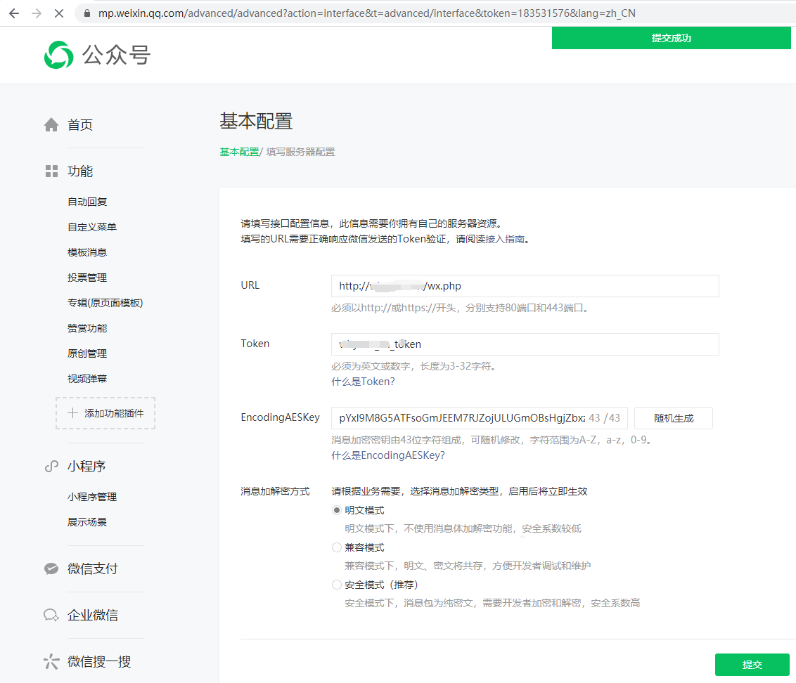

跟上时代,记录一下刚刚看视频学会的 php + 微信公众号开发
只要一点 [提交], 看网页服务器就会出现log记录 cat /var/log/apache2/access.log:
127.0.0.1 - - [29/Aug/2020:23:07:57 -0700] "GET /wx.php?signature=1f4142af46fa98cd30b5a57d3e6b8b14f01ea78f&echostr=7204982403406724733&timestamp=1598767677&nonce=1224769556 HTTP/1.1" 404 452 "-" "Mozilla/4.0"
127.0.0.1 - - [29/Aug/2020:23:09:29 -0700] "GET /wx.php?signature=66b48d050fdfee446a4ad94b489fb176ba86d402&echostr=8184609992026876859&timestamp=1598767769&nonce=1984465893 HTTP/1.1" 404 452 "-" "Mozilla/4.0"
127.0.0.1 - - [29/Aug/2020:23:09:36 -0700] "GET /wx.php HTTP/1.1" 404 452 "-" "Mozilla/5.0 (Windows NT 10.0; Win64; x64) AppleWebKit/537.36 (KHTML, like Gecko) Chrome/79.0.3945.130 Safari/537.36"
127.0.0.1 - - [29/Aug/2020:23:11:59 -0700] "GET /wx.php HTTP/1.1" 200 167 "-" "Mozilla/5.0 (Windows NT 10.0; Win64; x64) AppleWebKit/537.36 (KHTML, like Gecko) Chrome/79.0.3945.130 Safari/537.36"
127.0.0.1 - - [29/Aug/2020:23:12:15 -0700] "GET /wx.php?signature=918f4a236bcfd5f8f2b25369b85050411dda08a2&echostr=525327352018754495&timestamp=1598767935&nonce=813200003 HTTP/1.1" 200 186 "-" "Mozilla/4.0"
127.0.0.1 - - [29/Aug/2020:23:20:45 -0700] "GET /wx.php HTTP/1.1" 200 167 "-" "Mozilla/5.0 (iPhone; CPU iPhone OS 10_2_1 like Mac OS X) AppleWebKit/602.4.6 (KHTML, like Gecko) Mobile/14D27 MicroMessenger/6.5.5 NetType/WIFI Language/zh_CN"
127.0.0.1 - - [29/Aug/2020:23:25:23 -0700] "GET /wx.php?signature=7aa15240c3f687e0ab49b1934ad983652623ee7e&echostr=4353787308509460447&timestamp=1598768723&nonce=473211795 HTTP/1.1" 200 187 "-" "Mozilla/4.0"
只要新建 wx.php, 返回 echostr 即可:
<?php
        echo $_GET["echostr"];
这样就会显示右上角 提交成功

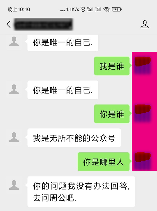

看视频学来的 $GLOBALS[‘HTTP_RAW_POST_DATA’],
结果在我的网页服务器死活不显示,
一开始因为我输错了, 检查100遍之后, 发现还是没错.
网上一搜, 原来这个数组在php7已经不适应了,
新的接口是: $data = file_get_contents('php://input');
楼主 #5 2020-08-30 22:08:28
迷茫的微信开发加班狗
注册时间: 2020-08-30
Re: 跟上时代,记录一下刚刚看视频学会的 php + 微信公众号开发
cat wx1.php
<?php
function wx_log($log_msg)
        $log_filename = $_SERVER['DOCUMENT_ROOT']."/logs";
        if (!file_exists($log_filename))
                // create directory/folder uploads.
                mkdir($log_filename, 0777, true);
        $log_file_data = $log_filename.'/' . date('Y-m-d') . '.log';
        file_put_contents($log_file_data, $log_msg, FILE_APPEND);
        file_put_contents($log_file_data, "\n", FILE_APPEND);
define(TOKEN, "my_token");
if(empty($data))
        //wx_log($GLOBALS['HTTP_RAW_POST_DATA']);
        wx_log('sign: ' . $_GET['signature']);
        wx_log($_GET['echostr']);
        wx_log($_GET['timestamp']);
        wx_log($_GET['nonce']);
        $signature = $_GET['signature'];//签名
        $echostr = $_GET['echostr'];
        $timestamp = $_GET['timestamp'];//时间戳
        $nonce = $_GET['nonce'];//随机数
        $arr = [$timestamp, $nonce, TOKEN];
        sort($arr, SORT_STRING);
        $str = sha1(implode($arr));//重新计算签名
        wx_log($str);
        if(($str == $signature) && ($str != ""))//如果签名吻合,那么给微信服务器回推消息
                echo $echostr;
else
        wx_log($data);
        $obj = simplexml_load_string($data, 'SimpleXMLElement', LIBXML_NOCDATA);
        wx_log('ToUserName:' . $obj->ToUserName);
        wx_log('FromUserName:' . $obj->FromUserName);
        wx_log('CreateTime:' . $obj->CreateTime);
        wx_log('MsgType:' . $obj->MsgType);
        wx_log('Content:' . $obj->Content);
        $ToUserName = $obj->ToUserName;
        $FromUserName = $obj->FromUserName;
        $MessageContent = $obj->Content;
        $xml_template = '<xml><ToUserName><![CDATA[%s]]></ToUserName>
                <FromUserName><![CDATA[%s]]></FromUserName>
                <CreateTime>%s</CreateTime>
                <MsgType><![CDATA[%s]]></MsgType>
                <Content><![CDATA[%s]]></Content>
                </xml>';
        if($MessageContent == '我是谁')
                $xml_send = sprintf($xml_template, $FromUserName, $ToUserName, time(), 'text', '你是唯一的自己.');
        else if($MessageContent == '你是谁')
                $xml_send = sprintf($xml_template, $FromUserName, $ToUserName, time(), 'text', '我是无所不能的公众号');
        else
                $xml_send = sprintf($xml_template, $FromUserName, $ToUserName, time(), 'text', '你的问题我没有办法回答,去问周公吧.');
        echo $xml_send;
        exit;
这是一天的工作成果.

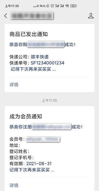

服务器推送交互式消息有时间限制的,只有用户发了一条信息给公众号(2小时内??),服务器才可以给微信推送消息。
服务器推送随时可以推送模板消息,但是模板只能从微信库里面选,很可能找不到合适的模板。
楼主 #8 2020-08-31 11:42:52
迷茫的微信开发加班狗
注册时间: 2020-08-30
楼上两位说得对, 刚刚搞定了模板消息
代码全部是这个: https://www.jianshu.com/p/2ac8cba649a4
$ACCESS_TOKEN = '';//通过微信获取access_token接口 获取的token
$openid = '';//用户openid
$template_id = '';//配置的模板id
$url = '';//点击模板消息跳转的链接
$template = array(
    'touser' => $openid,
    'template_id' => $template_id,
    'url' => $url,
    'data' => array(
        'first' => array('value' => '恭喜你购买成功!', 'color' => "#173177"),
        'keyword1' => array('value' => '巧克力', 'color' => '#173177'),
        'keyword2' => array('value' => '39.8元', 'color' => '#173177'),
        'keyword3' => array('value' => '2014年9月22日', 'color' => '#173177'),
        'remark' => array('value' => '欢迎再次购买!', 'color' => '#173177'),)
$send_template_url = 'https://api.weixin.qq.com/cgi-bin/message/template/send?access_token=' . $ACCESS_TOKEN;
$ch = curl_init();
curl_setopt($ch, CURLOPT_URL, $send_template_url);
curl_setopt($ch, CURLOPT_HEADER, 0);
curl_setopt($ch, CURLOPT_RETURNTRANSFER, 1);
curl_setopt($ch, CURLOPT_POST, 1);
curl_setopt($ch, CURLOPT_POSTFIELDS, json_encode($template));
curl_setopt($ch, CURLOPT_SSL_VERIFYHOST, 2);
curl_setopt($ch, CURLOPT_SSL_VERIFYPEER, false);
$res = curl_exec($ch);
curl_close($ch);
return $res;
只改了配置, 就能给关注的微信号主动推送模板消息了。
