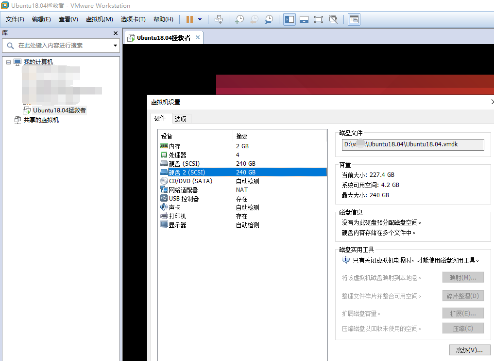

VMWare Ubuntu18.04 终于起不动了, 悲剧
怎么折腾都是这样

怎么重启, 上面的进度都是纹丝不动.

好险, 居然搞定了.
新装一个Ubuntu18.04虚拟机,然后添加一个新硬盘(从上面那个不能启动的系统导入),
然后启动后居然自动把这个不能启动的硬盘自动挂载成根文件系统了.
好神奇, 几乎什么都不用做.

不是把 /dev/sda (第一个硬盘)挂载成 rootfs
而是把 /dev/sdb (第二个硬盘)挂载成 rootfs
理论上要 fsck.ext4 /dev/sdb 修复之后才能挂载吧?

[    2.831773] sd 32:0:1:0: [sdb] 503316480 512-byte logical blocks: (258 GB/240 GiB)
[    2.831820] sd 32:0:1:0: [sdb] Write Protect is off
[    2.831821] sd 32:0:1:0: [sdb] Mode Sense: 61 00 00 00
[    2.832024] sd 32:0:1:0: [sdb] Cache data unavailable
[    2.832025] sd 32:0:1:0: [sdb] Assuming drive cache: write through
[    2.832093] sd 32:0:1:0: Attached scsi generic sg2 type 0
[    2.835537]  sda: sda1
[    2.835779]  sdb: sdb1
[    2.836148] sd 32:0:0:0: [sda] Attached SCSI disk
[    2.836248] sd 32:0:1:0: [sdb] Attached SCSI disk
[    2.852714] random: fast init done
[    2.864260] random: systemd-udevd: uninitialized urandom read (16 bytes read)
[    2.864269] random: systemd-udevd: uninitialized urandom read (16 bytes read)
[    2.864584] random: systemd-udevd: uninitialized urandom read (16 bytes read)
[    2.935482] EXT4-fs (sdb1): mounted filesystem with ordered data mode. Opts: (null)
[    3.072184] usb 2-2.1: new full-speed USB device number 4 using uhci_hcd
[    3.190342] usb 2-2.1: New USB device found, idVendor=0e0f, idProduct=0008, bcdDevice= 1.00
[    3.190343] usb 2-2.1: New USB device strings: Mfr=1, Product=2, SerialNumber=3
[    3.190344] usb 2-2.1: Product: Virtual Bluetooth Adapter
[    3.190345] usb 2-2.1: Manufacturer: VMware
[    3.190346] usb 2-2.1: SerialNumber: 000650268328
[    3.200745] systemd[1]: Failed to insert module 'autofs4': No such file or directory
[    3.219243] systemd[1]: systemd 237 running in system mode. (+PAM +AUDIT +SELINUX +IMA +APPARMOR +SMACK +SYSVINIT +UTMP +LIBCRYPTSETUP +GCRYPT +GNUTLS +ACL +XZ +LZ4 +SECCOMP +BLKID +ELFUTILS +KMOD -IDN2 +IDN -PCRE2 default-hierarchy=hybrid)
[    3.219262] systemd[1]: Detected virtualization vmware.
[    3.219296] systemd[1]: Detected architecture x86-64.
[    3.231347] systemd[1]: Set hostname to <Test.com>.
[    3.505045] systemd[1]: Configuration file /etc/systemd/system/runsunloginclient.service is marked executable. Please remove executable permission bits. Proceeding anyway.
[    3.551609] systemd[1]: Created slice System Slice.
[    3.551711] systemd[1]: Created slice User and Session Slice.
[    3.551751] systemd[1]: Listening on fsck to fsckd communication Socket.
[    3.551784] systemd[1]: Listening on /dev/initctl Compatibility Named Pipe.
[    3.551791] systemd[1]: Reached target Slices.
[    3.596580] EXT4-fs (sdb1): re-mounted. Opts: errors=remount-ro
[    3.692530] Adding 2097148k swap on /swapfile.  Priority:-2 extents:6 across:2260988k FS
[    4.033357] systemd-journald[348]: Received request to flush runtime journal from PID 1
[    4.218252] audit: type=1400 audit(1587568097.758:2): apparmor="STATUS" operation="profile_load" profile="unconfined" name="/usr/lib/lightdm/lightdm-guest-session" pid=478 comm="apparmor_parser"
[    4.218254] audit: type=1400 audit(1587568097.758:3): apparmor="STATUS" operation="profile_load" profile="unconfined" name="/usr/lib/lightdm/lightdm-guest-session//chromium" pid=478 comm="apparmor_parser"
[    4.232428] audit: type=1400 audit(1587568097.774:4): apparmor="STATUS" operation="profile_load" profile="unconfined" name="/sbin/dhclient" pid=479 comm="apparmor_parser"
[    4.232431] audit: type=1400 audit(1587568097.774:5): apparmor="STATUS" operation="profile_load" profile="unconfined" name="/usr/lib/NetworkManager/nm-dhcp-client.action" pid=479 comm="apparmor_parser"
[    4.232432] audit: type=1400 audit(1587568097.774:6): apparmor="STATUS" operation="profile_load" profile="unconfined" name="/usr/lib/NetworkManager/nm-dhcp-helper" pid=479 comm="apparmor_parser"
[    4.232433] audit: type=1400 audit(1587568097.774:7): apparmor="STATUS" operation="profile_load" profile="unconfined" name="/usr/lib/connman/scripts/dhclient-script" pid=479 comm="apparmor_parser"
[    4.271109] audit: type=1400 audit(1587568097.810:8): apparmor="STATUS" operation="profile_load" profile="unconfined" name="/usr/bin/evince" pid=480 comm="apparmor_parser"
[    4.271111] audit: type=1400 audit(1587568097.810:9): apparmor="STATUS" operation="profile_load" profile="unconfined" name="/usr/bin/evince//sanitized_helper" pid=480 comm="apparmor_parser"
[    4.271112] audit: type=1400 audit(1587568097.810:10): apparmor="STATUS" operation="profile_load" profile="unconfined" name="/usr/bin/evince-previewer" pid=480 comm="apparmor_parser"
[    4.953911] random: crng init done
[    4.953912] random: 7 urandom warning(s) missed due to ratelimiting
[    6.663286] IPv6: ADDRCONF(NETDEV_UP): ens33: link is not ready
[    6.668567] IPv6: ADDRCONF(NETDEV_UP): ens33: link is not ready
[    6.672082] e1000: ens33 NIC Link is Up 1000 Mbps Full Duplex, Flow Control: None
[    6.672924] IPv6: ADDRCONF(NETDEV_CHANGE): ens33: link becomes ready
[   16.346882] rfkill: input handler disabled
想了一个晚上, 我还是没想明白, 为什么会直接把第二个硬盘挂载成 rootfs 呢?
还有挂载的时候为什么没有提示要修复磁盘呢?
上面是log, 还望路过的大神指点。
重点怀疑对象:
